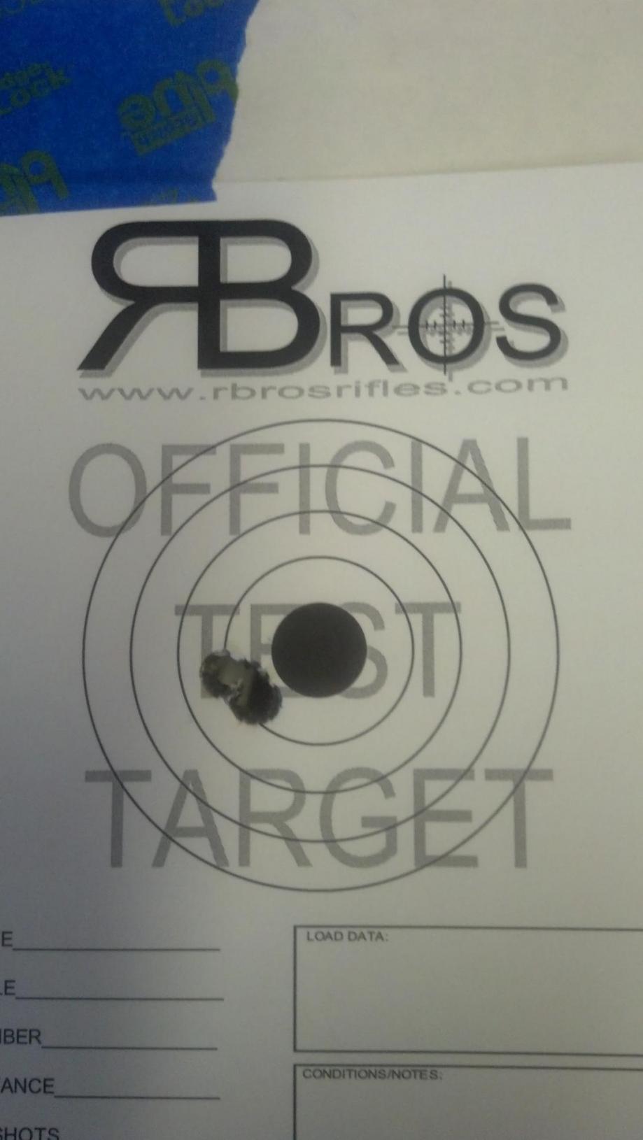

I use Retumbo in my 7 mag with excellents results shooting the Berger 180 VLD's in my RBros rifle at 3056 fps
