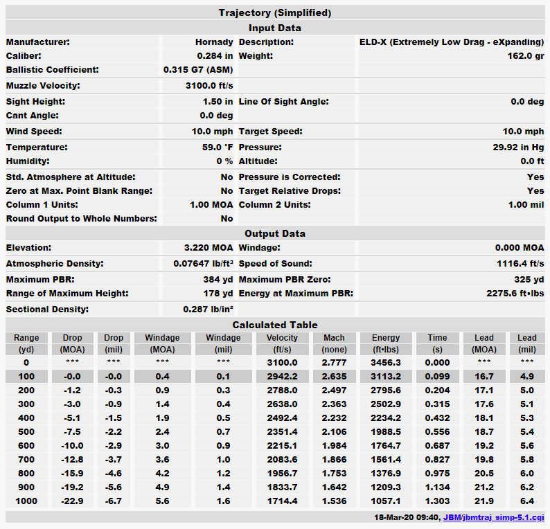

I was researching into Barnes TTSX 120 Grain bullets for long range because you can load them to 3400 FPS and they have a decently high BC, but recently I stumbled across 162 grain ELD-X loads that have an amazing BC and are factory loaded at 2940 FPS, but I checked my reloading book and you can load them up to 3045 FPS with IMR 4350 powder.
Which one of these two options would be good for long range shooting up to about 800 yards?
The 120 is flatter elevation-wise over the 162 until 600 yards at which point the 162 carries its momentum better further out.
But the wind... the 120 takes 3 moa of at 400 yards where at the 162 can go to 600 for a matching wind call. At 800 yards the 162 is only 4.2 moa vs 7.4 moa for the 120, thats only 60% of the wind call required.
So for long range the 162 is going to make it much more forgiving to actually use with any wind (which there always is). You can adjust your scope for elevation, once thats known its easily compensated for. Its the wind that will get you.
