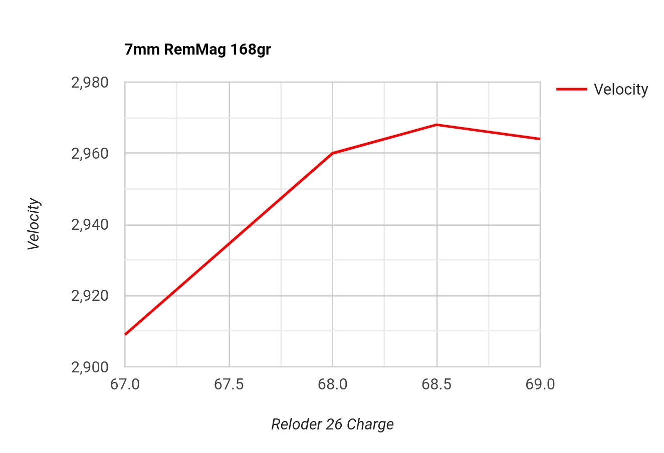

    I used the latest and greatest Sierra Manual because it actually has reasonably comprehensive Reloder 26 data for 7mm RemMag. I loaded 1 cartridge with 67, 68, 68.5, and 69 grains just to see who was who in the zoo. Per the manual, 67 was supposed to get about 2880 and 69.1 (book max) was to get about 2960. We shall see... TO THE RANGE!

    Shot 1, 67gr: 2909
    Shot 2, 68gr: 2960
    Shot 3, 68.5gr: 2968
    Shot 4, 69gr: 2964
    All casings extracted easily, primers looked good (maybe a little bit of flattening, but nothing out of the norm for everything fired from this rifle, factory or reload), no ejector marks on the case head. I am really happy to see that flat velocity between 68 and 69 grains. It was very close to what the manual said it would be, and what I set out to do with this powder. So, I'm happy and excited to see how this powder will serve my needs.

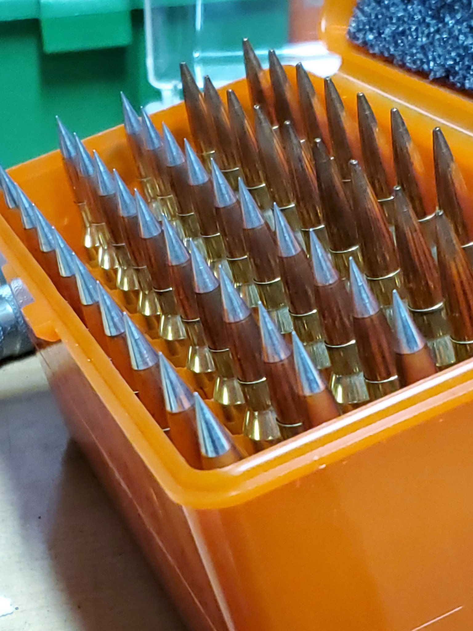

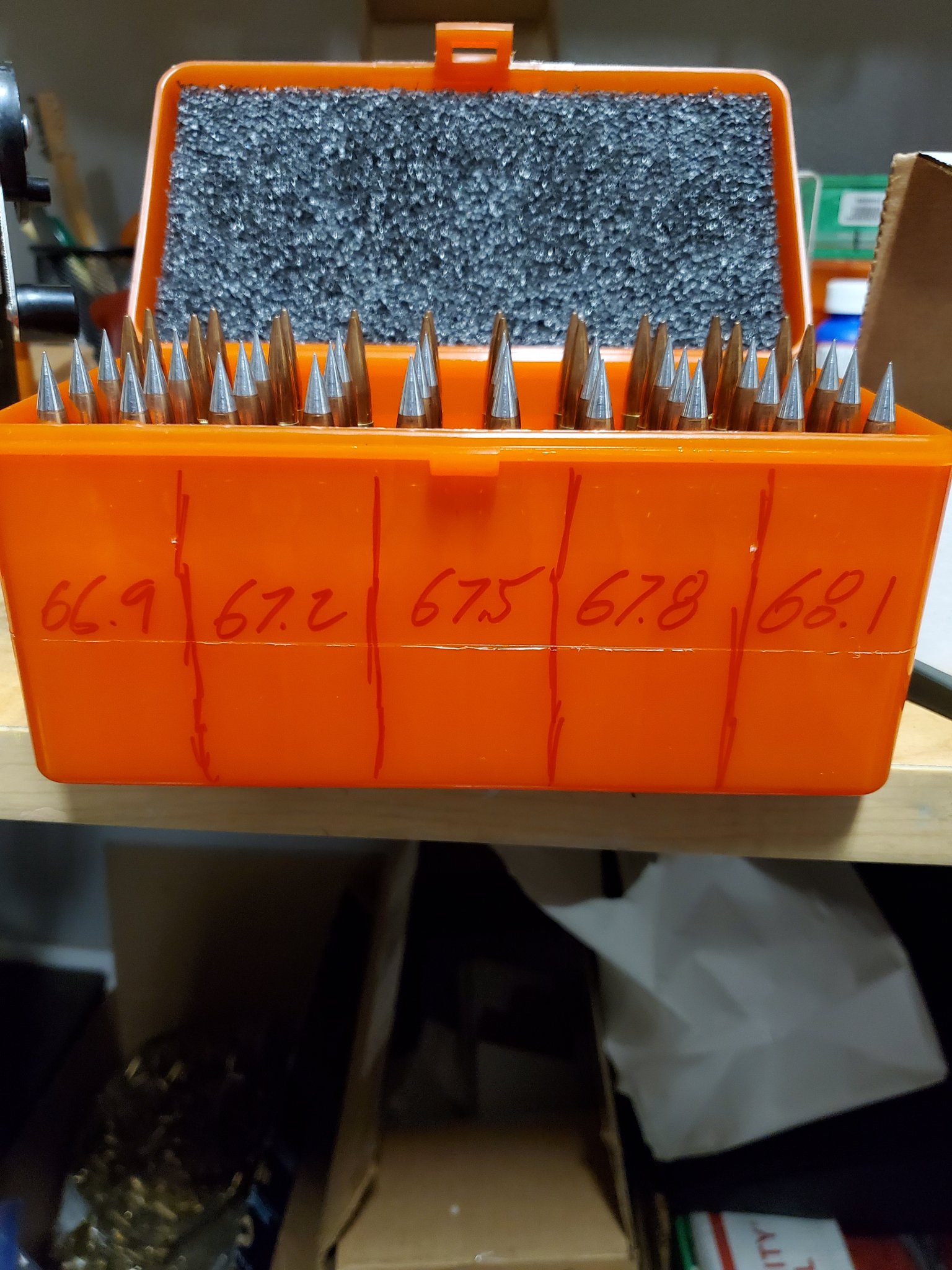

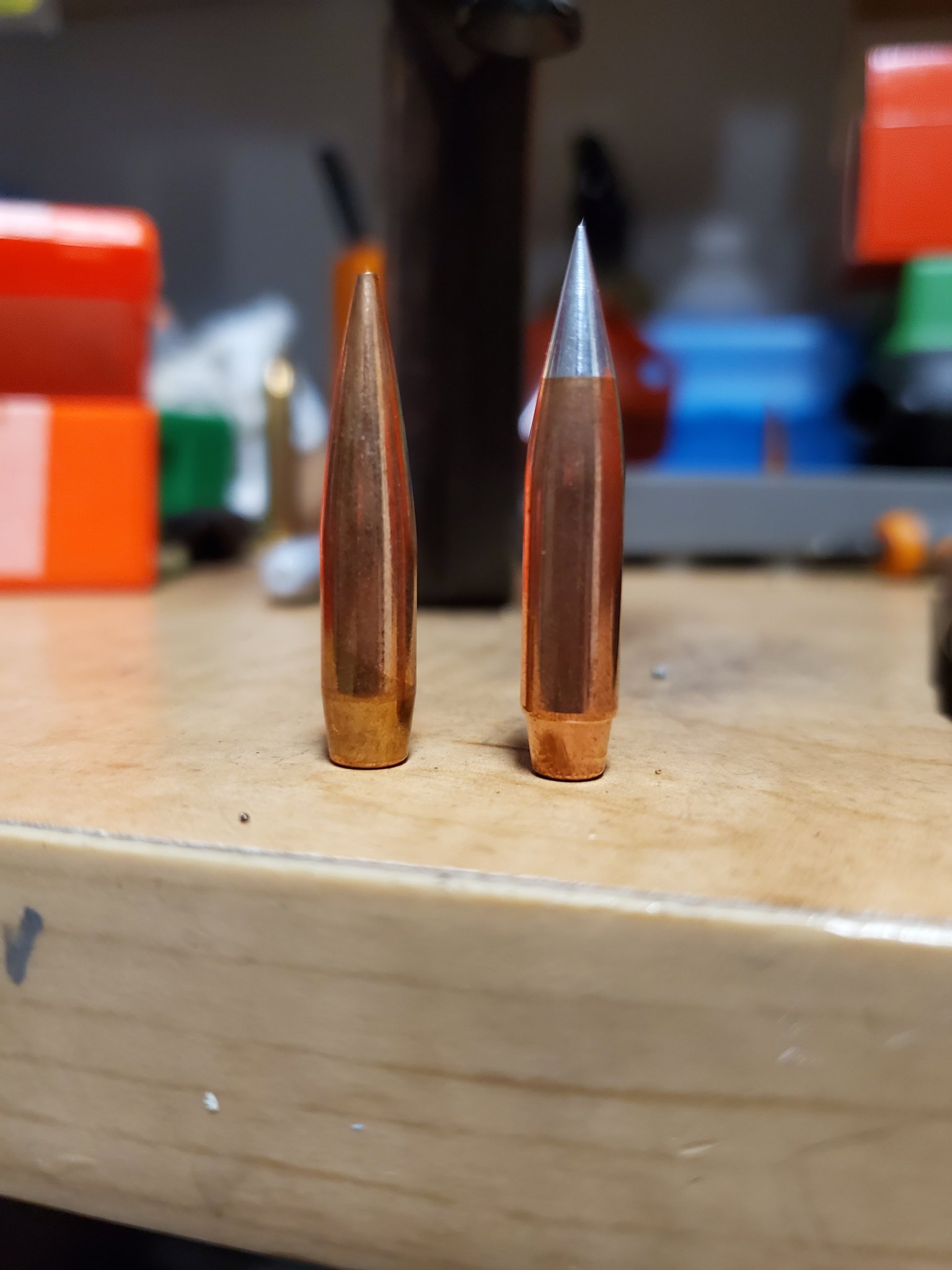

    Fireformed, neck sized only ADG Brass with Berger 168 VLD and 168 Alco ULD's are on the menu this weekend.... more info to follow.... specifiically with the ULD going to do .3gr steps from 66.9 to 68.1 grains. 3 with magnetospeed attached, 3 without. ADG brass is 10 grains heavier than my RP brass, so I'm reducing charge by 1 grain. I have a running theory that 10 grains difference in the same brass equates to a 1 grain charge weight difference. We'll see if it trends....

    Is the G1 panning out on those Alco bullets?
    Their 180’ advertise a .860 G1!
