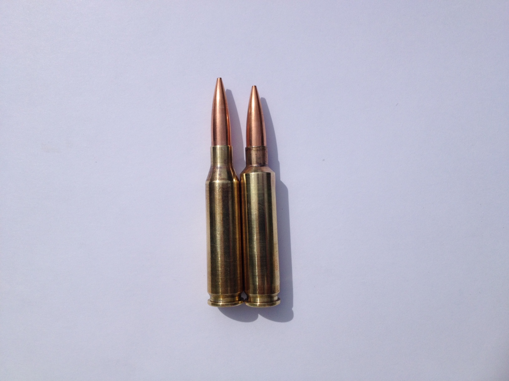

I am shooting a 260Ai using 123 smk's with a velocity of 3,000+ from a 27" Shilen barrel. Using 260 Lapua brass, the shell on the left in the photo is a 260 ready for fire forming, and you can see the OAL is much longer the form Ackley shell on the right.
I really like the AI version of this cartridge and think it really shines this way. Good luck to the OP, and have fun with whatever you decide.
How do the Ackley's feed from a magazine? Is that sharper shoulder an issue?
My barrel has 2700+ rounds through it, and still shoots very good.
Sorry if this was posted elsewhere, but do you care to share the details?
Barrel Details - Manufacturer, Material, Finish, Anything Special, etc?
Load Details - Case, Powder, Bullet, etc?
Performance and numbers like that are amazing, but I am sure that the Devil is in the details?
