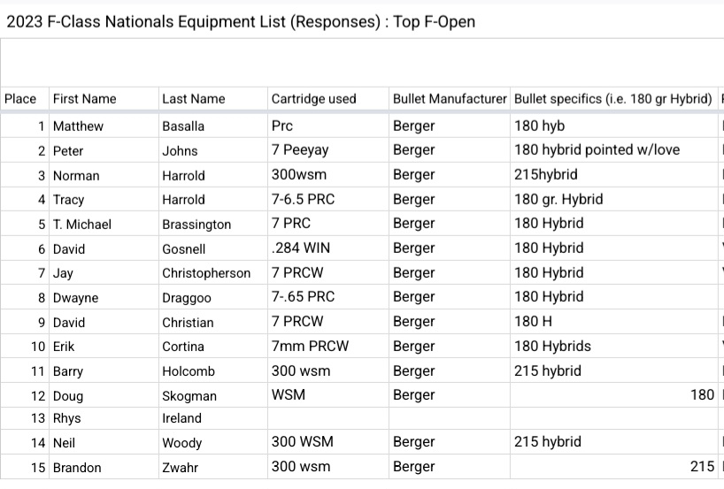

    The 7-6.5PRC seems like a replacement for .284 Win for F-Class. No .284 Lapua brass, but plenty of Lapua 6.5 PRC. It doesn't seem like a replacement for the SAUM.
    Why do you say that?
    People who were shooting .284 with 180 Hybrids in F-Class now shoot 180 Hybrids in a 7-6.5 PRC. It fits a niche cartridge size/powder capacity. I don't think it has anything to do with being better than the SAUM, or even competing with it.
    F-class barrels seem to be getting about 1500 rounds of match level accuracy out of the 7-6.5 prc (these are fairly long and hot strings of fire). The saums are shot out well before then. If you're shooting a few hundred rounds per month, there's an advantage there. If you're gonna do a couple hundred rounds a year, won't matter much.
