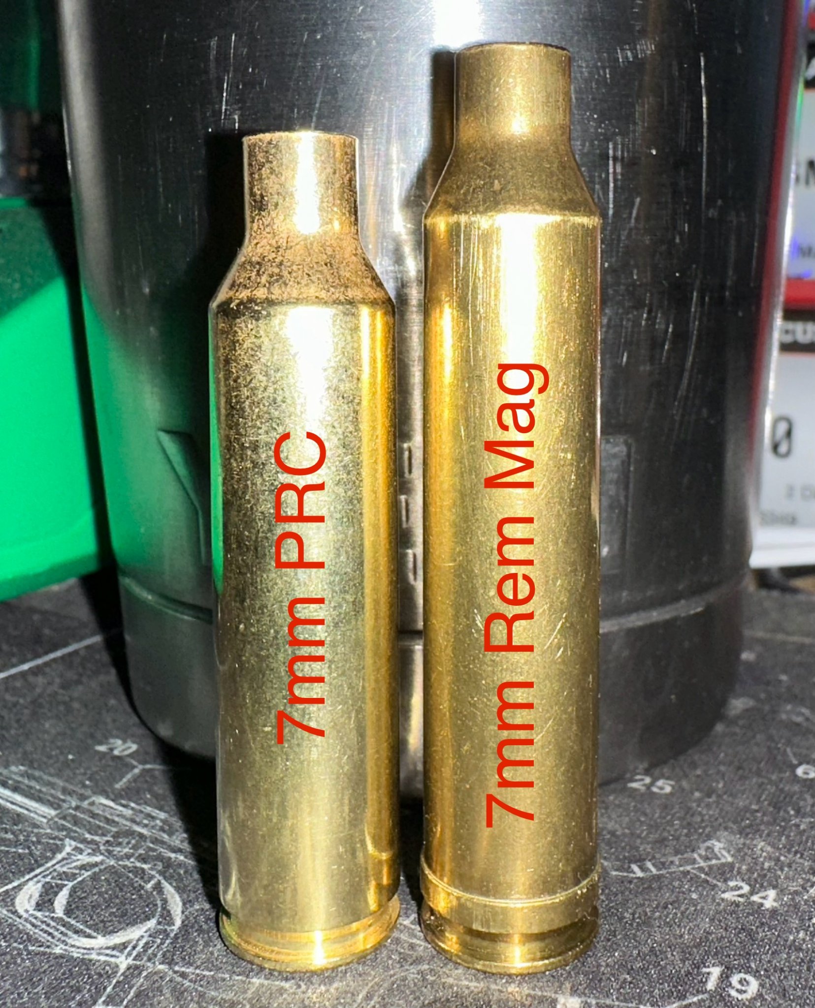

Although the cases are very similar, they are both completely different cartridges! 7 Mag was designed to shoot 140-160 grain bullets and thats why all the factory rifles are build with 9 or 10 twist barrels. All of the 7 PRC options are 8 twists and made for 175-190 grain bullets. Its a whole different beast designed around modern bullets. This is the same debate as the 300 WM vs 300 PRC. Both the 7 and 30s are very similar in cartridge design but they throat it out, add in a 1.5 degree lead and give the correct twist for the heavy high BC bullets!

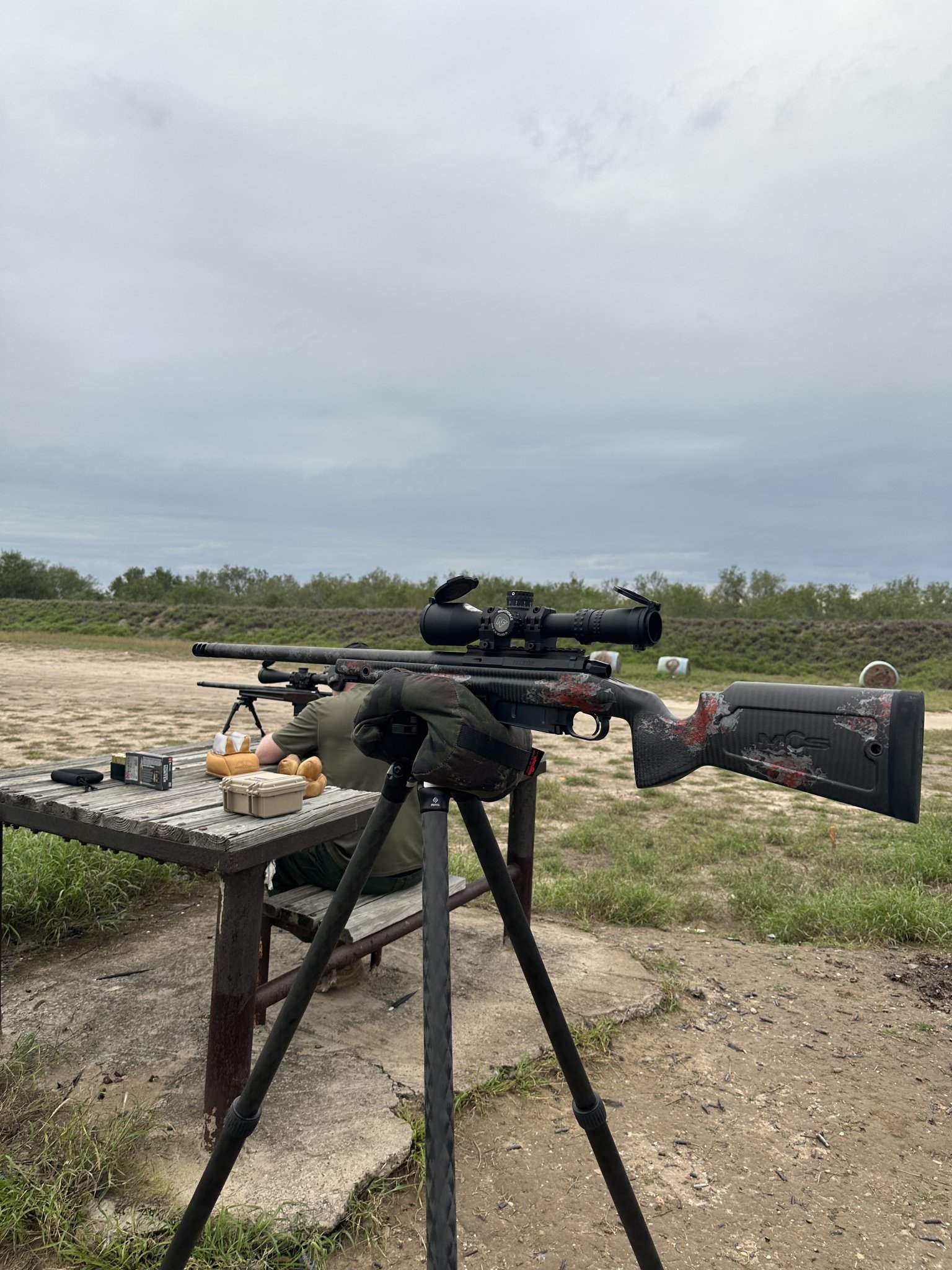

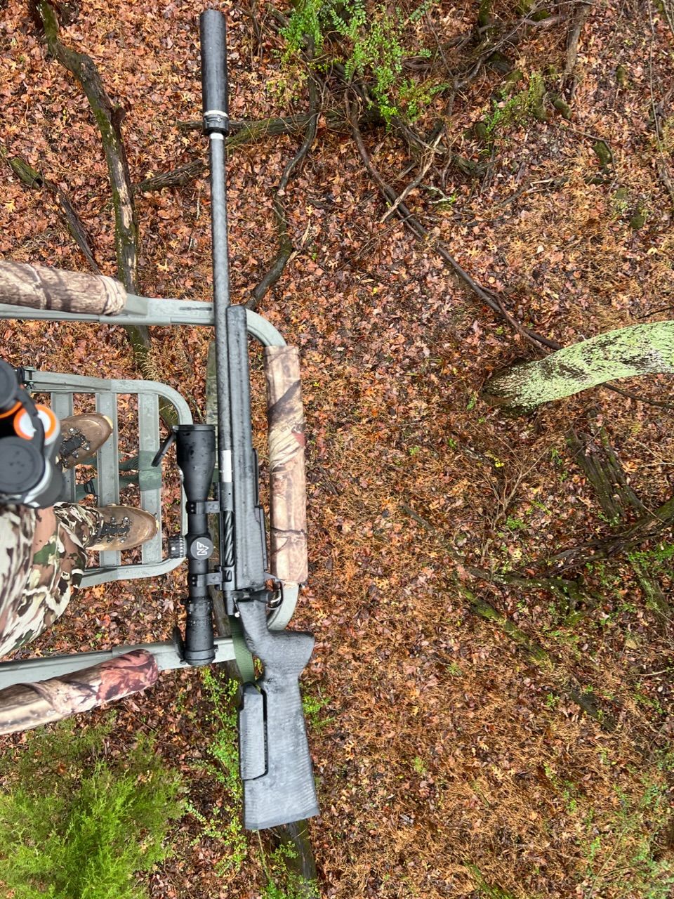

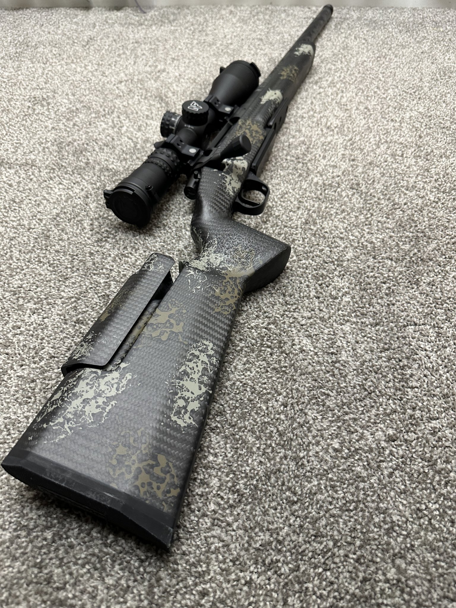

18” 168 Berger vldh 2850
22” 180 Berger hybrids 2935
Both barrels have less than 50 rounds through them so I would expect them to speed up more. I have done 0 load development on either one, just did some hunting with them
18 & 22 both suppressed. If I wasn’t using suppresdor 22 or 24 would be my choice

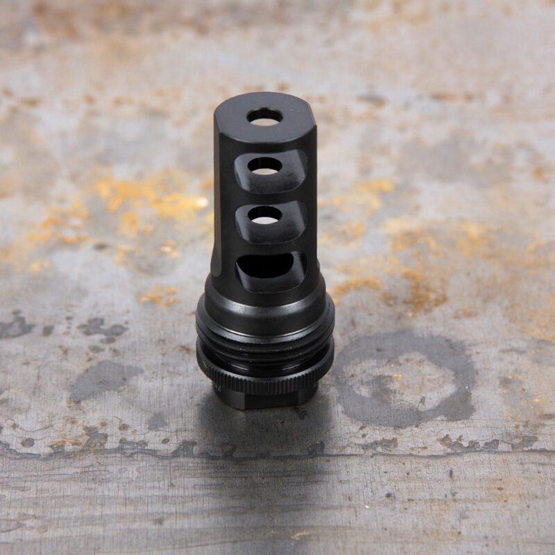

I don't have a shusher machine but I do have a timed brake and I do wear hearing protection. The brake is a Silencerco ASR. So, it does not deflect back, it deflects to the side.
And their Harvester 300 will fit right over it, sized for 7.62, of course, on my 7 PRC. If I choose to get a suppressor. I have to get past the property taxes. I am a poor, unapologetically so.
