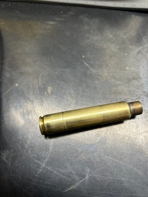

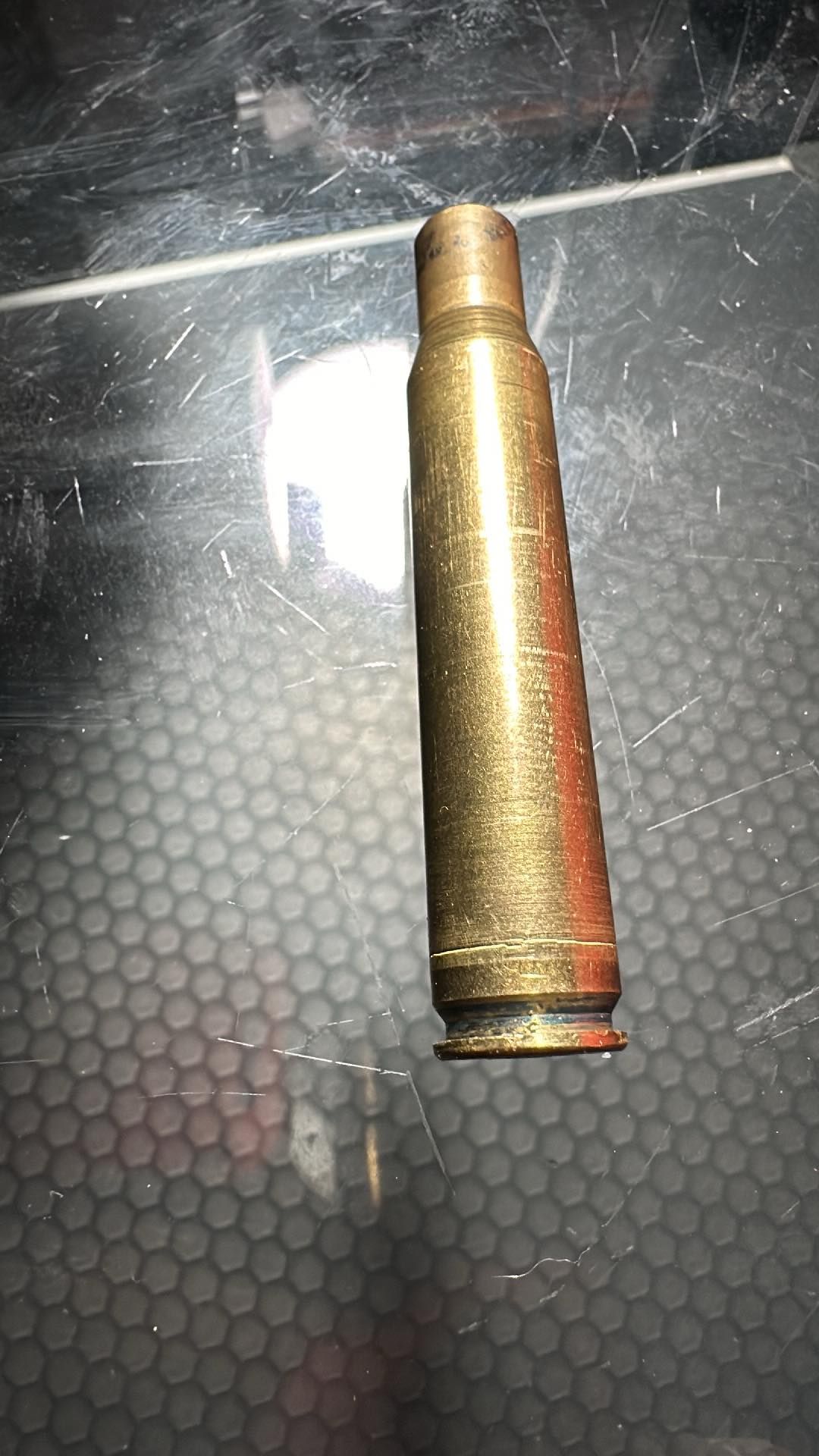

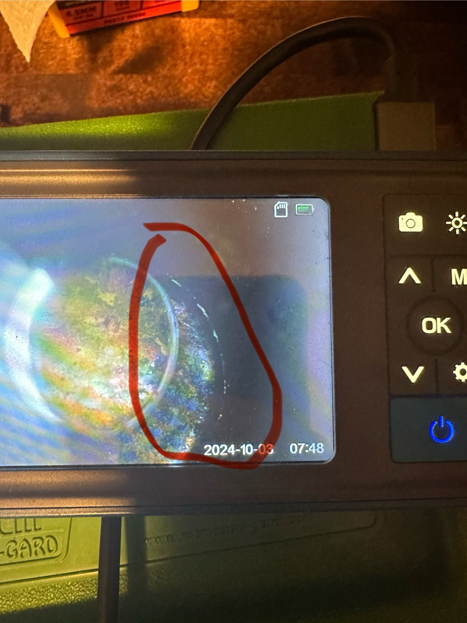

1.901” to 1.915” after firing. Photos attached of the inside and out.
Shane first polished the chamber to see if that would stop the heavy bolt lift and that didn’t work. We were using some m72 to test it. After that we went and found a new bolt his dad had laying around.

Yup. I won’t be recommending that smith personally after this. He offered a 1941 dated replacement barrel (not star gauges) and tried to convince us the old barrels shoot better than a new Krieger. Didn’t buy into that one bit. Since getting the new bolt it’s been shooting great, but all that Lapua brass is trashed.
That doesn't make any sense. You already have excessive headspace with a bullet jam. The brass has to stretch and modify to fill that space. The stretching of the case wall is what causes casehead separation. There is so much space when fireforming non-ackley cartridges like Dasher that it also comes out of the shoulder and neck. What no one can say is how much comes out of the shoulder and neck vs out of the case body above the web when forming Dasher brass.
When you fail to have neck tension to effect bullet jam and the firing pin pushes the case forward, you just have light strikes. No one reports, almost casehead separation. I would suspect you had something else contributing that you weren't aware of.
When the case is held against the BF it blows the shoulder out when the case is up against the shoulder it try's to stretch in the wall which causes the issue. I would have thought I'd have light strikes also but they all went bang, I fired about 5 cases before I had a good look and noticed. I went home and measured the BTO of a chambered unfired round, it was indeed pushing it back. I ended up forming false shoulder and that solved my problems. That brass now has 6 firings on it.
Ya, 14 thou is a lot. I'm a little surprised, but not too surprised. I've seen virgin brass from the manufacturer that was 6 thou under. I've in the past accidently over sized brass down 6 or 7 thou past the fired length impatiently setting up a sizing die. I'm sure we've all made that mistake at least once. My original lot of fireformed Dasher brass from 2018 probably has 30 firings on it across 3 barrels. I've never once had a casehead separation. It really makes me think there's a little something else going on that contributes to casehead separation that most of us don't recognize. We just attribute it to case growth in excess headspace conditions.
My virgin Starline brass for my 1903A4 sits at 1.902” and when fired is 1.903-1.904. Once we put his dad’s bolt in and fired the gun brass was only growing .004” if I remember correctly.
I still have the old bolt and can go back and test things, but the m72 had the same physical signs of imminent case head separation as the Lapua brass did after its first firing as well as similar growth. The m72 fired in the gun after the bolt swap didn’t show the same signs.
If I’m remembering my 1903 info correctly the back of a case on 1903s is unsupported, which is where this case head separation happened. So excessive headspace, a chamber that needed a polish job and an unsupported case could very well do it.

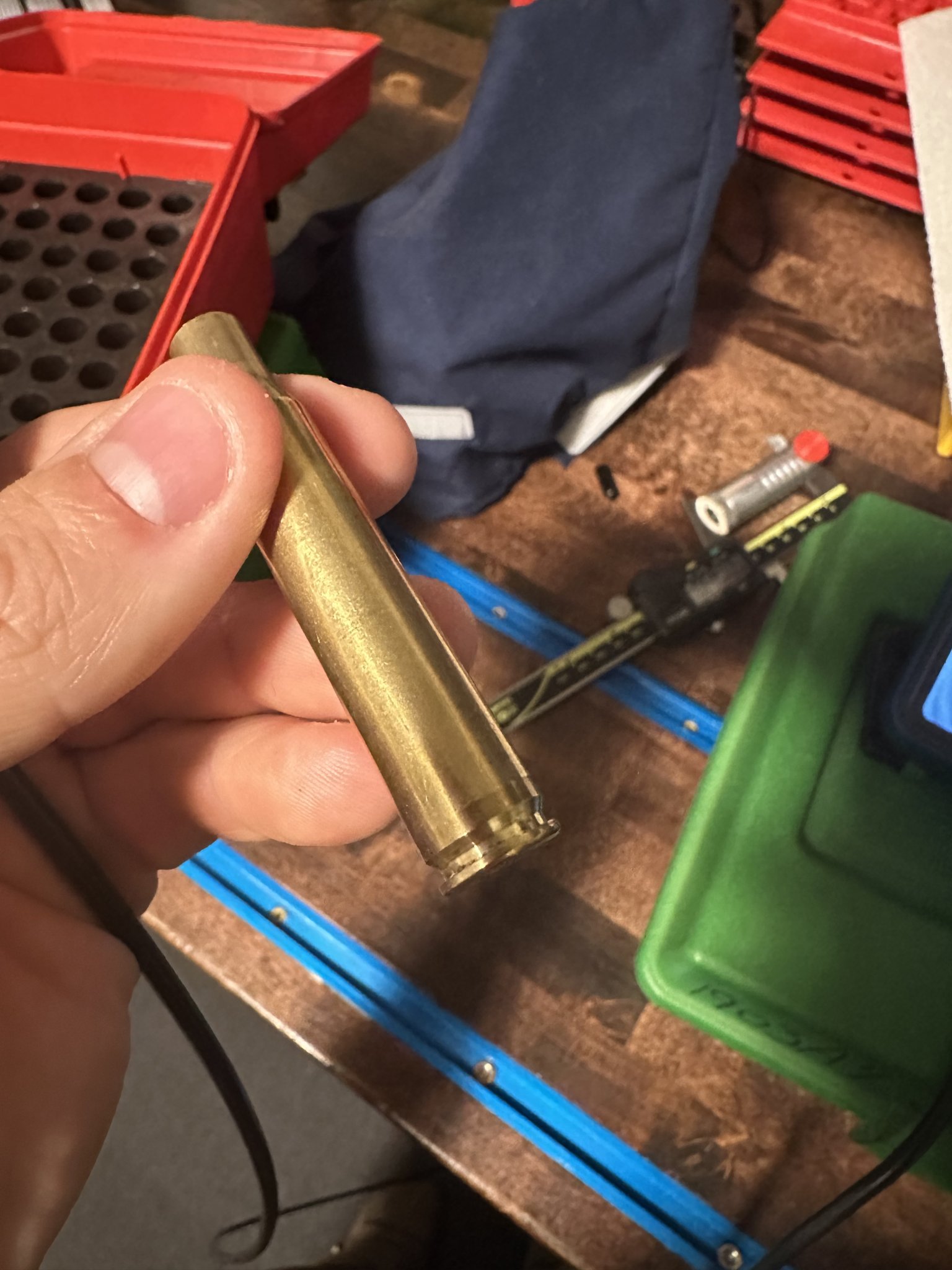

-They were forming but they were nearly tearing the case apart, see picture. (Not sure where you got confused here either)

-See Picture of once fired case, the others weren't nearly as noticeable

How do you know you had near casehead separation? You inspected them after? But now you say they haven't separated and have 6 firings on them?
-See picture. The cases that got false shoulder treatment now have 6 firings. those original 5 pieces of brass went in the bin.

Oh and I found the picture of a piece of brass that made me stop and go to Shane. Just a cunt hair away from completely separating. I got lucky.
