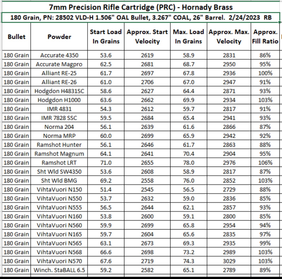

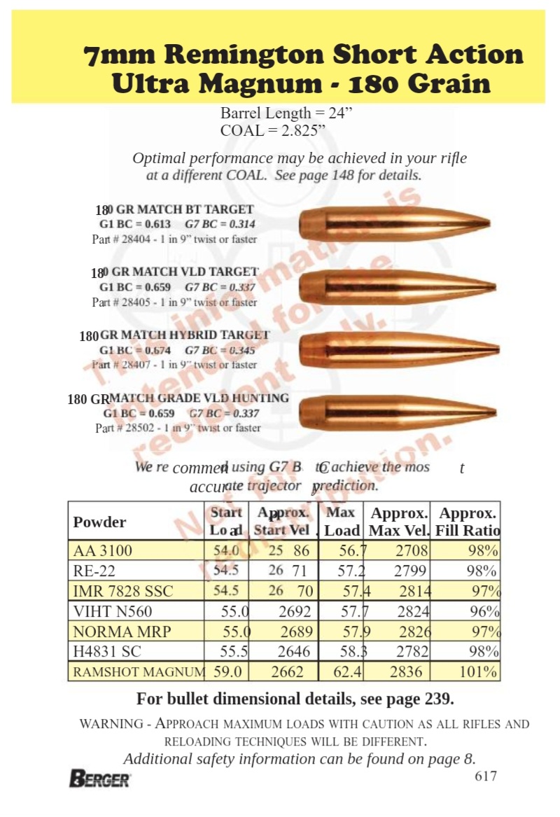

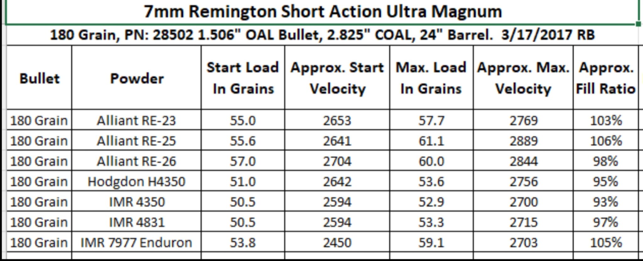

2. How much of a difference is there in velocity between the two (assume 24"/24.5" barrel for both)? Can't find a lot of mfg published 7 PRC data, but looking online it seems a 180gr bullet (180 just as an arbitrary example) will go about 2800-2900 in SAUM and 2900-3000 in PRC?

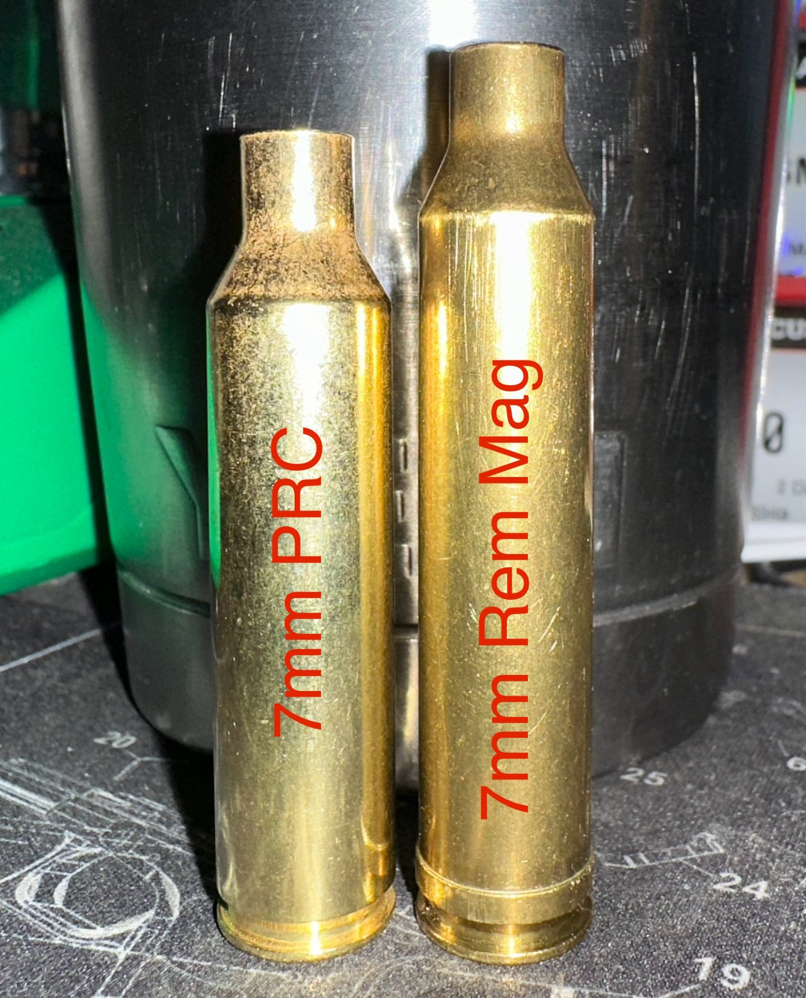

7 PRC on a long action and you can seat the heavies as long as you want. Ballistically, it's pretty much identical to a 7mm RemMag pushed to modern pressures with modern components, which is one of the best hunting cartridges ever made.
It is a little bit shorter than a 7mmRM, but case capacities are nearly the same thanks to the very low (straight) taper of the case walls. But this shortness comes into play allowing you to seat heavies farther into the lands while maintaining magazine lengths.
Here's a pic I took of one of my 7 PRC cases next to a 7mm RM cases.

Looks like I'm only losing 100-150 FPS going SAUM instead of PRC. Difference in drop for a few different projectiles in a ballistic calculator is <5" at 450-500 yards (minimum v around 1950/2000 for bullet expansion, not because I'm only taking 500yd shots).
