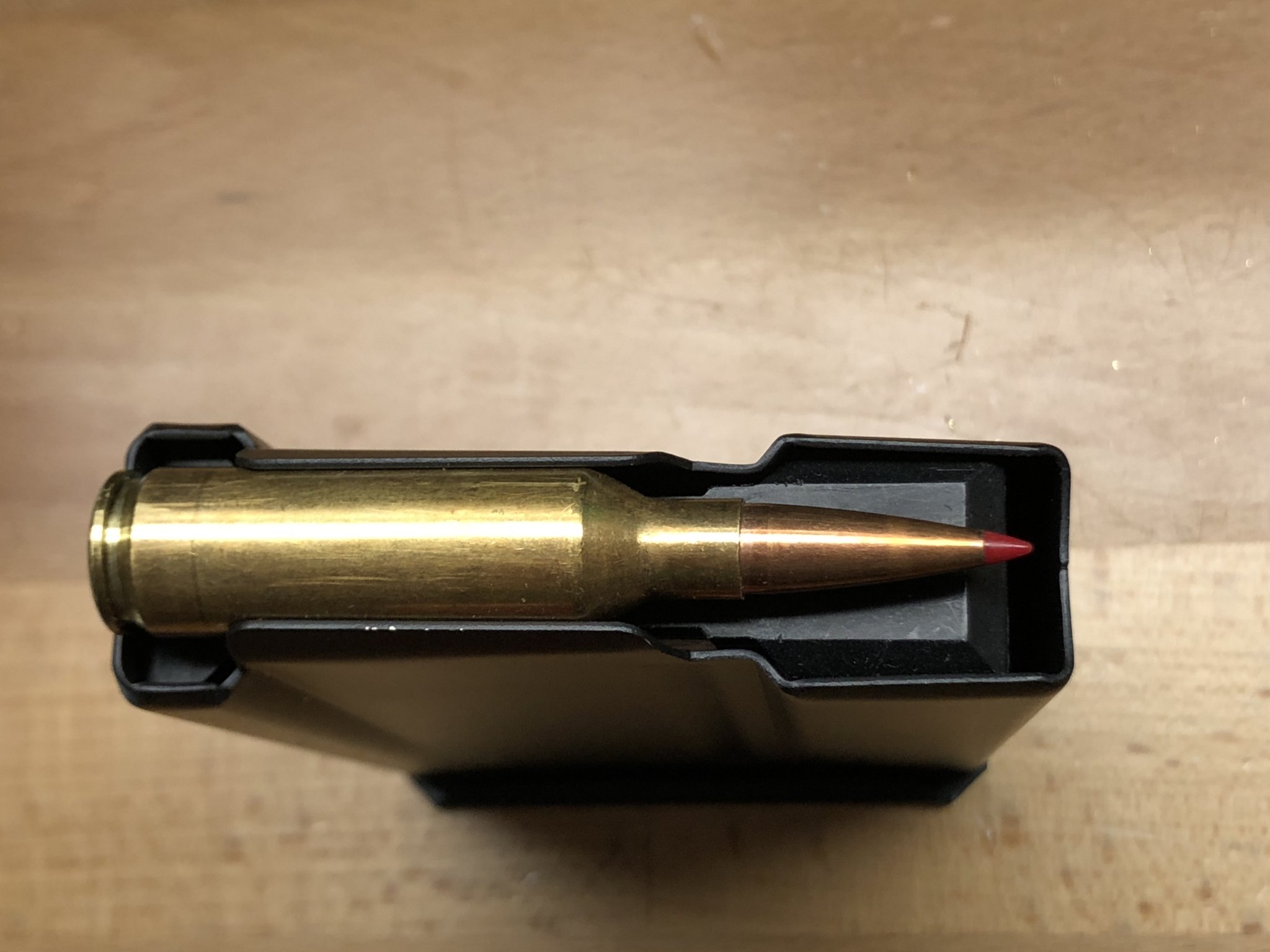

Here is a 180 ELDM in an Accurate Mag WSM. It's sitting .100" off the the end of the magazine. Not quite sure yet. I may push it out to .050" off. Haven't spoken with the Gunsmith yet to see what's the best way to go.

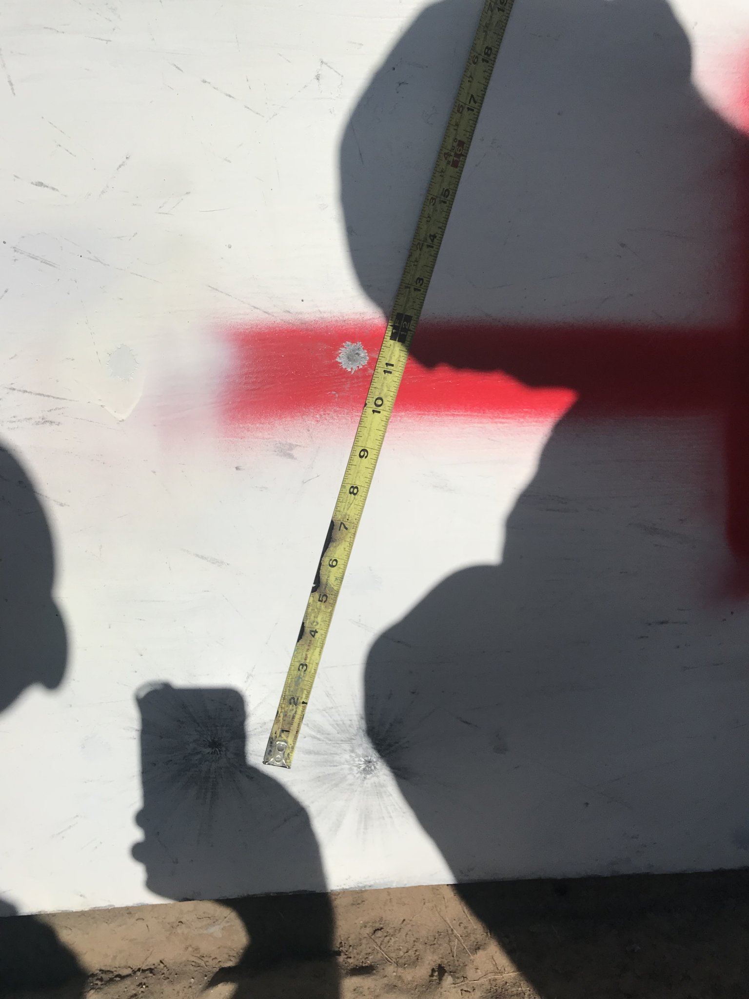

Helped my buddy with the long action 7 saum run a quick ladder this afternoon and accuracy node was ~ 2940. He might chime in with more details.
On a side note I had a first round cold bore impact at 1580 yards today with my 6.5 saum so can’t complain about that! Just in case you’re contemplating going that route! ?

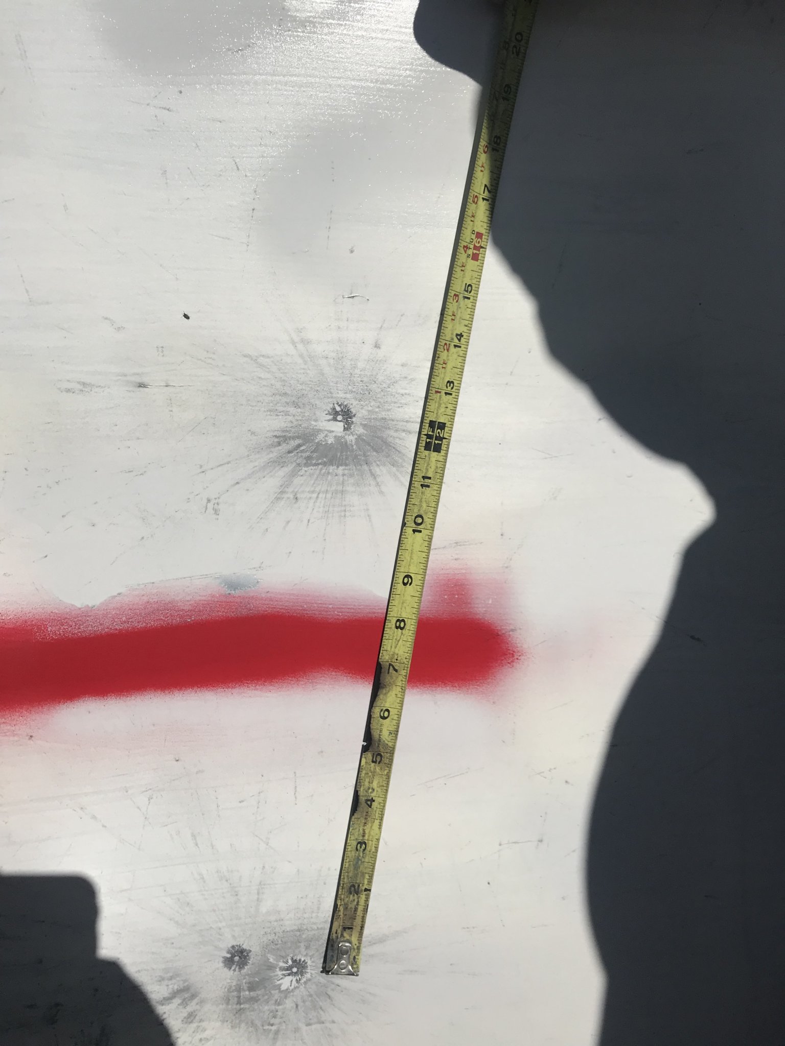

Ya we ran a quick ladder on my 7 saum today. Originally I was running 65.6 gr h1000 with 180 eldm’s and it was shooting really well (same load in another saum I had) but I was having a slightly stiff bolt lift so ran another ladder today and settled on 64.9 gr. Originally I was running in that 2985-2990 range once the barrel was broke in. Now it looks like I will be in that 2940-2950 range. I’m running this in a long action and if you still have the option to go long action I would. SAC chambered this barrel for me and their 7 saum 180 hybrid specific reamer is perfect!! Short action cuts so much potential from this cartridge. I’ve ran this setup out to 2010 yds with awesome results!!!!!

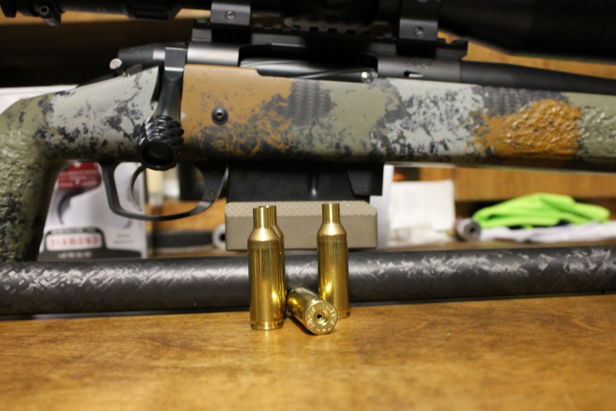

Bertram 6.5 saum brass should ease the drought on supply and quality sounds good. I’m running copper creek 300 saum necked down, expensive but great brass. @Bandit31

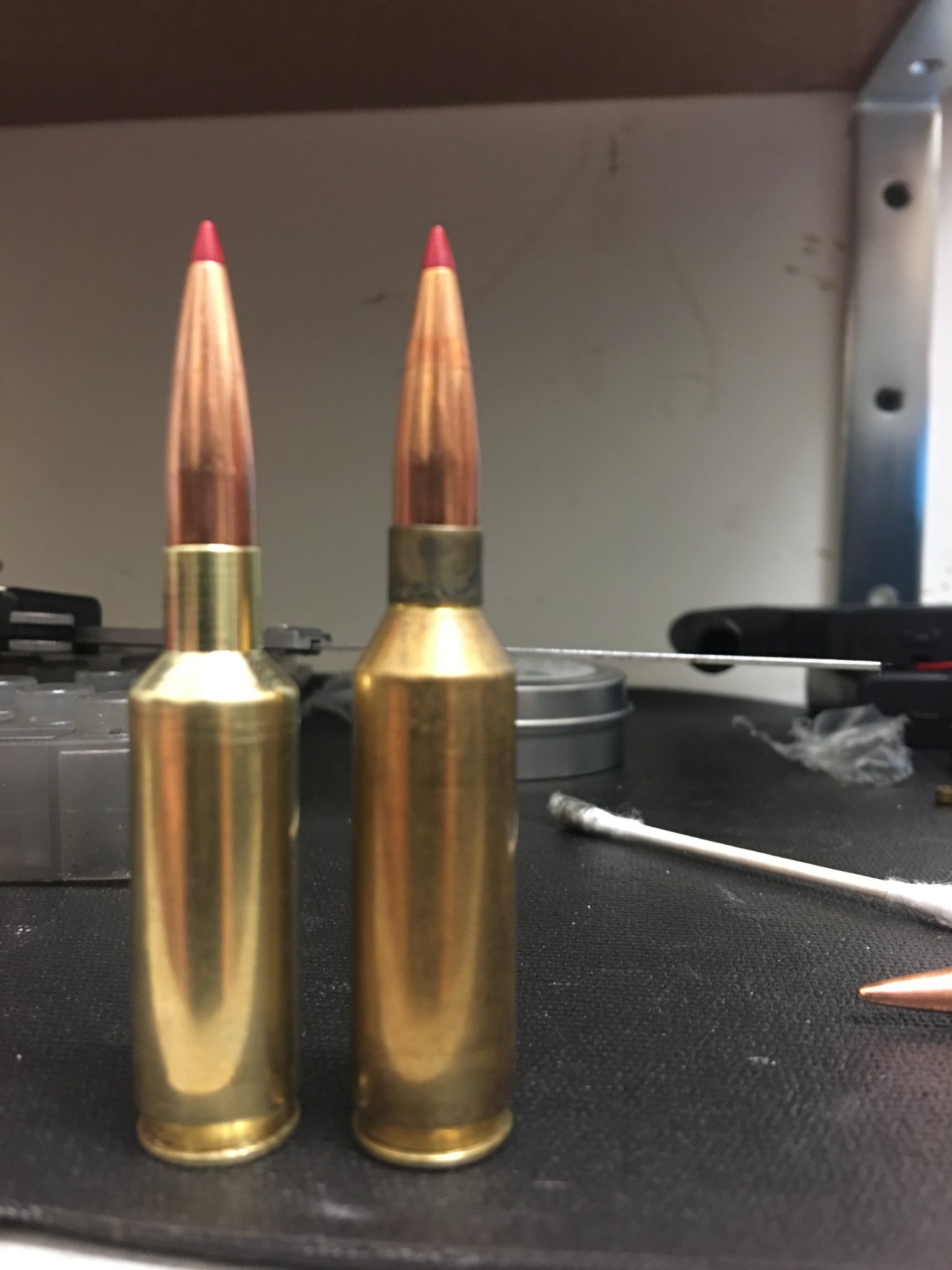

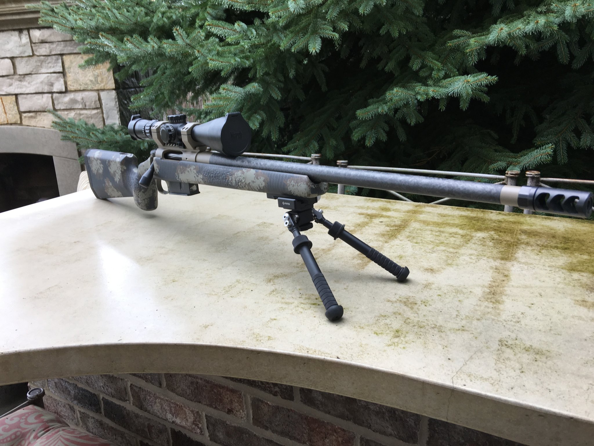

If you don’t mind a little extra work the 7 Sherman Short solves all the shortcomings of 7 SAUM in a short action.Its like a Giant 7mm Dasher. Fire form 100 rounds for Breakin and that will last the life of the barrel,and a lifetime of hunting.

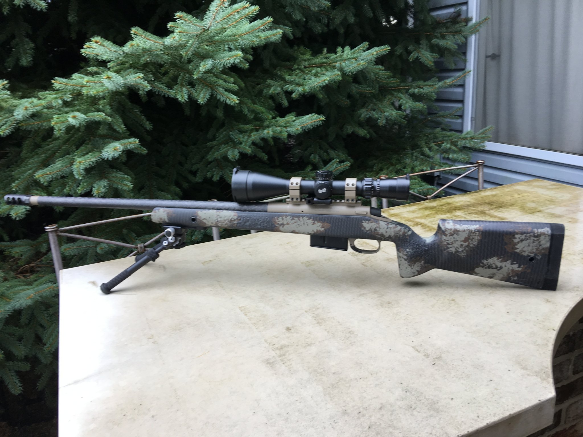

Mine is just under 9 pounds as shown and very comfortably shoots 180 eldms at 2950 or 162s at 3100, feeds like butter out of an AI mag with the plate removed.
Great looking rifle! What barrel length did you go with?
