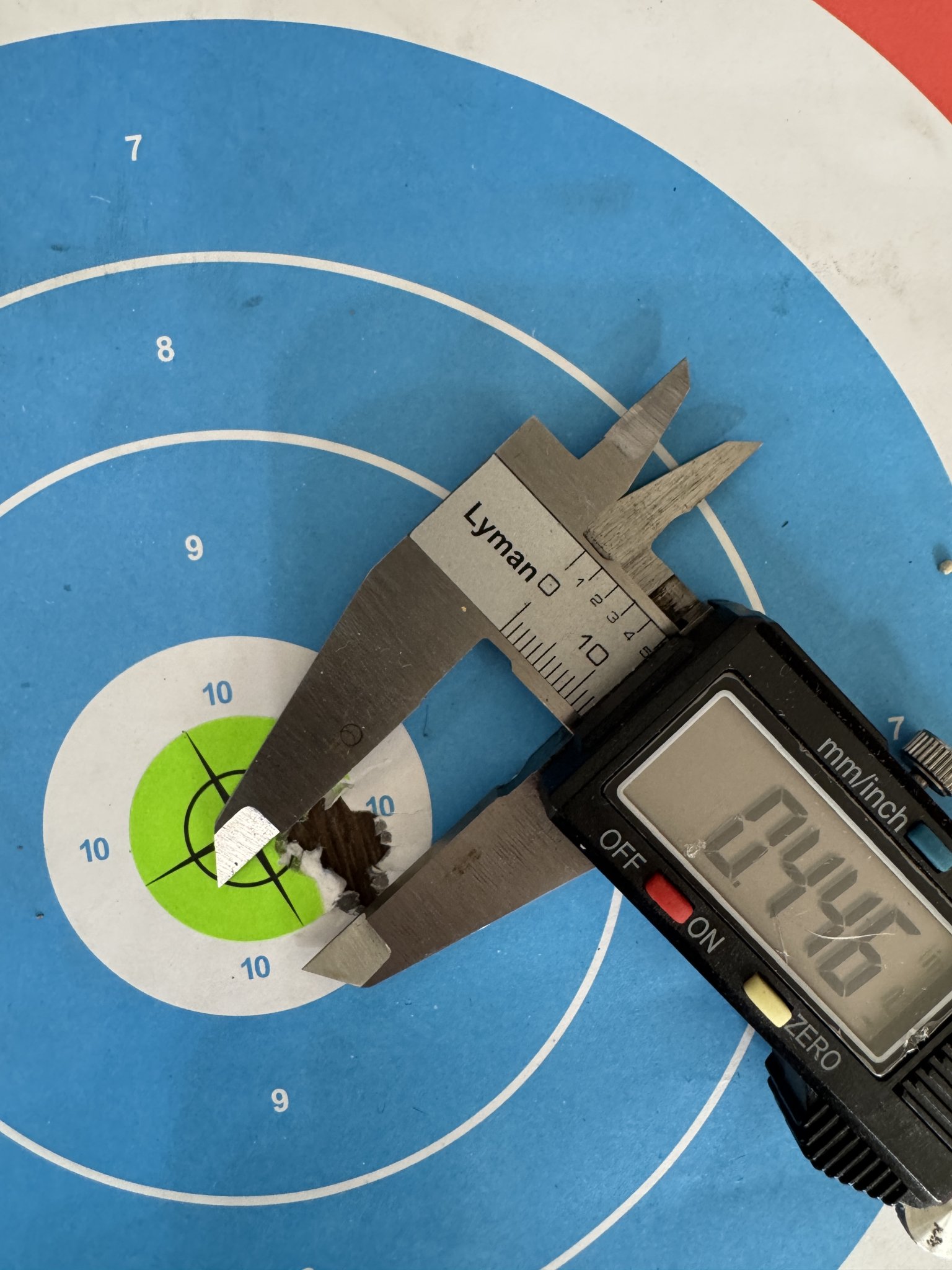

I am having some problems now though after being incredibly pleased with my initial shooting of right around 0.446" at 100 yards for a 6 round group. ( I load 6 so that I can have a 5 round group with a true called flyer if needed. This one was not needed so I just made the hole a little bit bigger. This was shot during the initial barrel break in and preliminary load development.

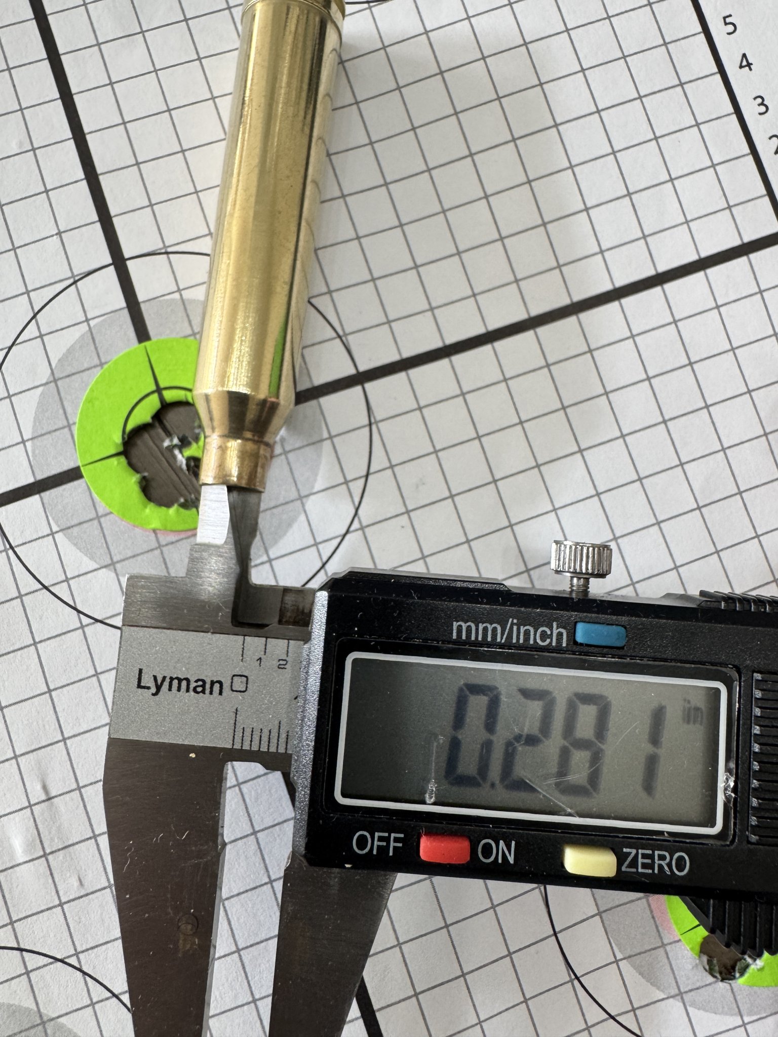

When measuring the inside diameter of the neck with just my calipers I am getting between .2795 and .2815. This does not seem right to me as the bullet that was loaded yesterday morning into this brass was .284 and shot that afternoon before these measurements were taken.
This leads me to believe that the neck on my brass is to thick for my chamber- Is this an accurate assumption?

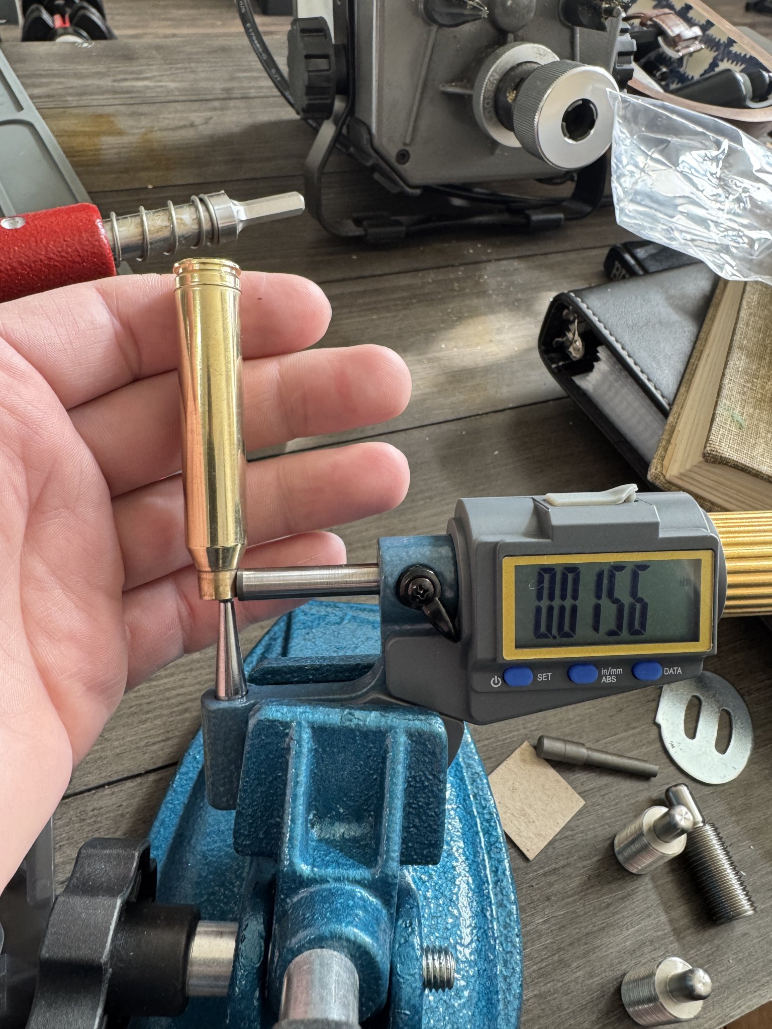

When I measure with a ball micrometer the neck wall thickness of the brass is reads at different locations on different 2x fired brass of 0.01565" - 0.01605". I did tumble the brass prior to these readings to remove the carbon which I believed would affect these measurements. After seeing the discrepancies I believe my neck tension/consistency would benefit from turning the neck regardless of whether or not this thickness was too great for my chamber.

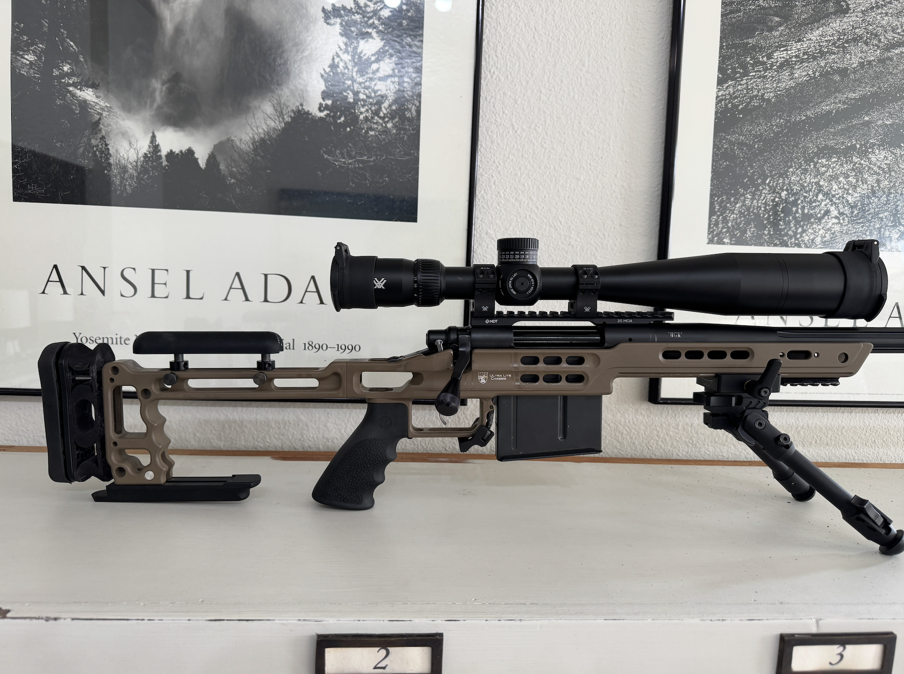

Here is the gun for those who are curious- Believe it or not this is still actually still under 12LBS With a Heavy Palma Contour (Without the Bipod) but with the base scope(scope caps) and rings, Bag Rider, forward pic rail, etc). 12LBS is not for competition needs or anything- That was just my goal as this will be a long range hunting rifle and not just a range gun.

Ball-mic your necks at 3-4 places for baseline. May well need turned
I found out that the neck on my reamer was .3185 in the neck so my fired brass has less then .001" clearance which explains what I was experiencing. I have ball-mic'd my brass and will take additional measurements before setting my neck turning device when my 7MM mandrel arrives tomorrow. I have also ordered smaller bushingings and an expander ball from Whidden to fit once my necks are turned.
Reactions: Seymour Fish
So your loaded neck diameter is .3152” with new brass? Check at the base of the neck as it may be thicker in that area. What is the diameter at the base of the loaded neck with 1x brass? Could be the shoulder flowed into the neck and is causing a constriction.
Measure the neck OD of a piece of loaded brass, and the neck OD of a piece of fired brass. That will tell you if you need to turn necks/more neck dia in your chamber.
