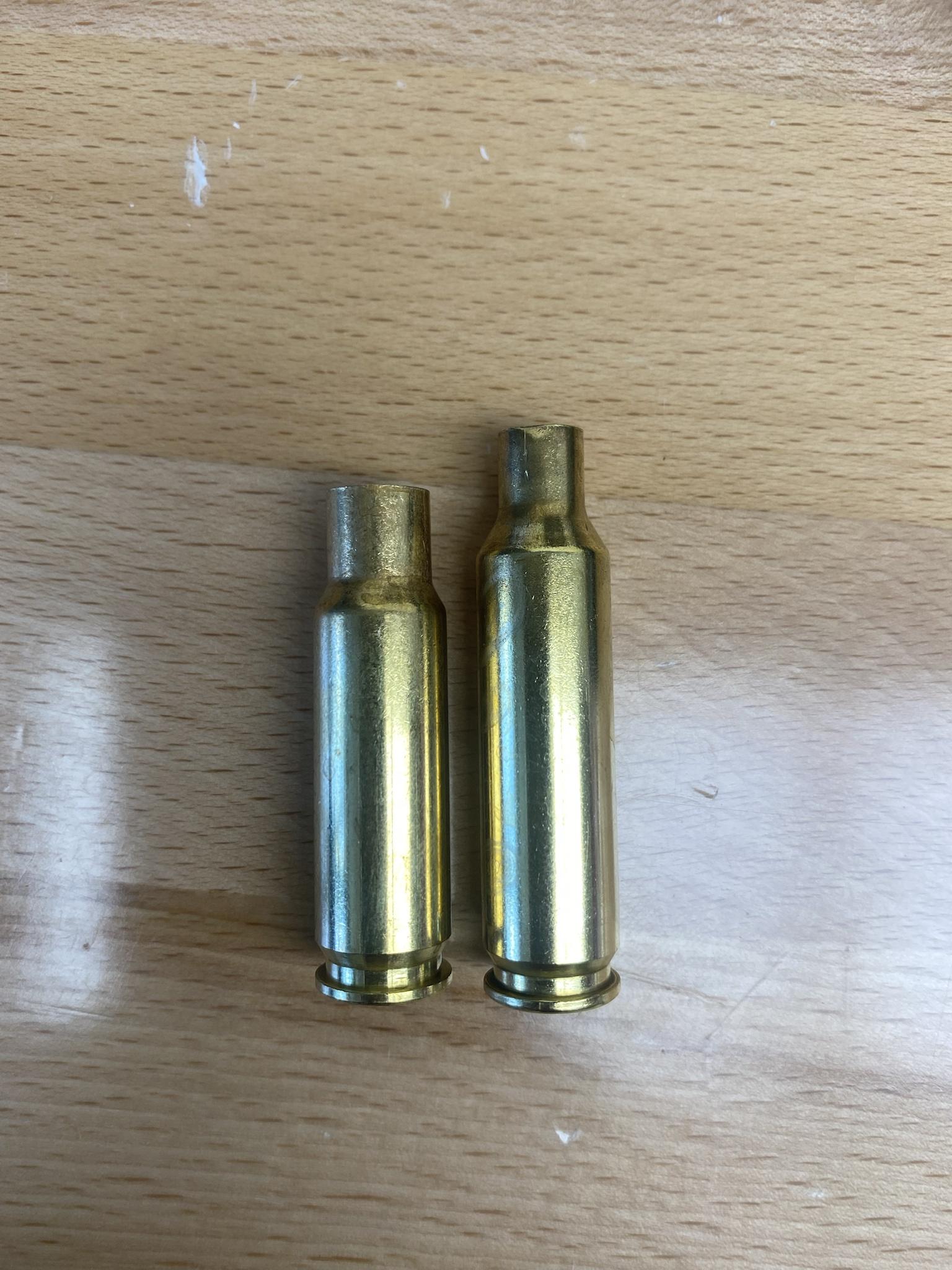

Parent case is the creed, should be the same I'd think? Problem is, you're comperator that you're using to measure headspace on your gauge, isn't going to be an exact dimensional copy of someone else comperator used to measure a gauge. You'll see different numbers.
The 8.6 and creed are quite different.
Reactions: Ledzep
The 8.6 and creed are quite different. View attachment 8239179
It most definitely is! I knew it used the creed parent, but didn't realize they moved the shoulder that far back. Clearly a cm gauge will not do anything for the OP, I put my foot in mouth there.
