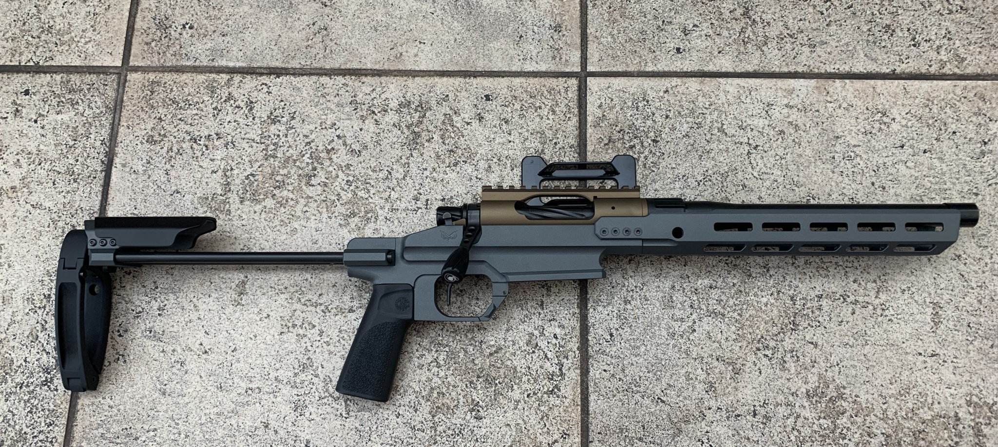

I have a Remage style build for my 8.6.
I am using JTAC Industries chassis.

Nice, I found this one a few days ago and really like the telescoping rifle butt stock vs. the folder.
How did you come about the CA action?
I was considering just doing a build off the MPP, but seems silly to pay $2100 and pull off a carbon barrel though.
I found a place that has stripped CA receivers. Let me know if you want to link. Just PM.
I got this brace, because you can adjust check well up and down with a few positions.

I was inspired by Dragonetti's build, and went with the same chassis, but want to go with a folding stock, does anyone have any recommendations for a SF 1913 pic rail stock that has a bit of a buttpad?
You can try an:
or
Something from Sig:
You can try an:
or
Something from Sig:
I saw that Black collar is restocking their side folder for the pork sword this month and trying it out, that sig adjustable is a close second.
I have my pork sword on order currently. They said I should have e it by 3 week in July hopefully. Running 6 slot rail and 12" barrel with 1913 pistol brace. Kinda wish I went cheaper but I can always do that next time. For now it's just a paperweight until I buy action in Sept.
I had an Occam defense side folder to get the rifle zeroed, no recoil pad, you're gonna want a recoil pad as its a stout recoil. Also the screech owl 10.5" handgaurd is a smidge too long with the tapered barrel.

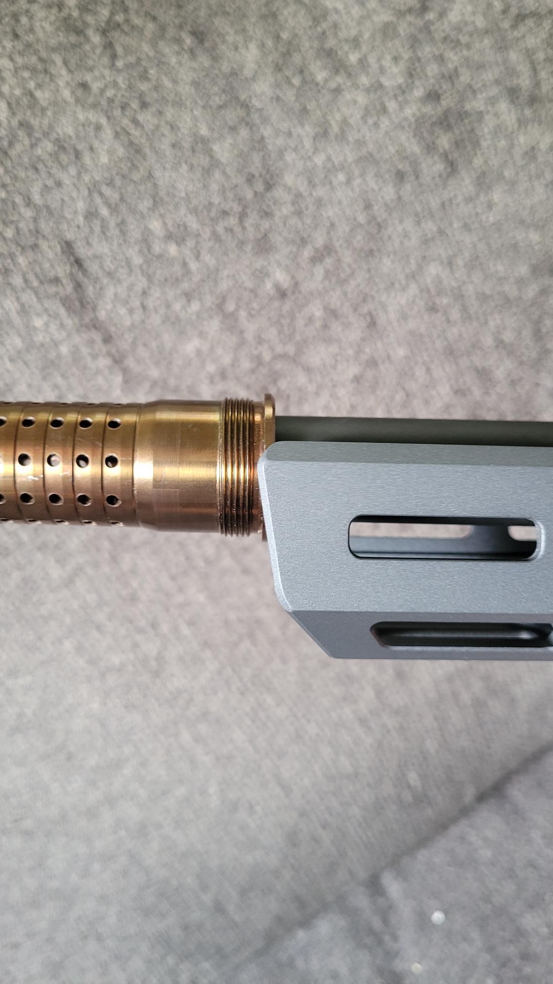

I just got the Q Cherry Bomb for the M18x1.5 threads. I wonder if they are going to come out with a new plan b mount for this. I would like to get a Dead Air Primal for the suppression. I dont think their porkchop suppressor is coming out anytime soon.
I have a primal in process. I contacted Q a week ago and asked about a Plan B XL, it's coming but no time line. They weren't willing to give up the thread pattern on the outter mounting surface either. If push comes to shove I'm gonna get deadairs direct thread mount, Elk season is just under 4 months away.
Yeah, would be nice for them to give up some dates. The Cherry Bomb is already out. I am guessing they will make a few different thread pitches. The Primal is the same thread pitch as the Omega if I am not mistaken.
It's the Ghost M pattern for the Plan B, but I'm not gonna get another muzzle device as I like the Plan B and everything else is so heavy. With a pound can like the primal I don't need a 5 oz device.
