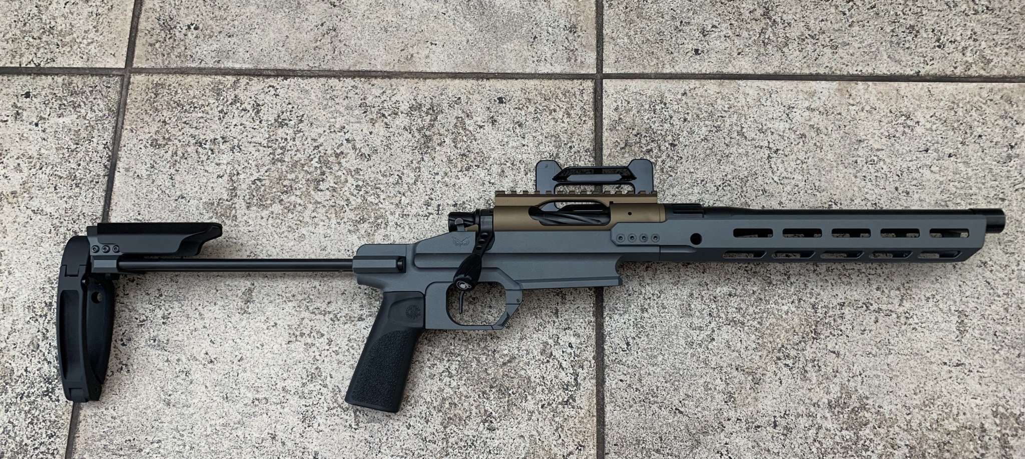

Well the pistol is built.
Christensen Arms Receiver
Faxon Barrel
Timney Trigger
JTAC Screeching Owl Chassis
Need to get an optic and muzzle device.
