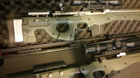

Something like my son's chassis or this 98 mauser's AICS clone chassis could also be made on a mini it would just take a lot longer.Kinda like the difference between using a lee hand tool and a dillon, either give you the freedom of not relying on store bought ammo, a mini or a Bridgeport let you not be as beholding to store bought parts- one is just more convenient than the other depending on circumstances ( I wouldn't take a dillon on a safari, I would't want to solely rely on the hand tool for all my ammo, I would hate to make parts on a production scale on a mini,and I wouln't put a bridgeport on an apartment)
@skinnj1 that AICS mauser is cool as hell, did you make that? Do you have a link with more details on that?
@JSchell1309
Yes I made it- I believe that it was posted in a thread that got "lost" over the years. The picture was posted in this thread to emphasize the options open to someone with tools in support of my position that it is better to buy tools than jigs where possible and what could be done with a mill. Since this is 80% thread in the semi-auto section let's have the aics mauser discussion in another thread or via PM
