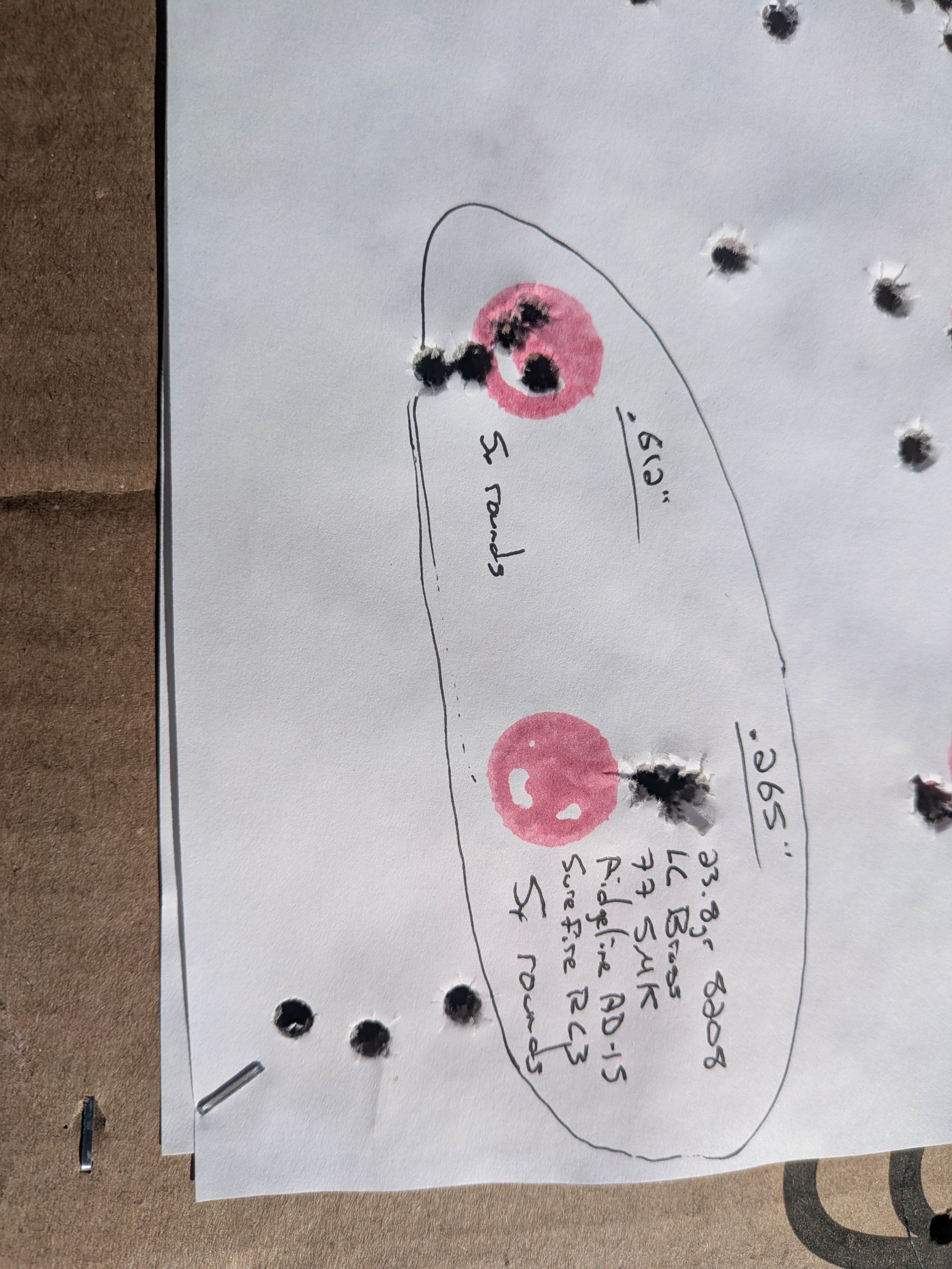

Same load, all my shooting is done suppressed. I did the load development with my Mk12 and it wears an OCM5. It also shot fairly well with the 23.5gr but I wanted the extra speed. The rounds shot really well with the RD15 and an RC2, but then tightened up even more with an RC3.
See pics below from the RD15. Ignore the other random shots, was fighting 223AI load development and trying to zero.

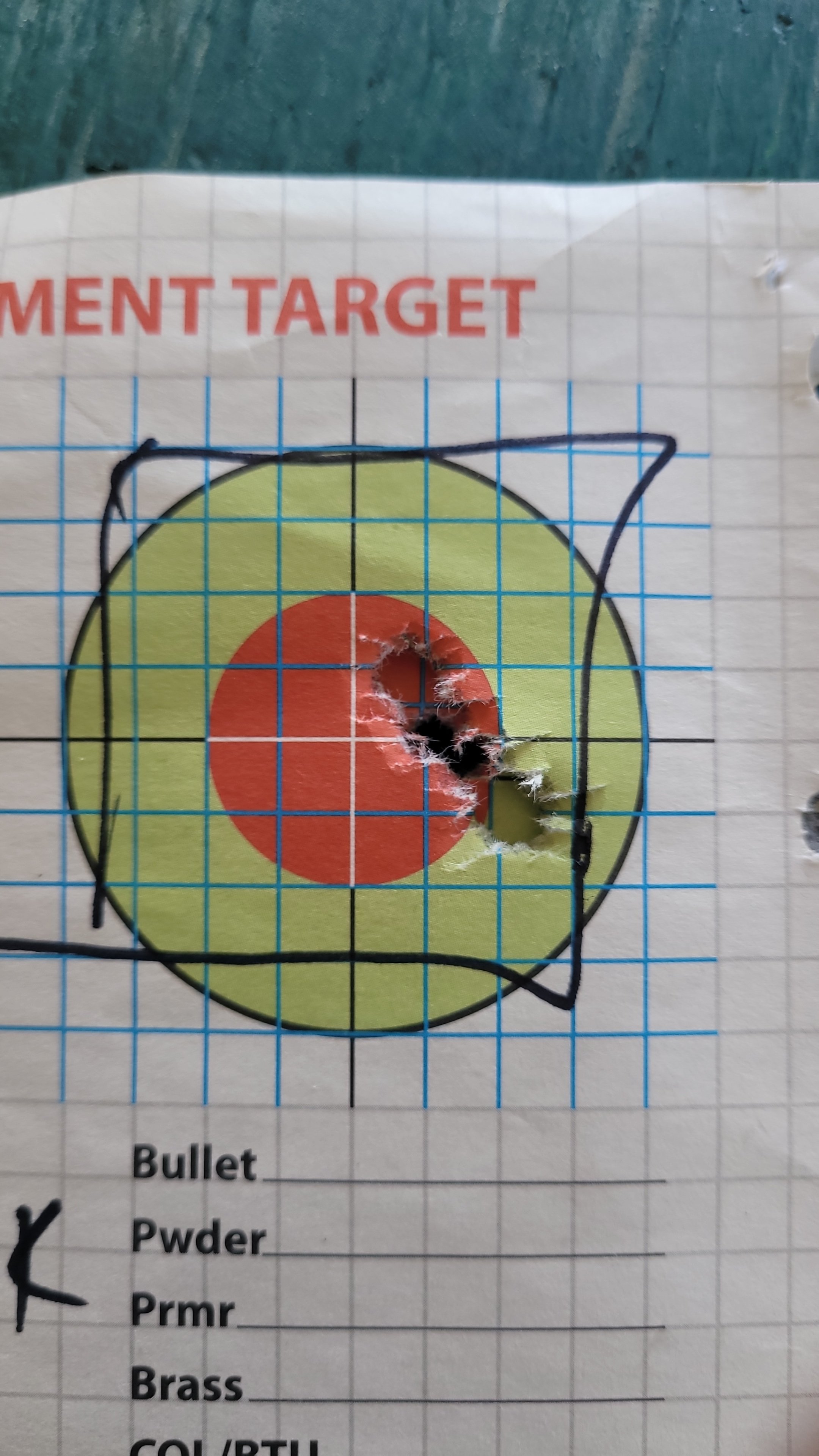

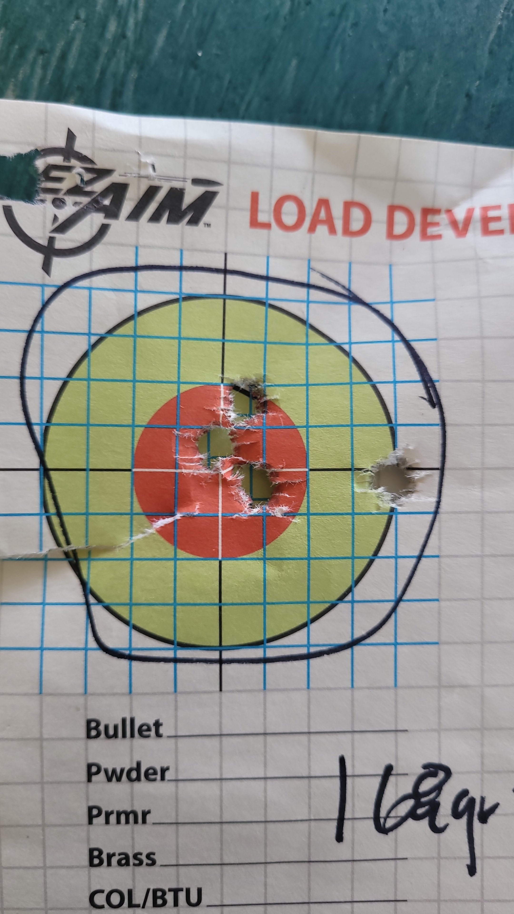

So I was at Greentop and they had 8lb jugs of 8208xbr for price to have it shipped so I jumped on it and glad I did. Did some load development starting at 37.0 to 40.1 with 168gr smk coal 2.775 starline srp brass @ 100 yards. Shooting AR10 20" faxon match barrel 1:8 twist adj gas block. Heavy buffers 11.5oz buffet and spring was a great purchase. I had great results with IMR 4895 but liked how the rifle functioned with 8208 xbr. Next will load several from 37.0 to 337.3 and see what groups best. Here is a few pics and thank you to everyone who posted. The pic with one flyer was cold bore shot but could have been me.
