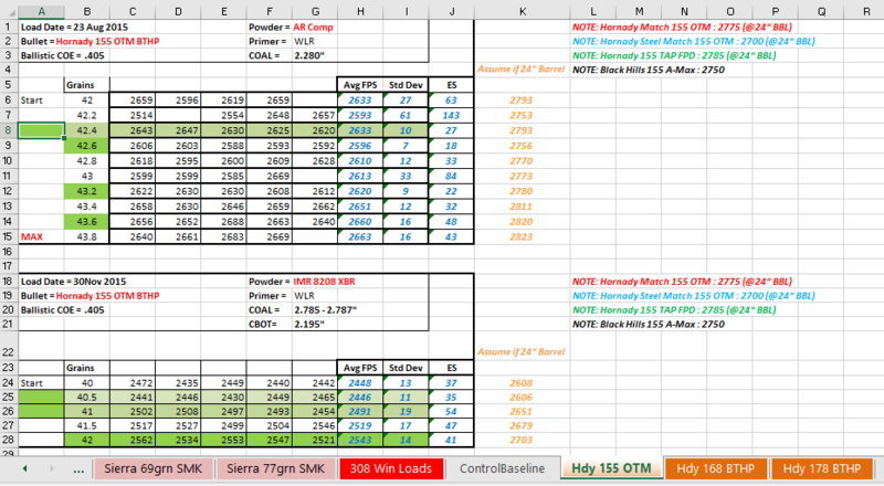

...8208XBR was what I could find at the time, here's the initial load test results, brass is 1x LC various years. AR platform using 16" Ballistic Advantage Hanson profile w/SLR Sentry AGB. This is my initial tests for pressure, FPS and grouping before the tweaking begins... Your Mileage WILL Vary..
