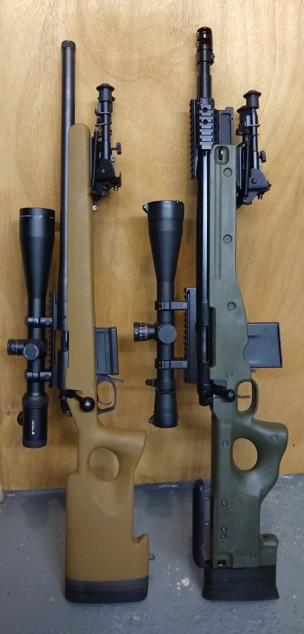

    I first tried 95g SMKs in my F-Class 1:7 Shilen throated for 90g SMKs. Worked pretty good. Groups averaged under .5". typically .3". Velocity was pretty low as I worked up slowly.
    After a while I made a dedicated Bart PRS barrel. 28" 1:6.5 throated a mile long to accommodate the 95s. If I remember right I was pushing sanity and had them up to 2800. Around 2700 was sustainable for brass life. I was also pushing 90s to 2900, but 2800ish was sustainable for brass life.
    Outstanding groups across the board.
    I won't get into loads. I tried Varget, StaBal, RL17, RL16, and XBR if I remember right. Varget and RL17 were the best. I would say at peak velocity testing they were very much over pressure. At match loads, they were good by my standards. There is, or at least was, no book standard for this when I started it. There may be now. As far as how far it's throated, I have no clue. I made dummy rounds for my smith to use and he throated appropriately. I was limited by the mag itself. If you see the picture, you'll notice the Accurate Mag has been modified with the entire front portion of the insert removed-not just the top lip.
    Awesome setup, but the trial and error of making it all work involved a lot of error.
