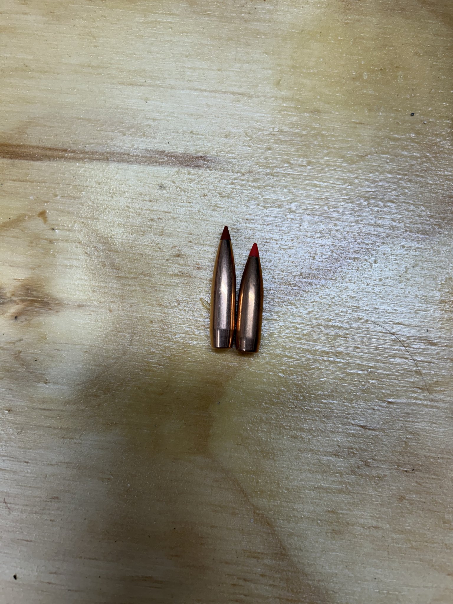

    Have any of you had the opportunity to compare the 87gr Vmax to the 80gr VT yet? B.C.’s look very close between the two. Just curious if it is worth jumping from the 87 to the newer shinier 80. Looking at shooting them out of a 6mm Creedmoor at prairie dogs and coyotes.

    I'd run whichever shoots better in your barrel/rifle. Both are solid 6mm options within typical varmint ranges (I'd expect extremely similar terminal results), but the BC/ballistic nod will favor the 80gr. 7gr lighter (faster) with a slightly higher BC and a heat-shield tip. The faster you push the 87, the more aerodynamic heat deformation you'll get. BC numbers may drop accordingly.

    Since both are tipped, shouldn’t they both terminally expand at the same velocity? Or will that be hampered in the VT since there’s a cavity between the back of the tip and the front of the lead core?

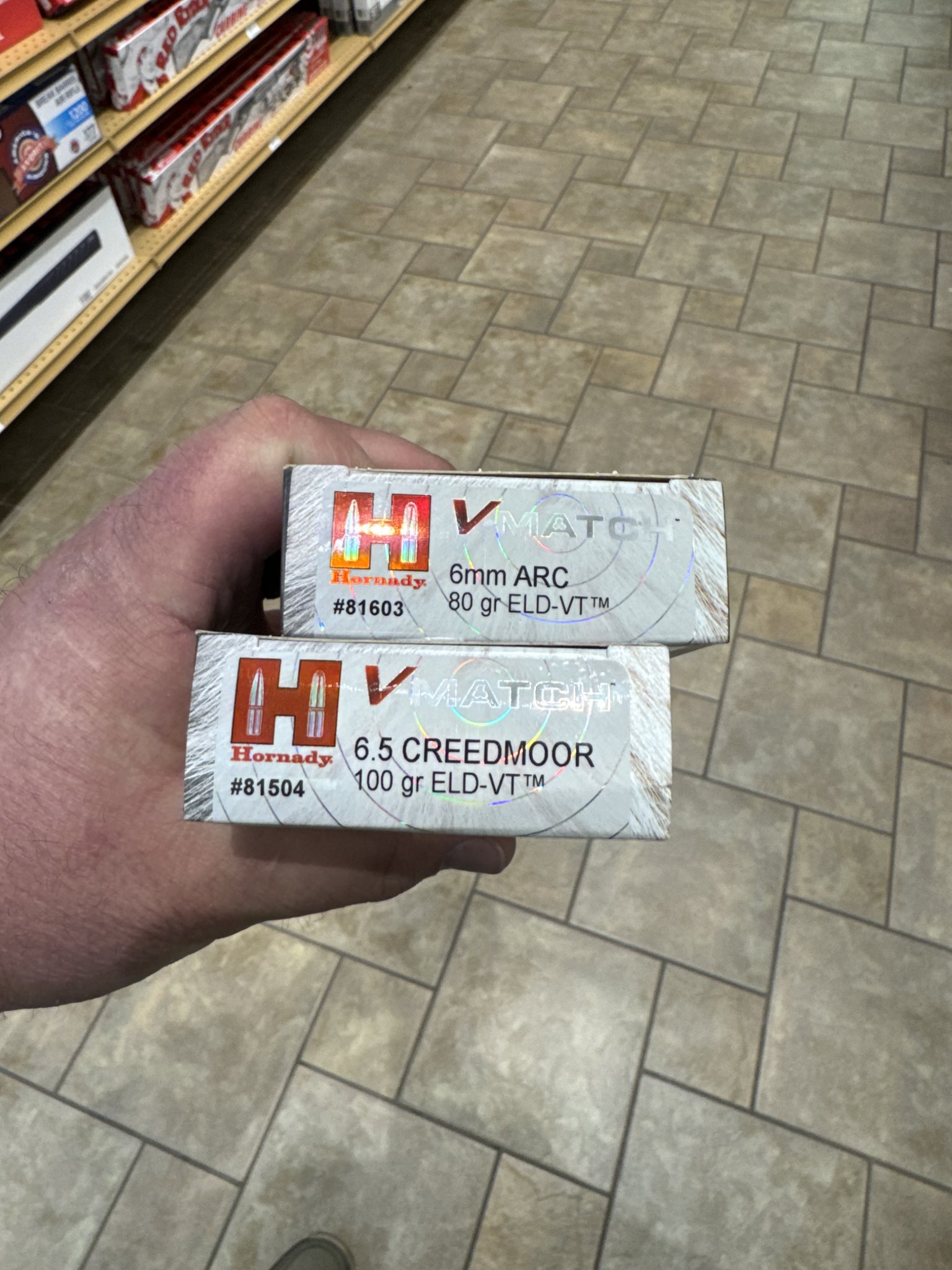

    Any idea when 6 ARC and 6 Creed ammo will start shipping with the 80 ELD VT?
    I picked up 6 ARC and 6.5 Creedmoor today at Scheels.
