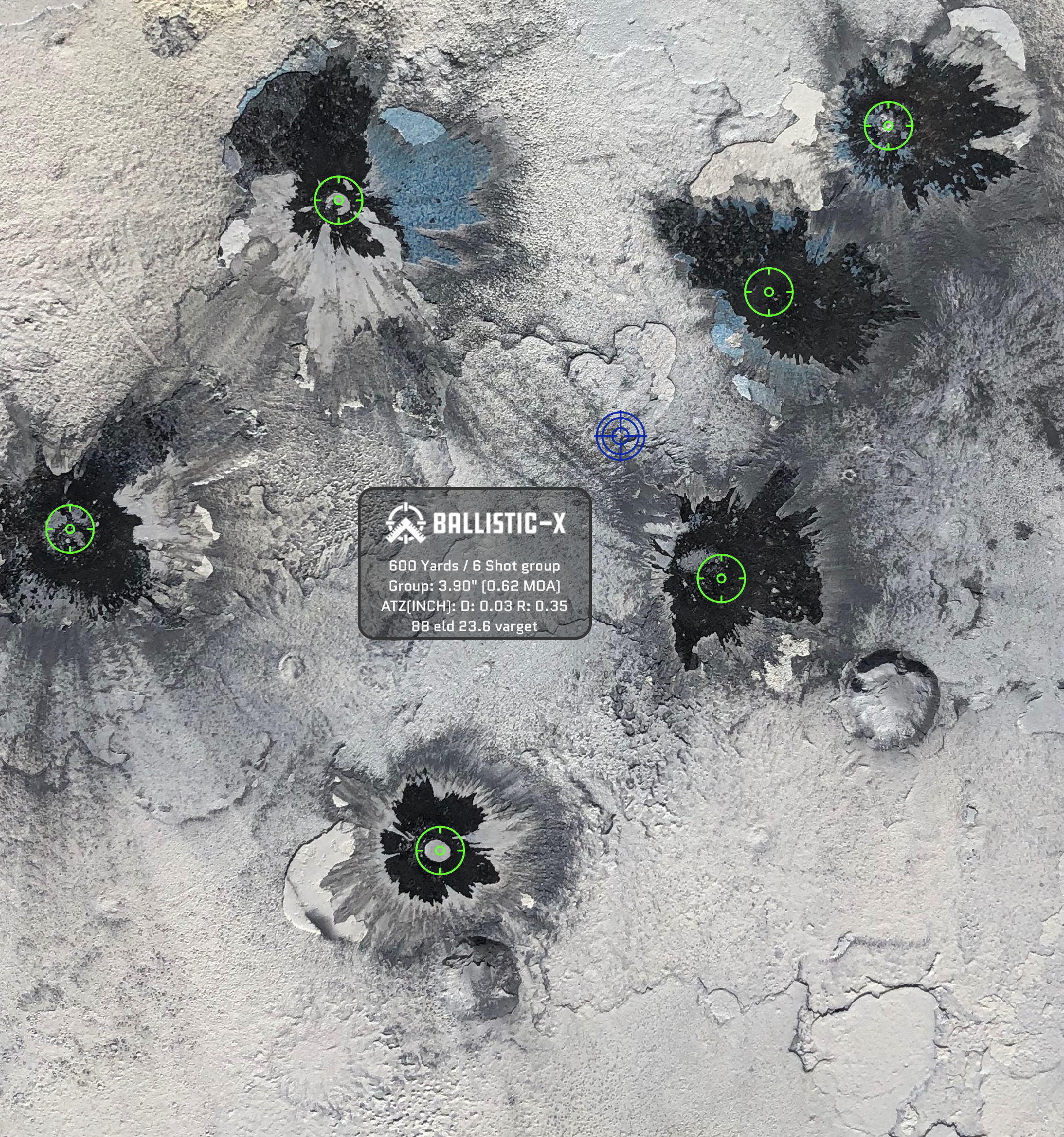

So I just got don’t shooting today took the 88’s out to 1200 yards 1st round hit at all targets from 500 - 1200 yards in 100 yard increments. However we had good weather conditions. Running them at 2837 FPS. 26” barrel
what SD and ES are you consistently getting?
223 wylde chamber, mullerworks 7.5 twist 24”. 23.6g of varget, lc18 brass. Avg 2806 FPS. Group at 620 yesterday, 3-5mph wind

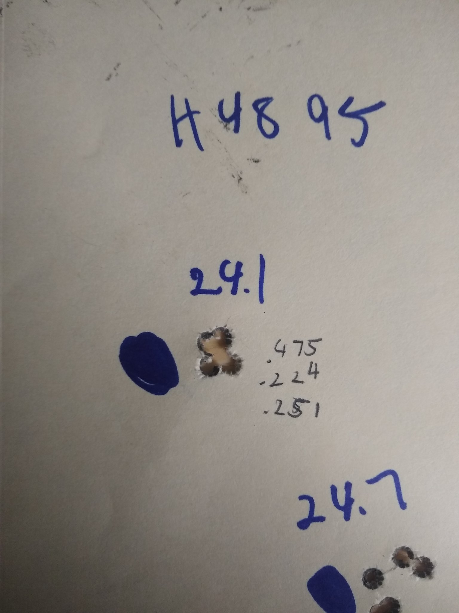

24.1 h4895 is money for mine too. Varget was also good.

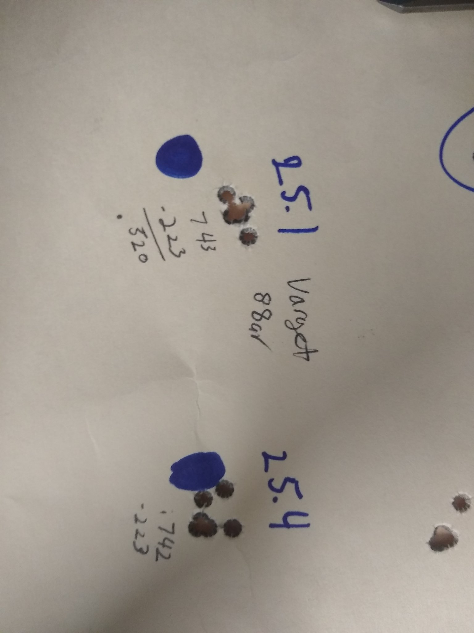

You must have a really long OAL to fit 25.4gr of Varget behind an 88. I crunch kernals at 2.300" with a 77SMK and 25.25gr Varget in a SAAMI .223 Rem chamber.
I shot it at one last weekend. Lol Pretty much runs with the baby 6’s. A tenth off a 6 creed running mediumish It would get out ran eventually but the only issue was spotting the impacts at distance snd it didn’t have enough ass to spin the spinner. Other than that you aren’t wrong, it kicked ass.
