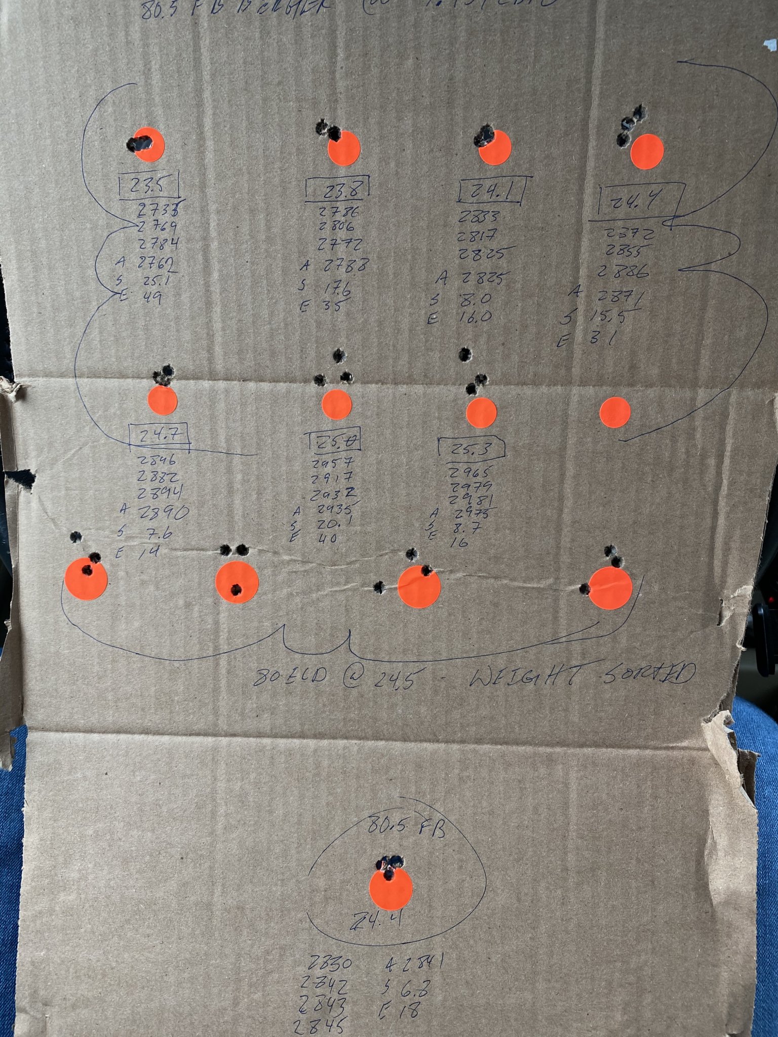

Had the same issue with 80ELDM in 223.
My gun just didn’t like them. Switching to the Berger 80.5 solved my problems.

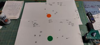

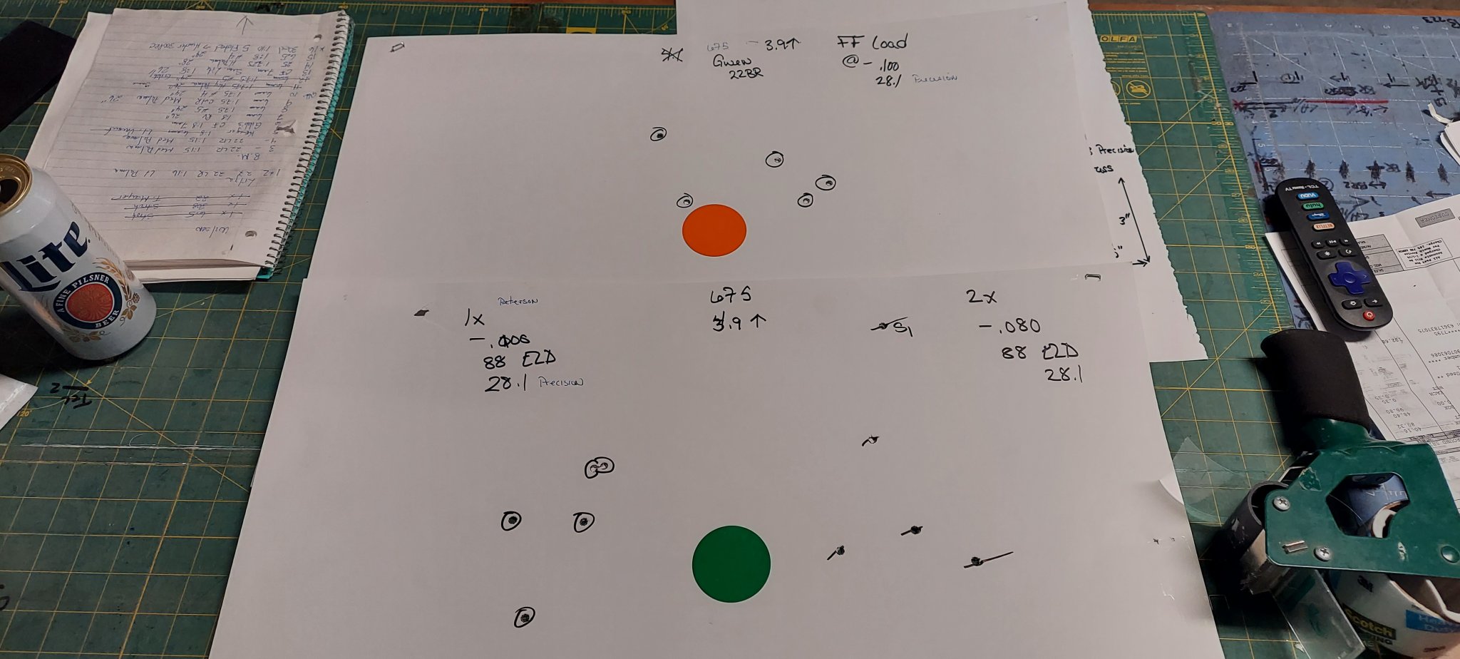

In defense of the 88s...
While not the greatest, many folks report better long range results with the Berger 85.5 and 90 SMK...
These are 15 rounds at 675. Shot as a string checking seating depth and brass differences.
24" bbl at 2915 fps.
They are all 1/2 moa.
I would look at your pressures and velocities.
This load is about the same as others velocities with this bullet at 26 or 27 inch bbls, with reported 3000 to 3050 velocities.
We have seen groups go to hell when we tried to push them harder.
FYI
This load has been shot in many PRS matches. Never missed due to the bullet. It will continue to be used.

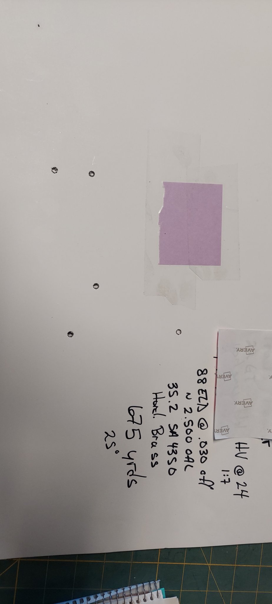

The OP was working on a 22GT.
Here is a 5 shot string to proof at 675 from a GT.
1:7 bbl
The lpad is equivilent to 36.2 of H4350.
24" bbl. Velocity on these was 3100.
Wind was 8 to 10
