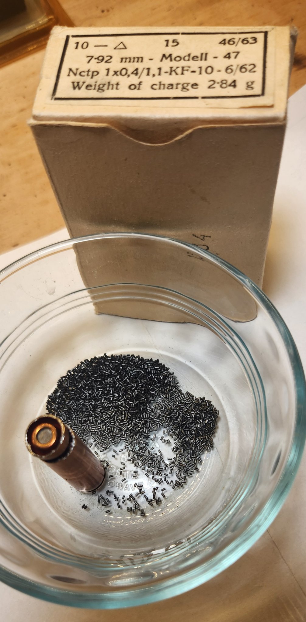

There was no pulling the bullet with pliers and a vice. So unable to fire the primer . I cut the head off. Dry stick powder with that sweet combloc chemical smell. The inside of the case and the bottom of the boat tail bullet is immaculate.

Well this was interesting. I know little to nothing about reloading. My buddy was able to conjure up 10 rounds for me that we fired at the range today. He noted that the powder contents per round was very inconsistent. Averaged about 42 grains with up to a 2-grain difference between all.

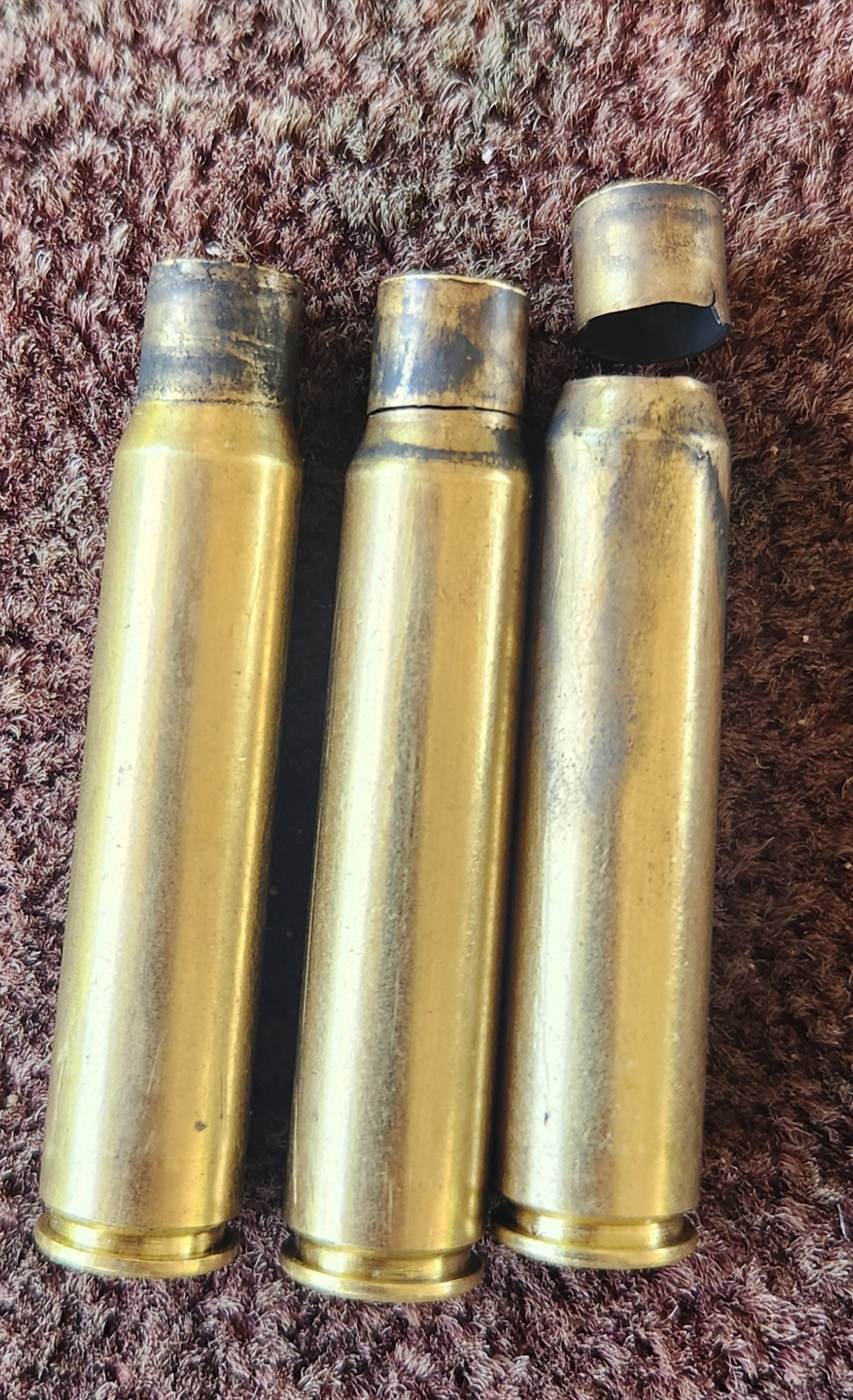

Anyway, here’s something interesting to have observed. He reloaded pulled bullets and powder into once-fired commercial PPU brass. We had one complete neck separation and several cracks along the base of the necks. The Bulgy bullets are magnetic as were the copper washed casings from which they were pulled. Might there have been something improper in his loads. Steel core bullets in brass a no-no?
BTW we did fire several of the original primed cases and they just sort of puffed some smoke with a sizzle. No actual pop/bangs. So, if there was some debate about whether the primers were bad vs. the powder it’s safe to say powder was fine and the primers are rotten/too week to ignite powder.
