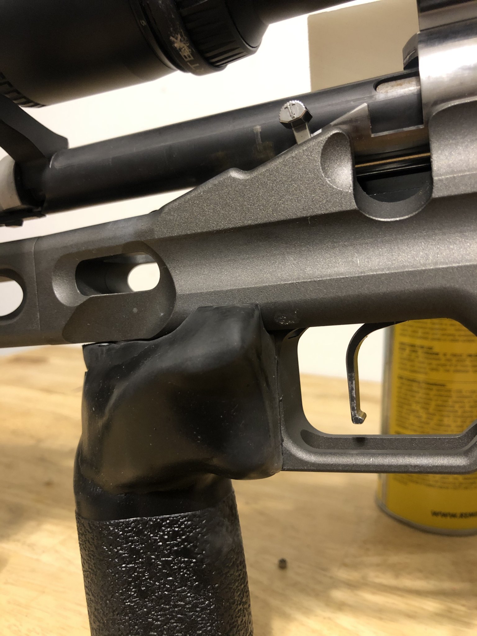

    My Manners PRS-TCS just arrived after ordering it 6.5 months ago and I noticed that it's difficult to get a 90 degree trigger pull. If I'm doing my proper FoM, then my trigger finger is too far back and angled. If I try to wrap my hand more to get my trigger finger closer, then now I'm not indexing on the pad, but the joint since my hand is so wrapped forward.
    I don't have small hands, average, but maybe it's just the course for Manners' stocks. I put 1/4" of foam on the grip and that made it a ton better.
    Anyone else encounter anything like this?
    Thanks!
    I haven't shot it yet, just checking for feel and comfort dry firing in the backyard. Keeping it pristine in case I'm going to just sell it.

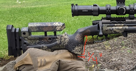

    My mantra ia get the rifle to fit you and ditch the less than optimal shooting position that compromises anything.
    Now, I understand there are all sorts of reasons not to modify the stock, or any gear. But, if it is gonna be your rifle, make it yours.
    That said, it has taken me a while to figure out exactly how to modify my McMillan, but its next on the list of projects.
