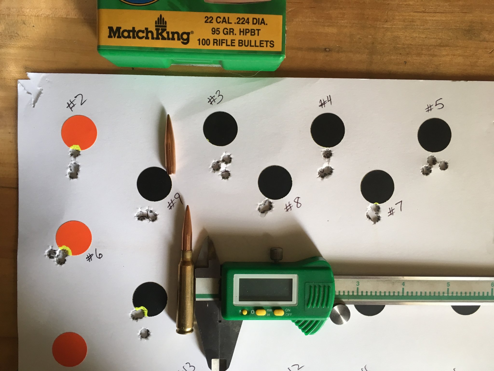

Im considering building a .224 prs rifle. Seems the 95gr smk would be the ticket with a super high BC and should easily hit 3200fps out of a 22bra, 22x47, or 22dasher. My question is sierra shows on the website that it needs at least a 6.5 twist so im assuming a 6-6.25 twist would about right. My question is would the bullet hold together at that rpm pushing them 3150-3200fps? Im assuming they would but curious who has experience with them.

I tried them in a couple of regular 22-250's... a 1in7 and 1in8. I didn't have any stability issues or any blowing up- but never got them to group very good. Both barrels shot great with 80g in the 1 in 7 and then 75 grain in the other. I gave up on the 95....
