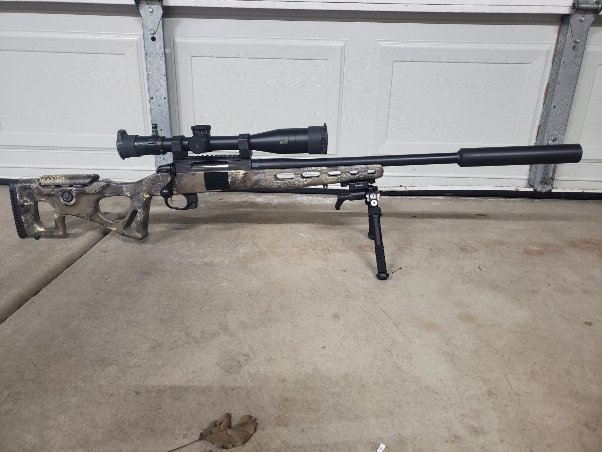

    Probably not fur friendly, but I need to try some in my 18" hunting rifle.

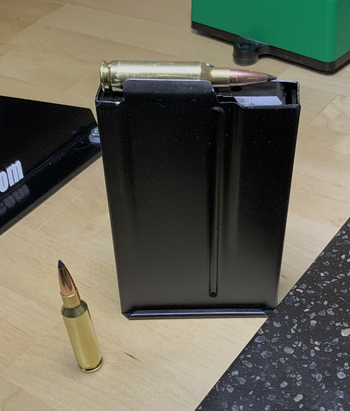

    Edit: here’s the COAL in an ACIS 10 round mag…
