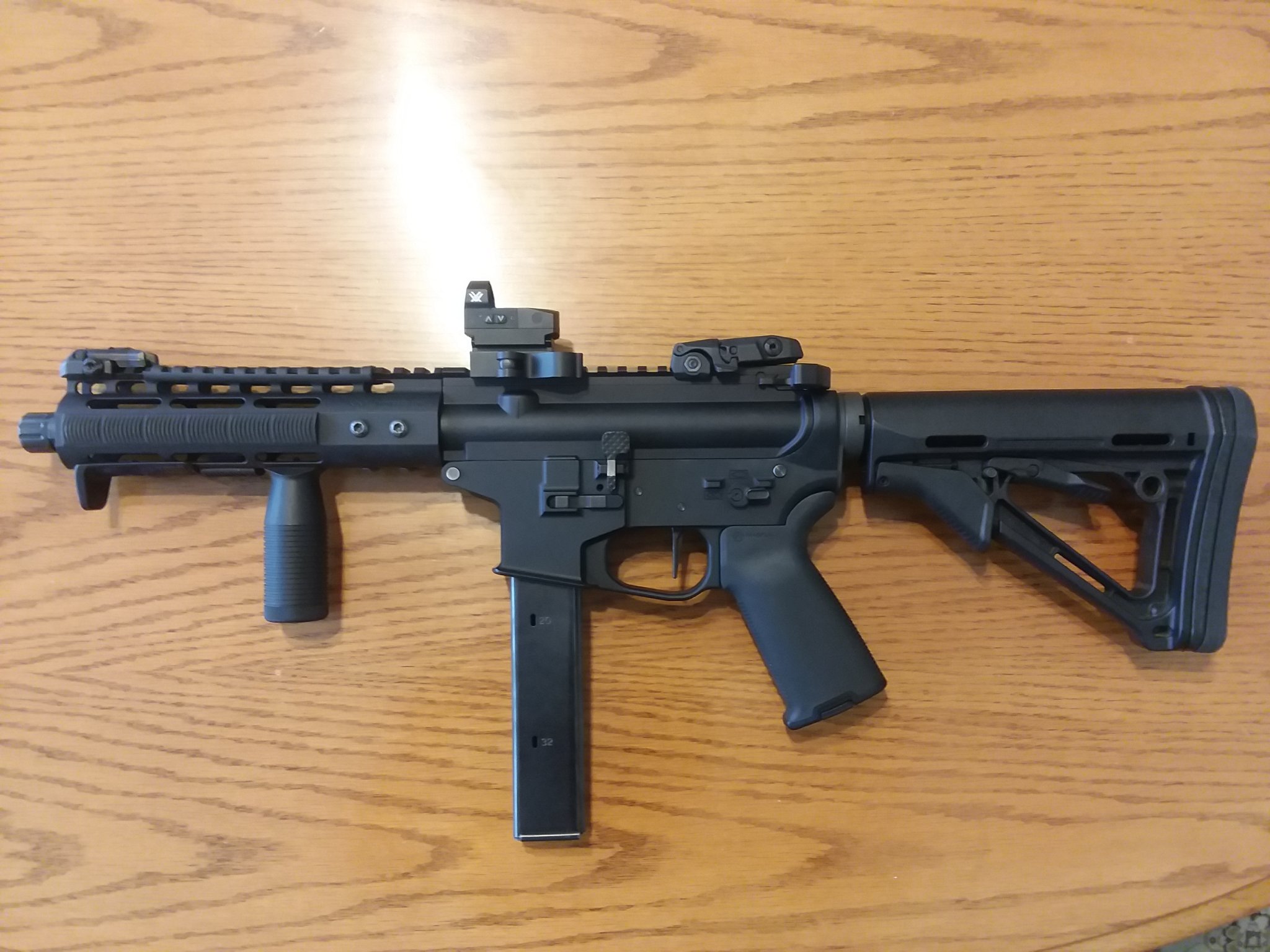

    In general the mag blocks fell out of favor as dedicated lowers simply increased the reliability of 9mm AR's with less tinkering. There are a few mag blocks out there that are pretty good but by and large the dedicated lower is going to be more reliable in the long run. Of those GLOCK pattern mags are preferred by a significant margin due to the availability, cost, aftermarket support and ease of loading (both bullets in and mag in gun). Whatever you end up going with I'd strongly recommend the bolt, spring, barrel and lower all be from 1 manufacturer to avoid compatibility issues. JP has silent captured springs for both the Maxim and Law stocks so you're good to use the JP bolt there. I like the MFT but pick whichever gets you going.

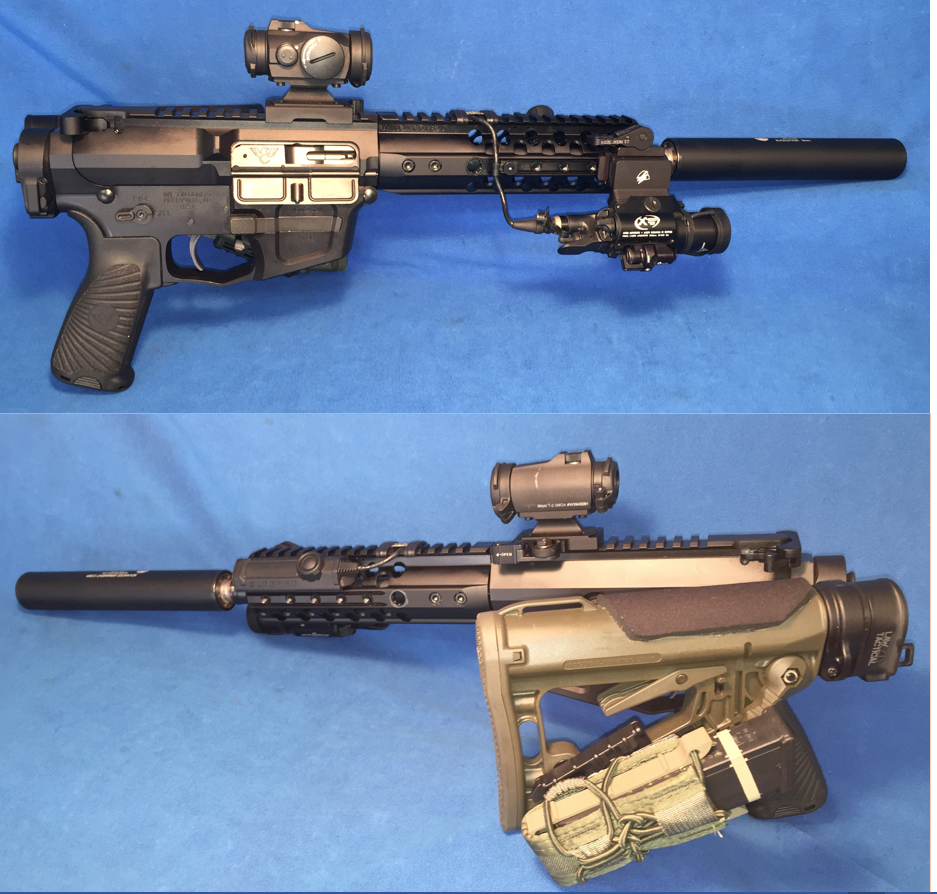

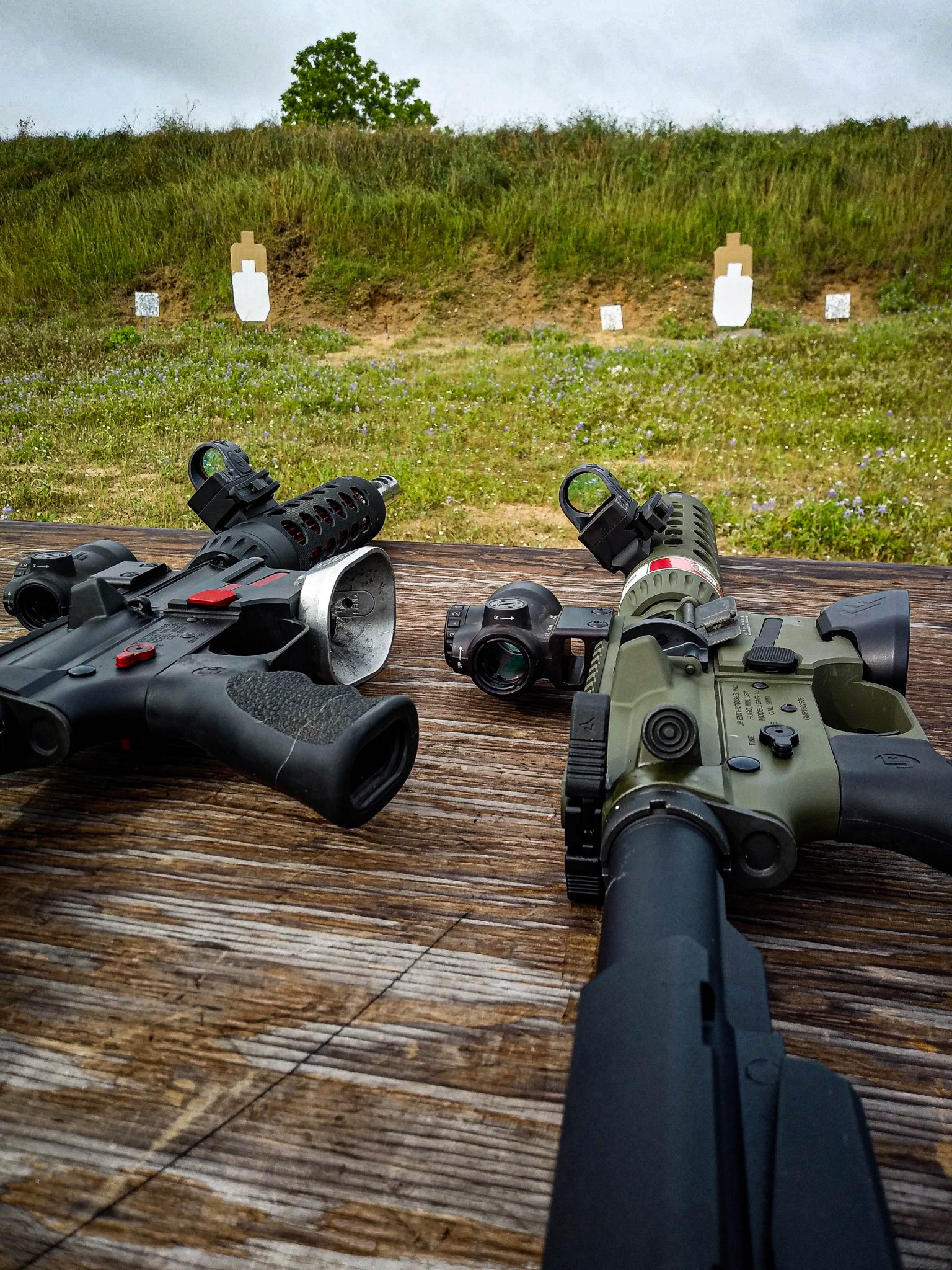

    Having said that, this is my suppressed SBR build that goes between suppressed configuration for night matches and other unsanctioned events to compensated for USPSA matches. Liked it so much I built a dedicated game gun twin. While I almost exclusively shoot games (matches), the reliability has been remarkable. We shot 4 people through a 250 round all steel match on the suppressed rig and it just kept on going. Between my 4 rifles I'm well over 150k rounds between practice, matches, loaning rifles out to other shooters.
    ^^^^^Sounds like he has about 150 times the experience I do. I built mine because I wanted a range toy, and the AR Stoner parts were stupid cheap for my birthday special pricing. I started with a mag block and quickly moved to a Tennessee arms poly lower, that cost less than the mag block. I had to file it in few place to make it fit, then bend the ejector on it a little. Now its runs without a hitch. I use glock mags. I don't own glock's, yuck. :poop: :p:ROFLMAO:

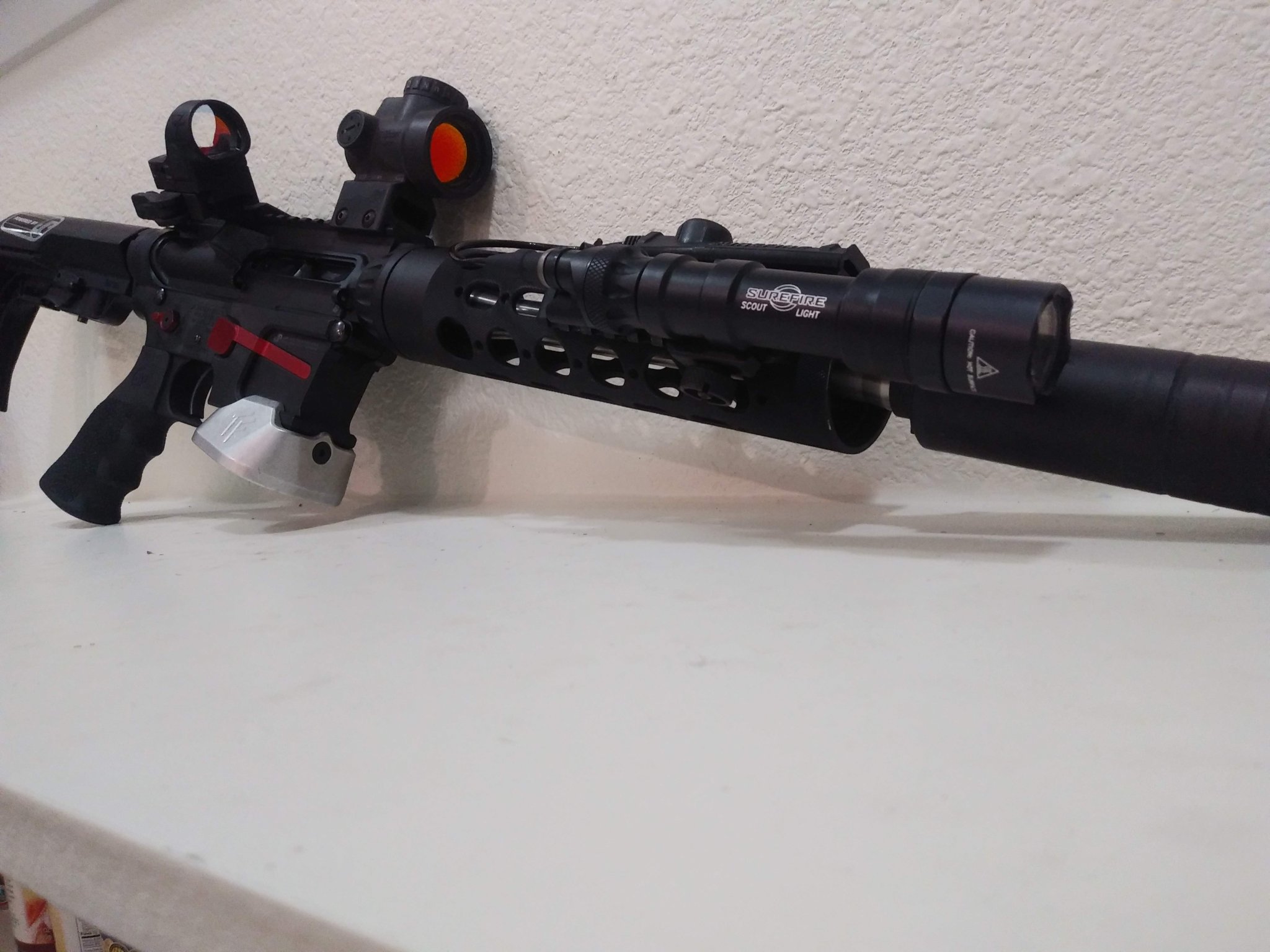

    Bad pic of mine:

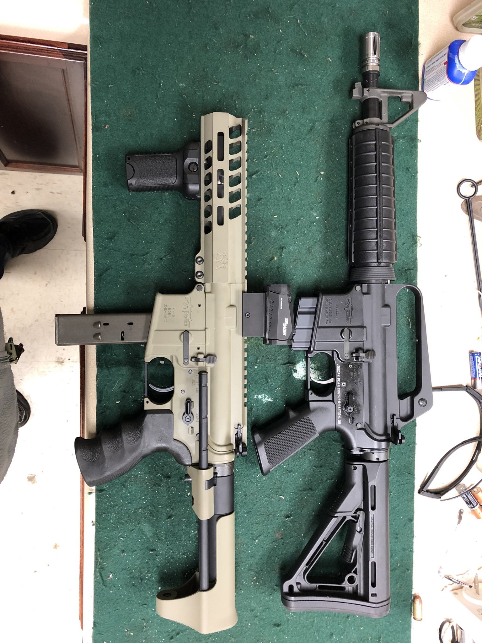

    I have a mix of parts on mine sort of. The lower and upper are CMMG and originally 9mm, my lower takes colt mags. The upper was form 1d and I changed the barrel to the 4.5 inch. I can’t remember but I wanna say it was an old colt barrel but maybe not. It has been 8 or so years since I built it. I used the Troy Airborne stock that goes on an standard 4/6 position collapsable tube. The handguards aren’t super expensive but the work really well for what I do with it which is range blaster. The range gun

    I have a mix of parts on mine sort of. The lower and upper are CMMG and originally 9mm, my lower takes colt mags. The upper was form 1d and I changed the barrel to the 4.5 inch. I can’t remember but I wanna say it was an old colt barrel but maybe not. It has been 8 or so years since I built it. I used the Troy Airborne stock that goes on an standard 4/6 position collapsable tube. The handguards aren’t super expensive but the work really well for what I do with it which is range blaster. The range gunView attachment 7367992
    That stock is the same size as the regular AR stock! The Maxim I have is a full two inches or more shorter and that's what I'm after on this one. A compact PDW style stock but if there's a lighter one that performs and functions like the Maxim, I'm all ears.

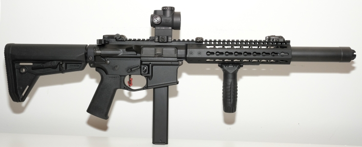

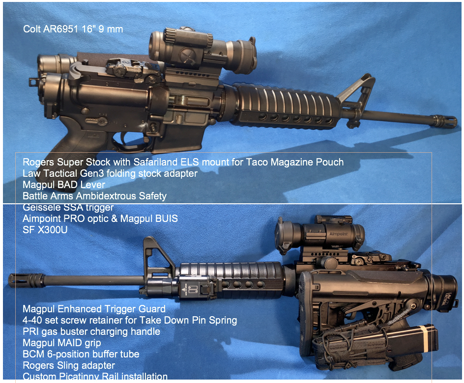

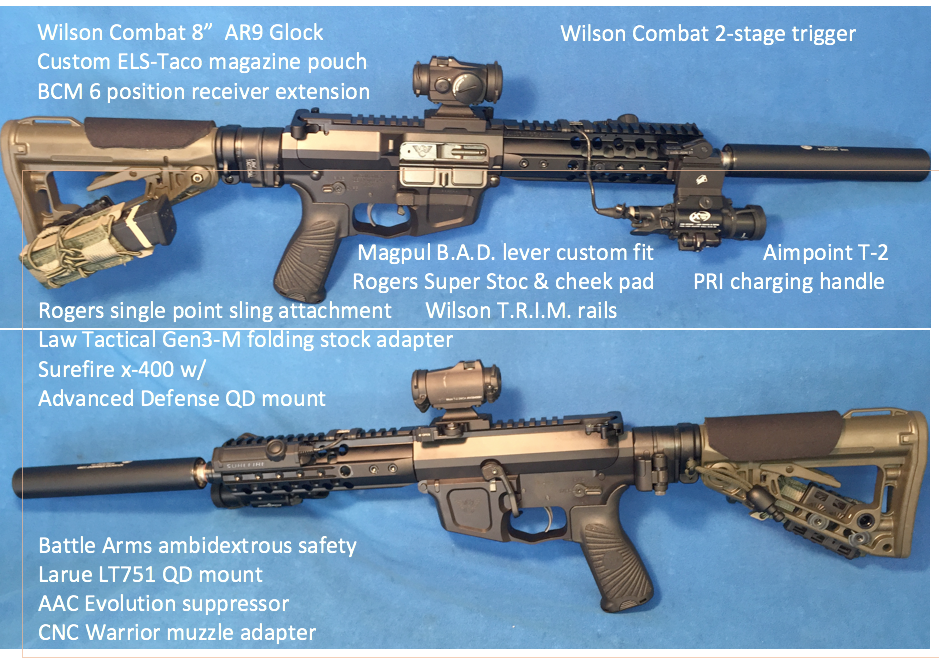

    Here are two of my 9 mm AR's. Both good enough to qualify for advanced rating at the elite Rogers Shooting School close quarters carbine course. The school uses the Colt 9mm with blocks. The 16" Colt 6951 is a dedicated 9mm steel magazine receiver. The Wilson Combat AR9G(glock based) I assembled as desired.
    Using a 9mm SBR suppressed is shooting a 16" rifle.

    I put together 2 9mm AR, 1 Colt mag and 1 Glock mag. Both 4" BBL and run well with no issues but I would recommend going Glock dedicated lower. 1 for glock mags and 2 for overall costs. I had a little concern about gas running suppressed so your concerns about gas holes may vary.
    The Colt was first and costs were unnecessarily higher. I went with a Hahn top insert. This alone cost more than my glock lower that came with a magazine release and bolt catch. On the Colt I went with a 8.5 oz buffer from heavy buffers.com (9mm-Q Buffer + Wolff XP Spring). This works real well but the weight of the pistol is noticeable. My basic buffer detent was bending forward later updated it with Leitner Wise thick steel one. I used a Colt brand 9mm upper as it had no gas tube or a FA. As for the mags it is fine with C Products mags. I did sand all of the followers sides prior to shooting them as it was suggested. Colt mag prices are much higher.
    For the unplanned Glock, a LGS had a their branded name on Glock lower and I went for it. This experiment I used the JP 9mm silent spring and happy with its weight savings and performance. I made the Glock a side charger with a Gibbs arms upper. This has a gas tube but its a threaded hole. I found a flat allen screw that plugged it up perfect. The fit and finish is great and hind sight I wished I had bought their matching lower.
    (No I don't run the optics this way. Just a pic I took after it was together and messed around with a spare)
    Also Lesson learned 3 lug sucks.
    I built mine using the Colt system, Metalform stick mags. Whichever barrel i've selected (multiple uppers), I've sent it to Rudy (Macon Armory) for his feed cone enhancement for improved feeding reliability. Some 9mm barrels are atrocious with their feed cone, e.g. straight beveled chamfer instead of a gentle radius. I use the Hahn dedicated block in a USGI mil-spec lower, that thing is rock solid, absolutely, pricey though, also provides last round bolt hold open. Gotta remember to use a 9mm-specific mag catch (RRA), the genuine Norgon has the requisite extra bite depth on the mag catch tooth. Trigger reset with non-USGI mil-spec triggers is an issue if you're not careful with bolt selection. You want the bolt with the extra speed bump on the bottom (pic below, front sample), that helps with trigger reset with non-USGI-style triggers, Geissele for instance, still some variance depending on which make/model. Otherwise you'll discover inconsistent trigger reset, if at all. I use the KNS Gen G pins, supposedly a little harder. I use the VLTOR A5 buffers in a standard M4 carbine buffer tube. the A5 buffer has the extra length that would otherwise be used with a spacer, or 9mm-specific extra-long buffer, while still retaining the reciprocating internal weights to minimize bolt bounce. Select the buffer weight for last round bolt hold open. check to minimize the distance between the bolt catch and the bolt face with the bolt fully retracted, use shims (e.g. quarters) to minimize. The heavy-ass bolt rebounding, if allowed a running start at the raised bolt catch, will snap it off, not the fault of the bolt catch, so you want to minimize that. When you choose your barrel, pay attention to the muzzle thread pattern used, e.g. 1/2-36, it varies by mfr, make sure it matches your chosen muzzle device, and make sure your MD has a big enough hole for 9mm bullets to pass through. If you're using the iconic gas deflector with the truncated ejection port door, then your upper doesn't need a brass deflector, so if you're choosy with your build, get a stripped upper that doesn't have a brass deflector, and doesn't have a forward assist, i.e. a specific 9mm AR upper. Doesn't need to have a gas tube hole either.
    JMHO, YMMV.

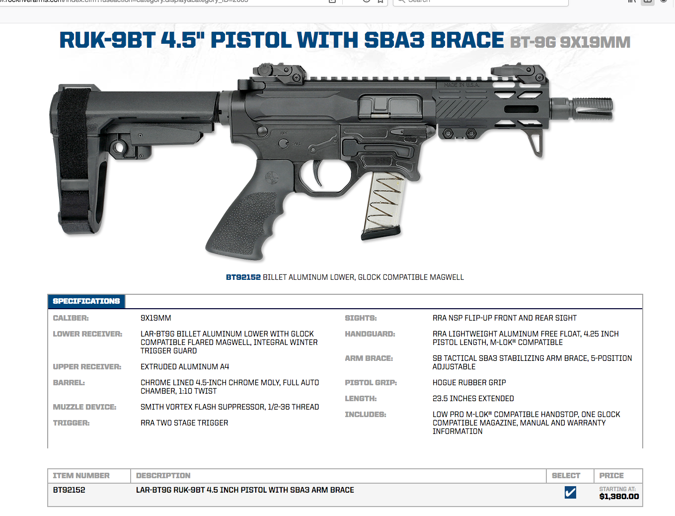

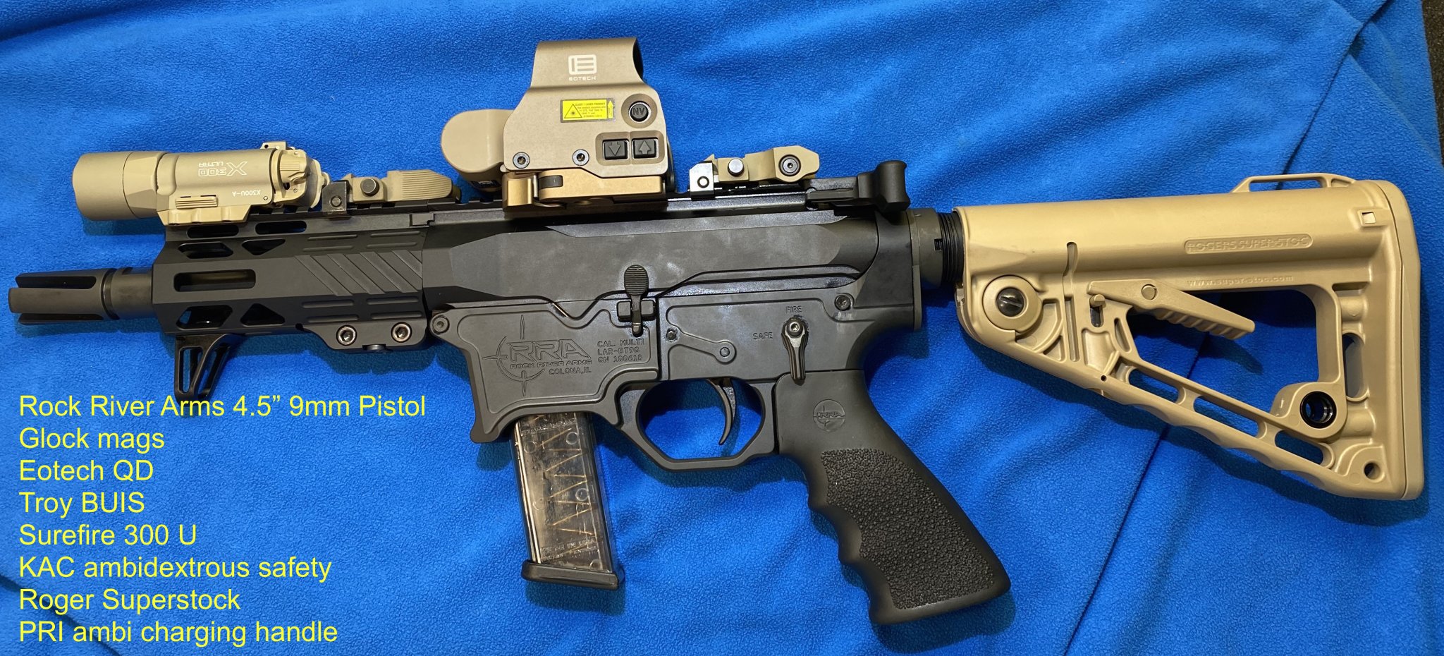

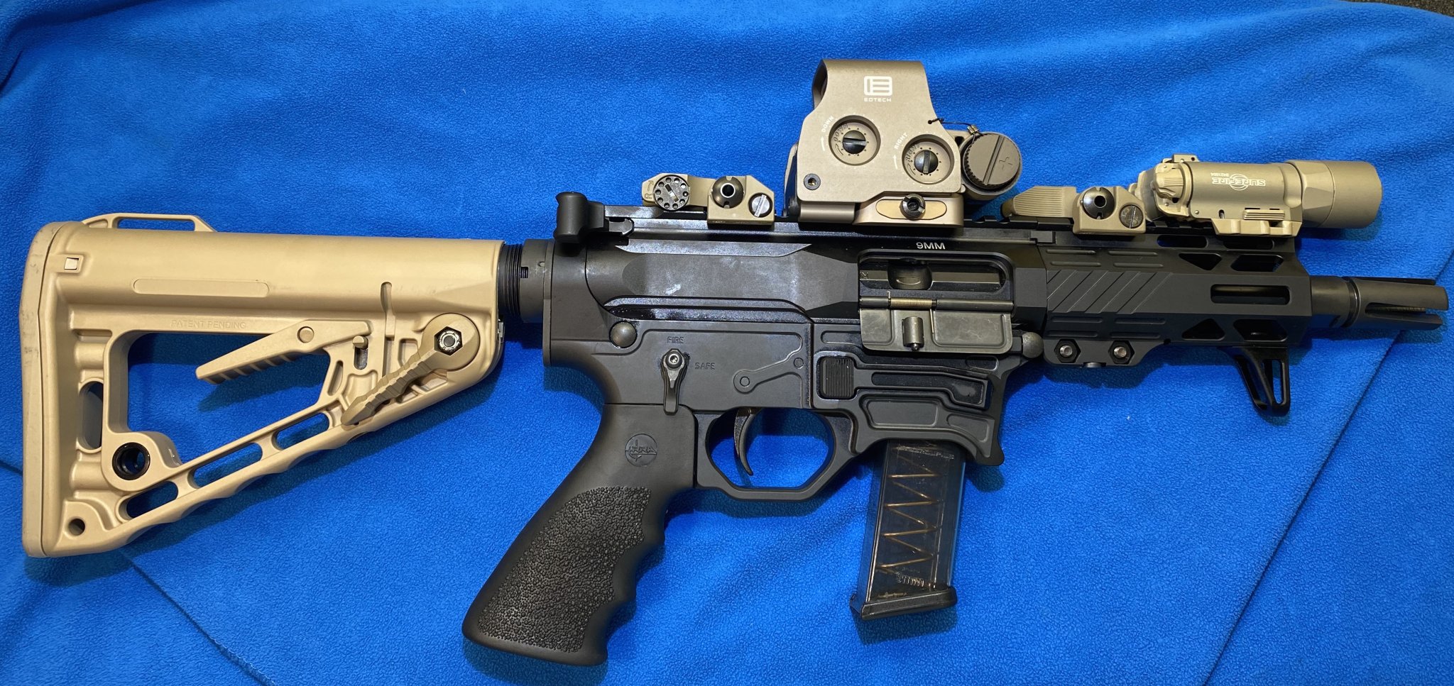

    Just put cobbled together this 4.5" 9mm Rock River Arms with upgrades. Single point sling and Law Tactical folding adapter to be installed.
    Off to the range tomorrow.
