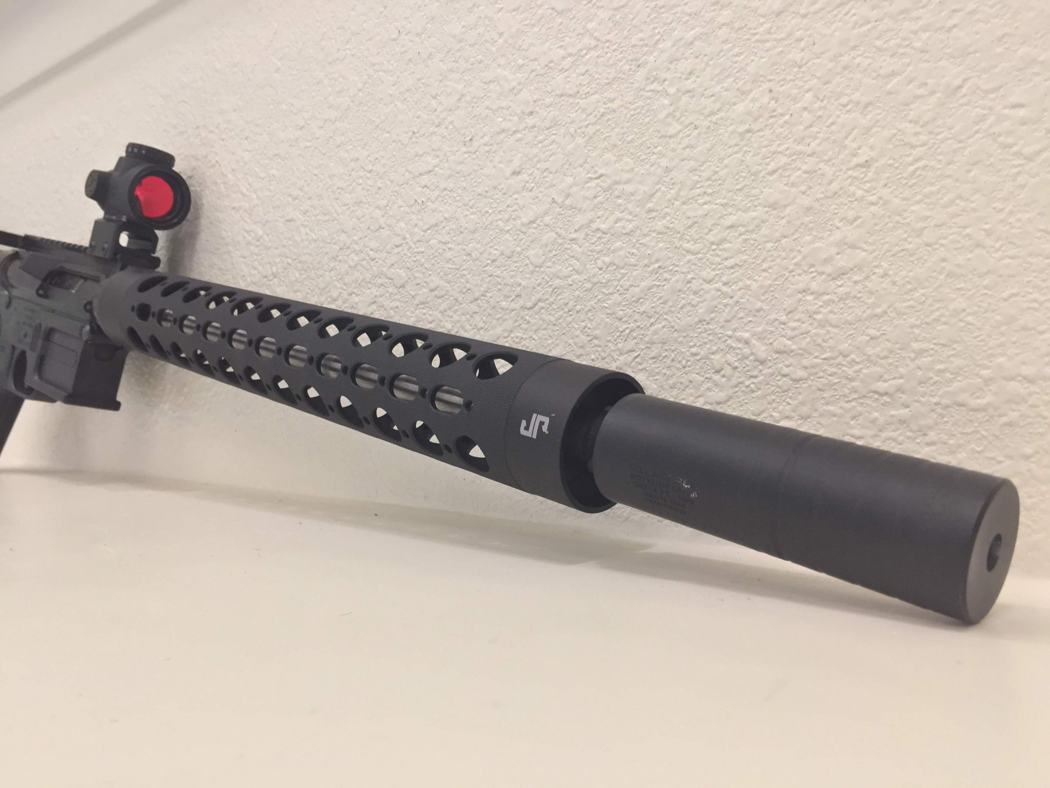

So, I have 2 JP GMR-13's with 40,000+ rounds on each of them. 1 is either a 16" barrel with a SiCo Omega 9K on it all the time and the other is a 14.5" pin/weld with the 3 port comp. I MD a local USPSA monthly match and a falling steel match that has a heavy PCC attendance. The 14.5" is a demo/loaner gun provided by JP for the latter of the 2 matches.
After 2 years of matches and being HEAVILY addicted to PCC, I have seen a LOT of builds / factory guns / clones etc go down. I've handed many shooters the demo / my spare personal JP GMR so they could finish the match when their gun went down. We ran 4 shooters back to back through a 250 round all steel match suppressed and the JP performed flawlessly.
If you want a project to build with your son, I would absolutely go with JP parts and I'd be happy to PM you a build list. A 14.5" pin and weld with a 3 port comp is the way to go if you don't have a suppressor, although PCC's are easily twice as fun with a can. If you're not married to that spare lower, the GMR-15 dedicated 9mm lower is a much more reliable long term option than a mag block. The GLOCK-brand-GLOCK mag compatibility is also absolutely the way to go in AR PCC's as mag reliability is just as important as the gun. I have 57, 47, 41, 36 and 33 round mags that are factory GLOCK tubes with no-fuss basepad additions. They work, period.
