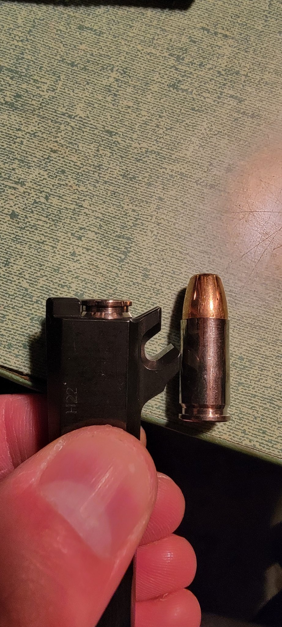

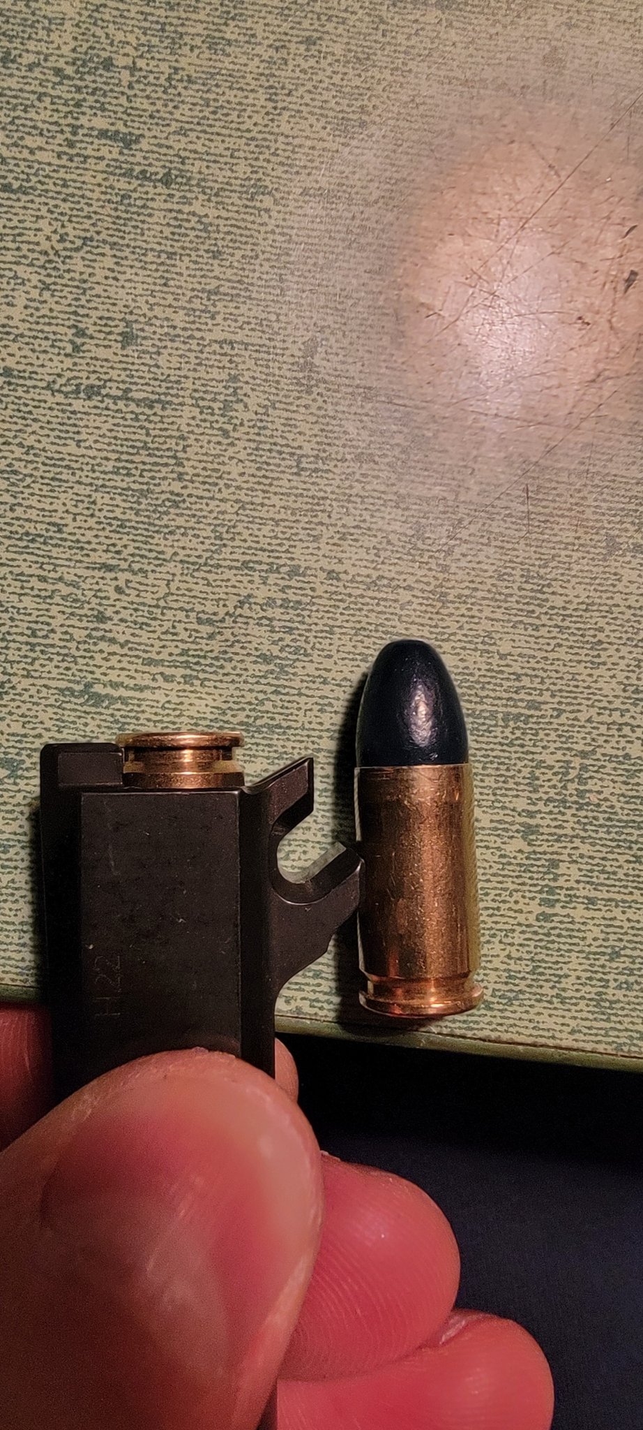

Loading up some rounds for my new Sig Macro, my first 9mm - 125 grain coated lead round nose bullets by Gallant bullets. I pulled load data from my hornady reloading manual for 124 grain round nose copper projectiles - 1.150" COAL & 4 to 5 grains of unique. As far as I understand it, lead vs copper bullets are essentially the same cat. No load data on Gallants website.
Went outside to test fire a couple and they won't chamber properly. Extracting them from the gun is a real chore - can't believe how badly they get stuck in there.
I've done a little trouble shooting and am coming to the conclusion that my COAL is too long. I tried bumping it down to 1.110" and it still will not chamber properly. See below photos where I'm comparing some HST factory loads to my 1.110" COAL reload.
Checking diameters between the two rounds, they are consistent within .002", so that shouldn't be the issue.
What COAL should I be using for these?
Thanks!
No one can really tell you what OAL to use, you need to keep seating deeper until the loaded round drop in and out of the chamber freely or called the clunk test. Each gun/barrel is different on how long the throat is and may require a different seating depth even with the same bullet.

This is just a guess, and it may be the light, but it looks like your crimp may be overboard. I've seen rounds get stuck like that before. IF you over crimp, that lead/brass has to go somewhere.

Needed to seat it deeper. Also had to back the crimp off until the proper seating depth was achieved. 1.130" worked. First time trying deeper seating I was too lazy to back the crimp off and kept seating the same round deeper. I knew it wasn't right to do, but thought I could get away with it.
When I started at the book specs, it was failing the plunk test and I thought it needed more crimp - so you're right, it was a heavy crimp initially. I backed that off after seating deeper. I never could get it to freely plunk in and out initially.
