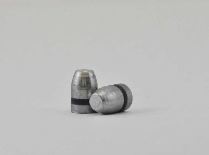

Want to load up some 9mm hardcast for woods defense. I prefer handloading, as I can load 300 of them and test them for function at a fraction of the cost of buying premanufactured ammo. 9mm is for my wife - not looking to get into a caliber debate.
Any good sources for wide meplat flat nose extra hard projectiles?

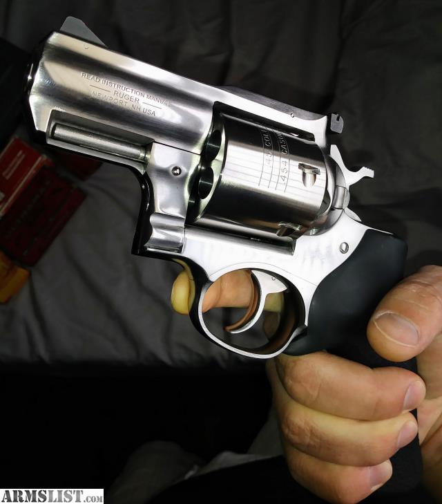

The 9mm Luger is not a rimmed design like a revolver. A revolver in this context will run with a heavy roll crimp and since those were revolvers with different characteristics than a semi, that was for both accuracy and to prevent having a wheel lock. Terminal ballistics is cold comfort if there is a failure to fire due to an ammo issue.
Enter the 9mm, and this is a headspace on the mouth round, not on the rim. So, most of the cast bullets for a 9mm will not look like a typical Keith that has the large diameter sharp flat nose and crimp grooves. If a 9mm bullet starts down the road of trying to run something more than a truncated cone, there is the danger of a set-back due to sharp hardcast corners catching on ramps. When this happens, it raises pressure or causes jams. That is a long winded way of telling you that feed reliability in a 9mm is one reason you don't encounter much of what you are wanting to hear.

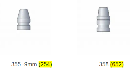

If you go down this road you will take on lots of testing to learn why the semi-autos run either a large radius or at most a truncated cone with a wadcutter diameter well behind it. Functional reliability and safety against set-back is the main reason. Lots of work goes into defensive hollow point designs to insure the nose doesn't create jams or set-back. The hollow points for hunting and defense and the hardcast hunting designs that work in revolvers are not the same as the ones that work in semi.
For example. On the left is truncated cone for a 9mm, on the right is for a revolver. These are not the same performance but you can get pretty close to what you are asking for and cast and PC coat them yourself, but you will have to work out the seating depth for reliability.

That said, to be of help we need to find his requested 147 grain hardcast flat nose bullet and let him make up his own mind.
This is what he is searching to clone....

Buy some cast for a 38 Super, you can get much heavier projectiles. Then use Vihta Vouri 3N38. I can load 147g to 1,190fps using tht powder. Using 38 Super cast you can get 160g bullets.

Rimrock “Outdoorsman” 148grn. is where I’d be.
Been meaning to either grab some of them or just get one of the new Lee 147 molds (I cast as well).

Rimrock provided the bullets to Buffalo Bore, and it’s not hard to replicate Buffalo Bore ballistics.

It's a sweet looking revolver but that giant read the manual on the side of the barrel is a bit wtf.
🤣 🤣 Didn’t see that! Grabbed a pic off the web for the post out of laziness and didn’t see that. Mine is blank on that side of the barrel - no safety warnings on it. The pic must be a new “safer” model. That is very WTF!
