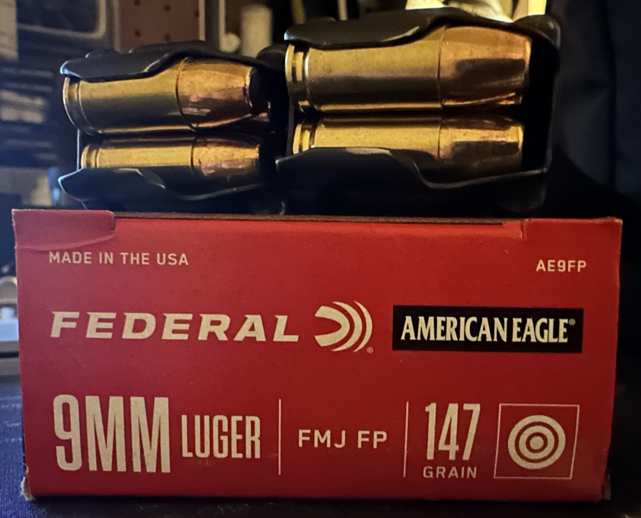

Factory Federal American Eagle 147gr. Flat Point Subsonics through my MP5 @ 100 yards... It even start putting down some consistent hits at 200 yards once I found my POA with the irons. I'm very impressed with the consistency for pistol ammo.

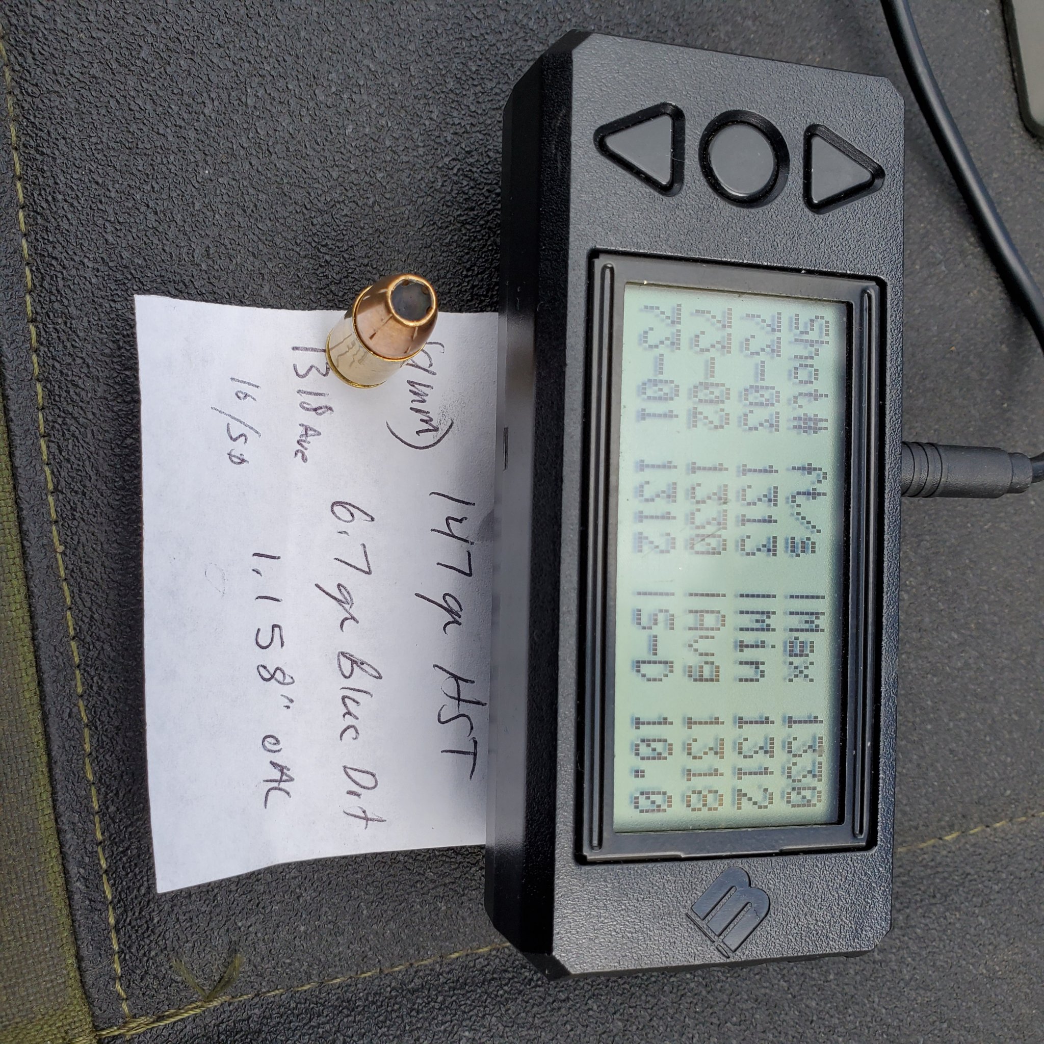

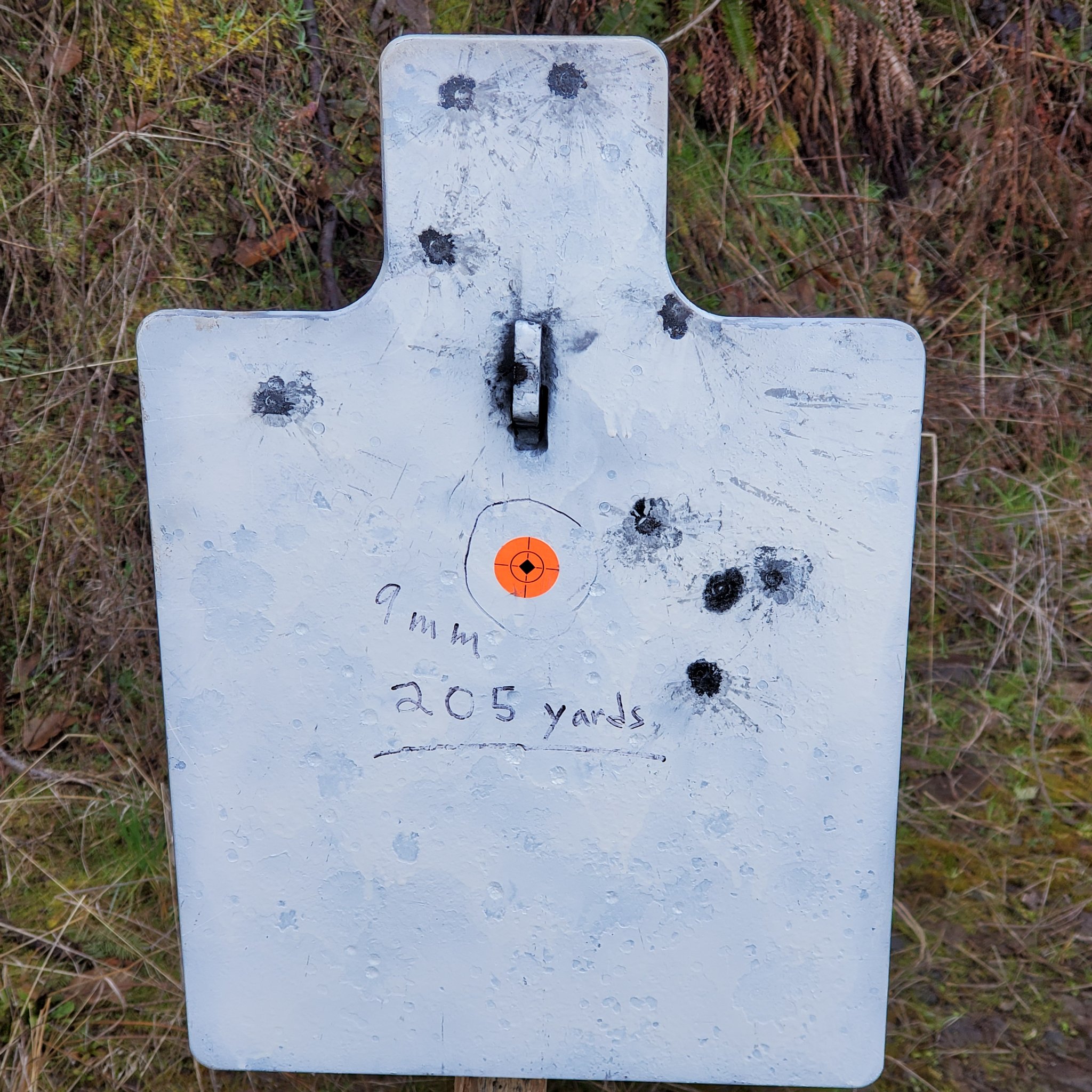

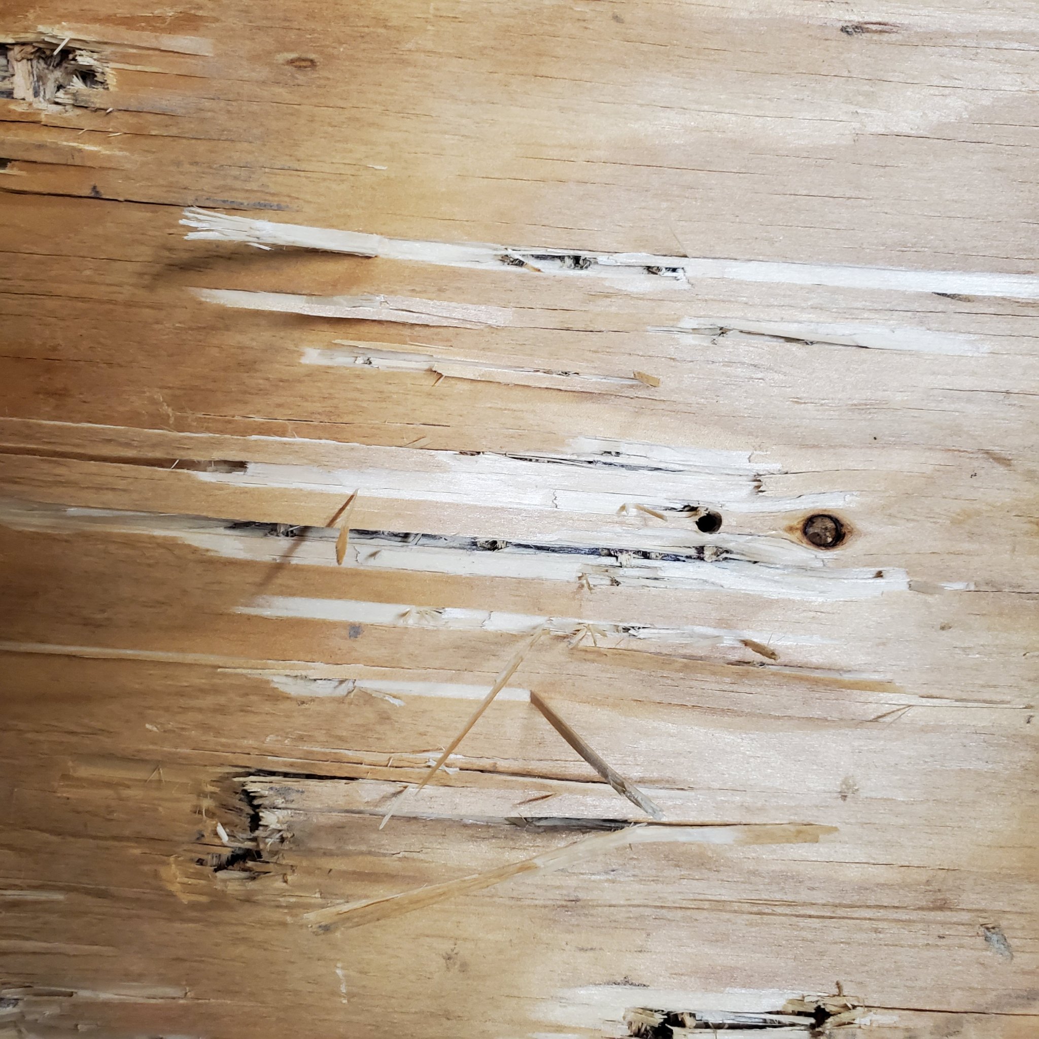

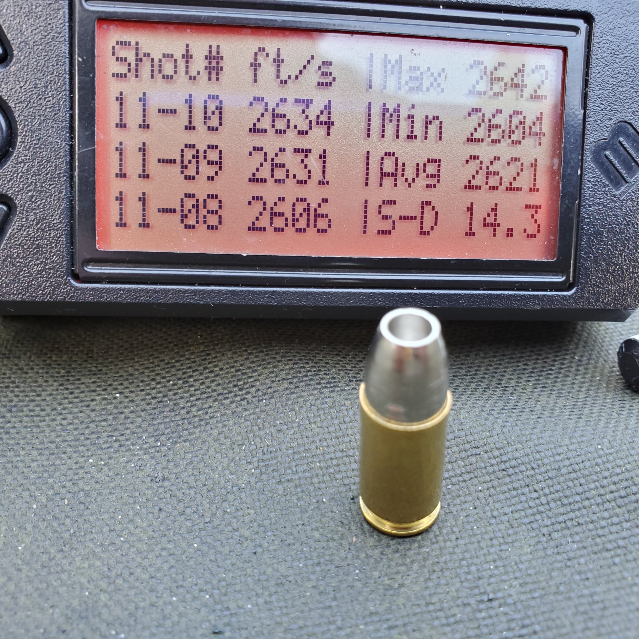

AR 15 9mm over 2600 fps, 75 gr 1900 fps, 115 gr 1720 fps, 124gr 1600 fps.
Bullets from 50 gr to 185 gr tried.
Glock 26 with 7 1/2 shot load penetrates 1/2" plywood 6 feet ...
AR 15 9mm all 10 shots on target at 205 yds.
I run plus p in AR 15 with excellent results,
Sometimes 1" 3 shot groups at 100 yds.
And over 700 ft/lbs of energy. Bumps the performance up alot to 357 mag performance...9mm a deer cartridge in carbine form with handloads?

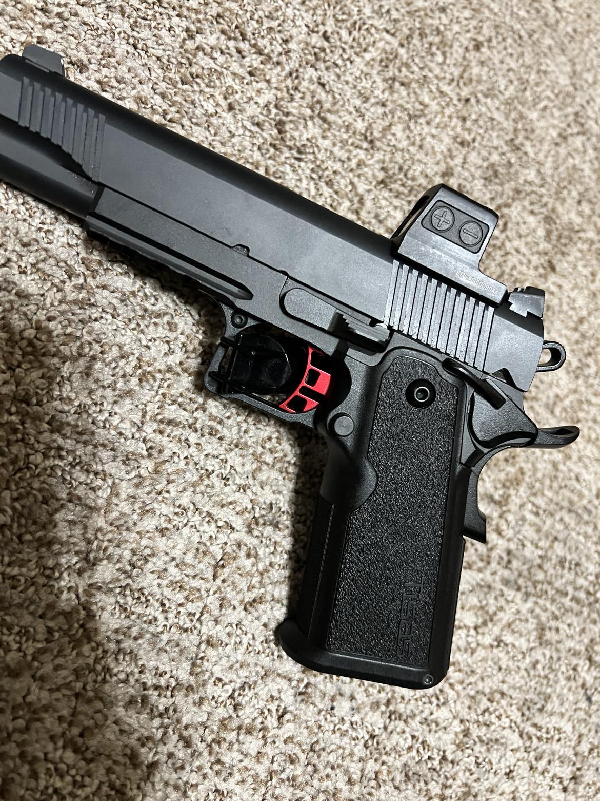

Zero 124gr JHP
4grs Titegroup
WSP
1.120” coal
New Starline brass
1050 FPS and shoots inside of a dime from my Staccato P at 15 yards

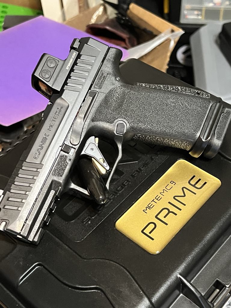

115XTP
4.3grs Titegroup
WSP
1.100” coal
New Starline brass
1160 FPS, same accuracy.

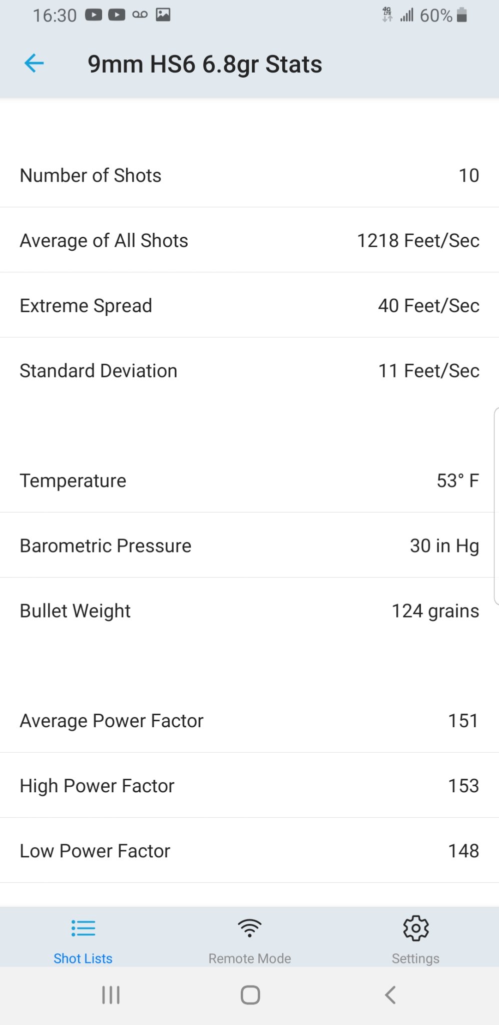

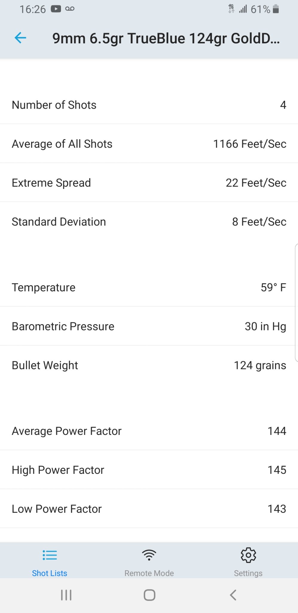

I like a 124gr GoldDot over 6.5gr of Ramshot TrueBlue with a cci primer.
A very accurate load too. These were out of a cz p-01, theyre a little hotter out of my g17.
Another nice load is 6.8gr of hs-6, same bullet and primer. Not as good with the sd and es but acceptable.

These are my standard and +p loads respectively trying to mimic Speers own stated velocities. I very rarely realize the factory velocities with factory ammo with any of them except for Underwood.
My bullets are pulled bullets so my cost to load 500 of these is a fraction of what 500 would cost retail so not a bad deal at all.
I dont take them to the range and just blast 500 gold dots but I do like to use them to be used to their performance. No knock on Speer but my handloads perform better. Most of them are loaded in 1x Speer Ni brass too.
