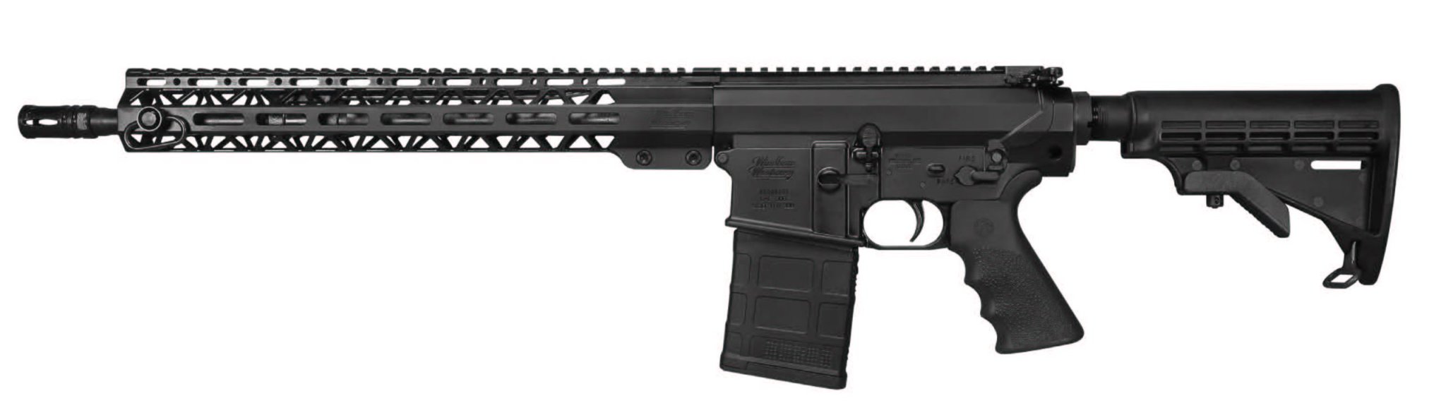

I don't have much experience to offer but my own. I have the Windham Weaponry R16SFST-308.
This has a 4150M chromed moly barrel with a fixed mid-length gas tube. I never fired it in this original carabine config. I switched to a rifle tube and the Magpul PRS Gen III adujustable stock. Long story short, I had to mix and match weights in my buffer and got up to 6.1 ounces to run it right with 168 gr HPBT.
