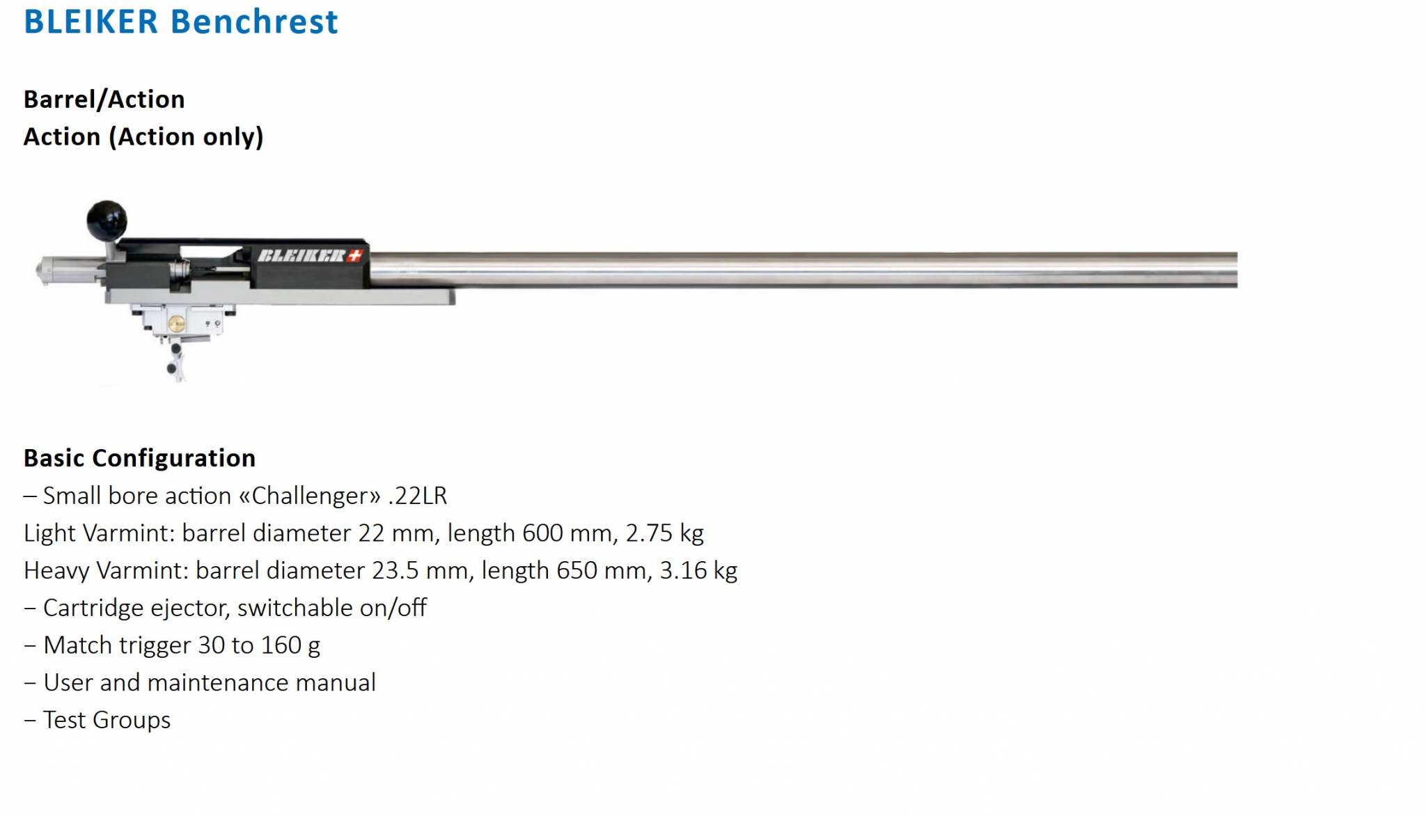

Although I'm also looking at Stiller action, this one below could be an option as well, but probably only the action. No reason to ship a Lilja barrel to Bleiker to have it shipped back to me:
I already have PRS and a NRL rifles. I want a bench rest rimfire and maybe a rimfire f-class as well
Gotcha, I’ll though about dabbling in building bench rest rig but it’s definitely a whole other level of precision and pricing.

Short bolt actions like the Bleiker are not aimed at benchrest, PRS or even F-Class type shooting. They are for coat and sling shooters that dont want to break position to load another round. Unless you have long arms, that short bolt is a huge advantage.
If you look at rimfire bench rest equipment Mullerworks and Shilen barrels seem to dominate.
Yes, along with 2500x and Turbo actions. If there was a more accurate combination it would dominate UL benchrest. No one is more serious about 22 accuracy than these guys. Bleiker actions don't cut it in UL benchrest.

Having imported a few Bleikers for some Olympic shooters and hearing some feed back, they’re not magical. The last 3 we brought in, the customer ordered I believe 6 total barrels so they could find the best one.
Of all the aftermarket barrels we’ve installed on rifles, performance wise they go in this order: Benchmark 2 groove, Benchmark 3 groove, Kreiger, Shilen, and finally Lilja. I have a Bartlein gain twist to install for a guy but haven’t gotten it installed yet.
Olympic shooters really don’t know much at all about the inner workings of the rifles. They are hard as shit on their stuff and hand it off to someone else when it’s not acting right.
