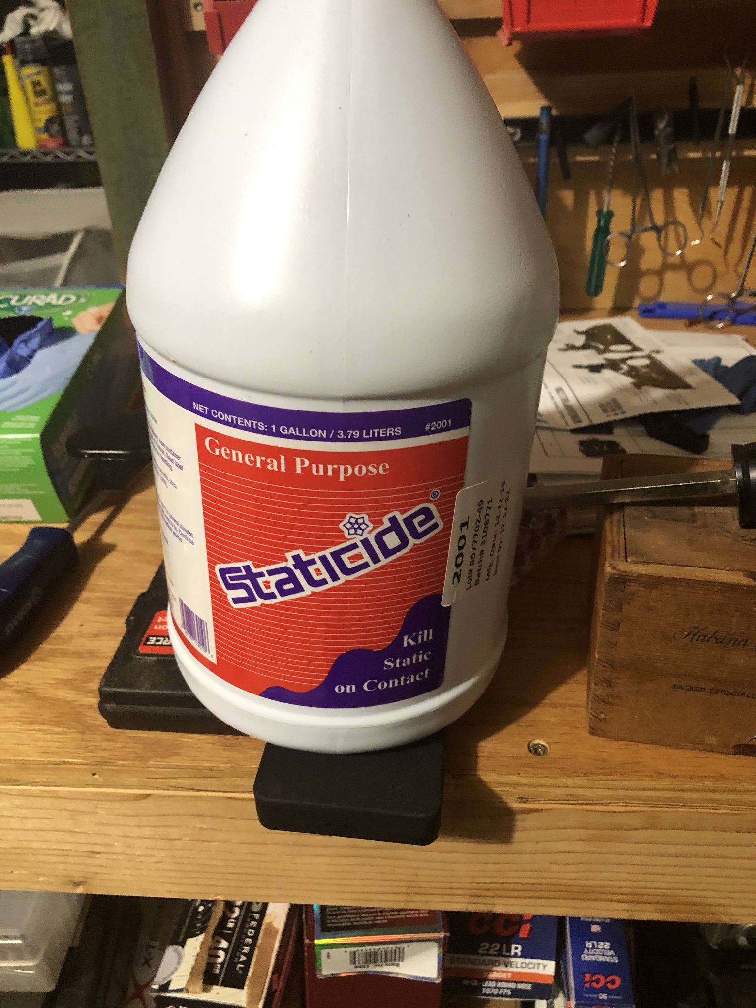

no fluorescent lights in the area so that’s not the issue and I don’t think static was the issue. I’m go to see if I can find a nice isolated spot in the garage and test it there. I also ordered an anti static mat with ground I can set it on

So I was playing around Having moved it I. Side it stabilized perfectly.
So what was the issue magnetic field, static, air currents or temperature.
So I moved it back to the garage but inside an enclosure. The enclosure is a high density polymer. I wiped down all surfaces with a commercial tread anti static solution. I’m using the same UPS I used indoors. The scale is on an anti static mat and the scale is grounded to the mat.
temperature is 88* and humidity still at 50%
no fans and air current is stable and the unit is shielded on 5 sides.
I’m thinking it’s just the operating temperature.
anyone have success running this unit in an area that is hot?

Used my FX-120i yesterday at 87 F, zero issues.
You have a ton of plastic around scale. I realize you wiped with staticide but I suspect that is root cause; too much plastic that is generating a charge.
When you moved scale inside, how much plastic from garage went inside also?
