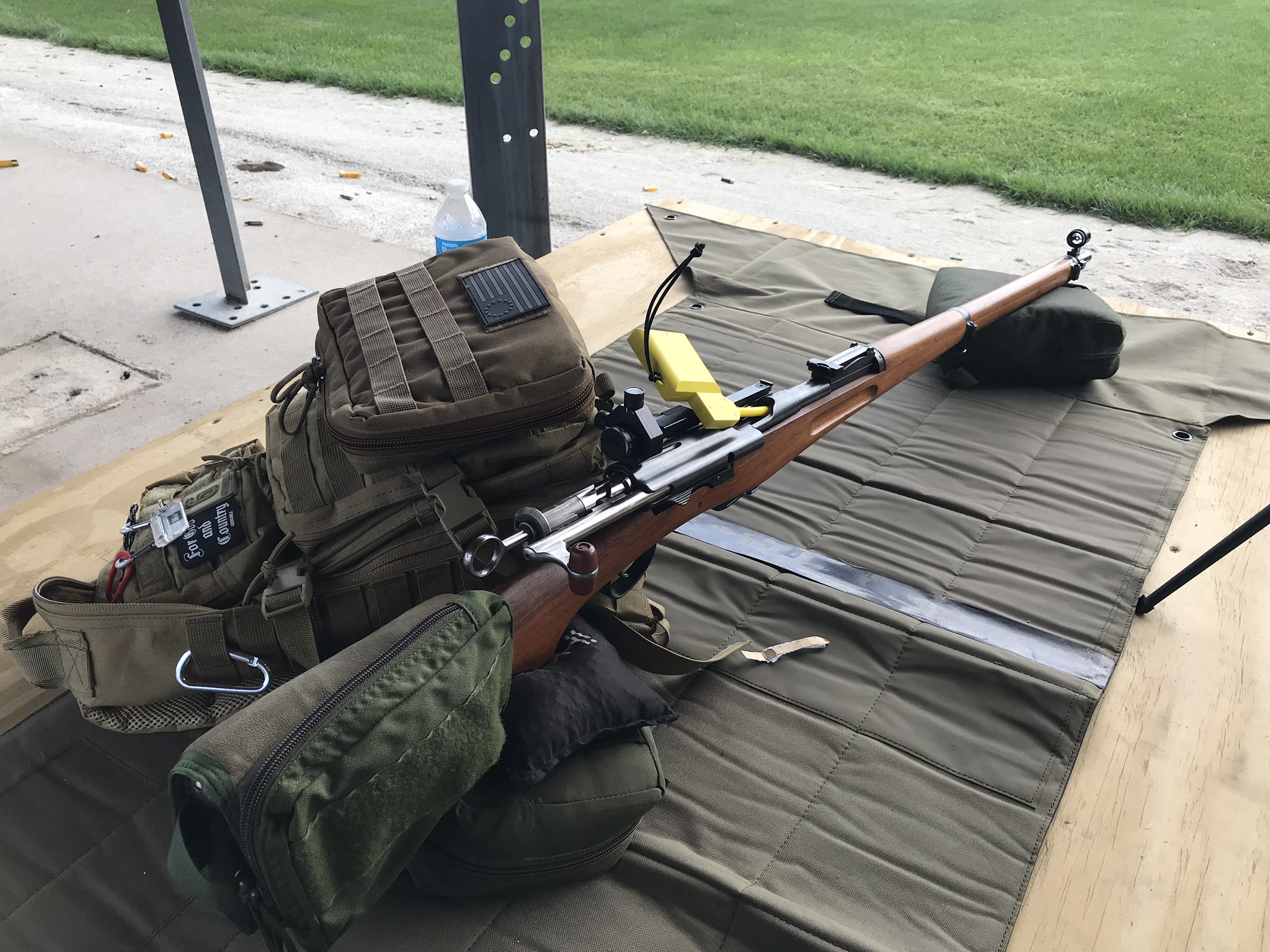

As posted in a different thread, I obtained a diopter sight for my Swiss G11/1911 from Swiss Products. I mounted it up yesterday, bore sighted it using the “DANGER!” sticker on the transformer box in the backyard, and took it for a range trip this morning.
Now I was born a nearsighted Polish kid, am now a 56yr old farsighted Polish kid. I’m not an optometrist, and barely passed physics in high school. I have absolutely ZERO clue on how this all works...but I’m sold.

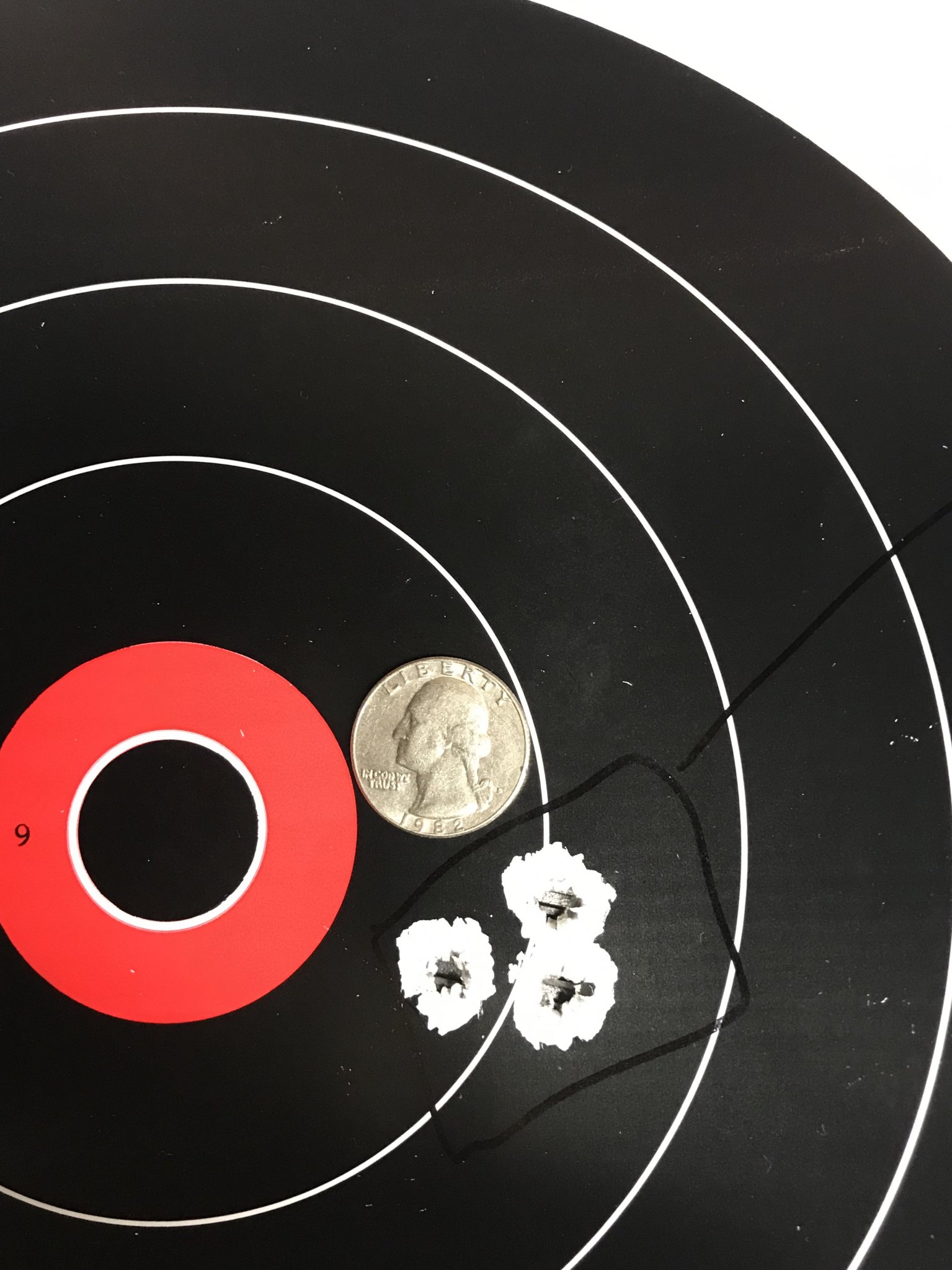

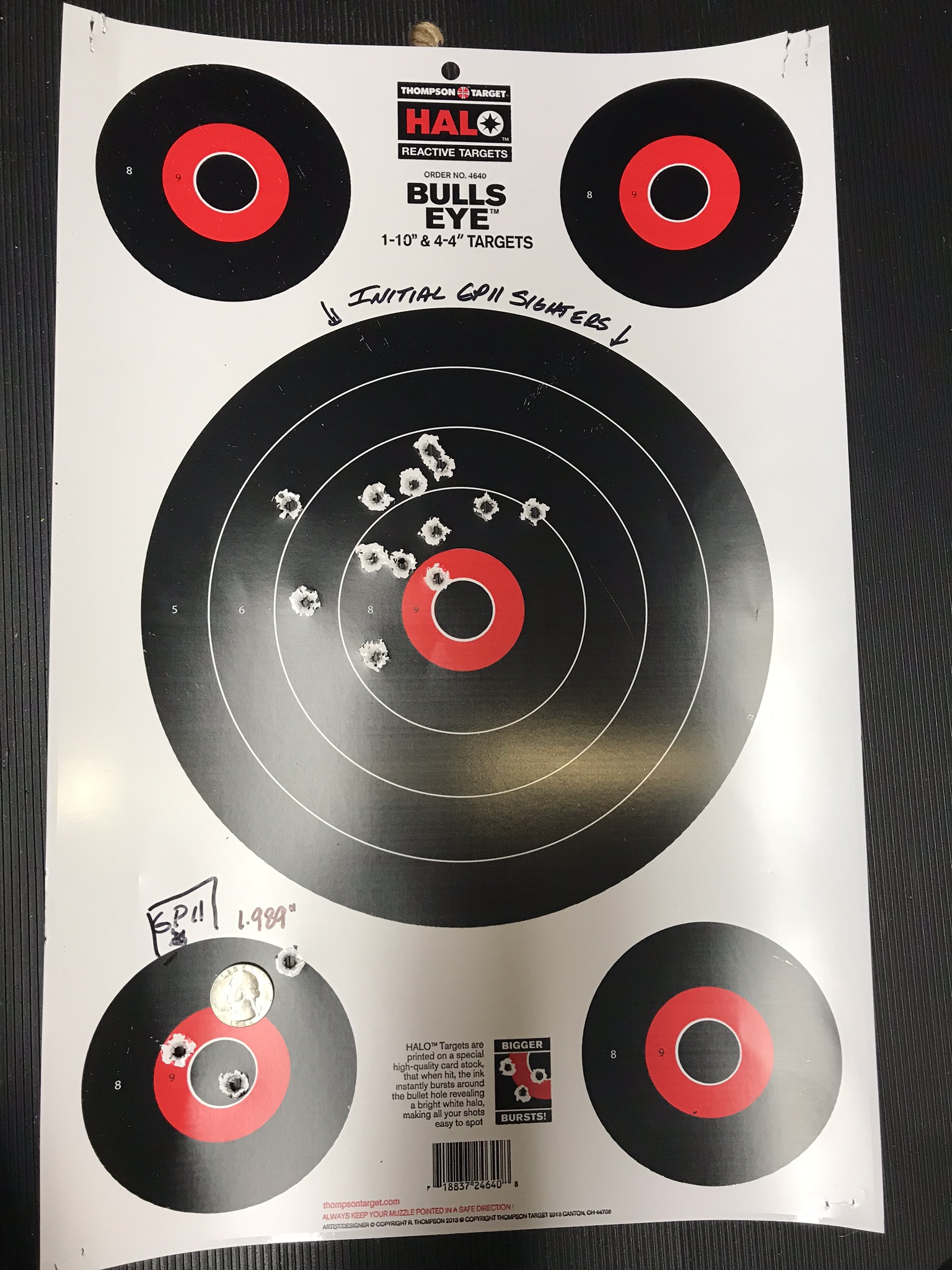

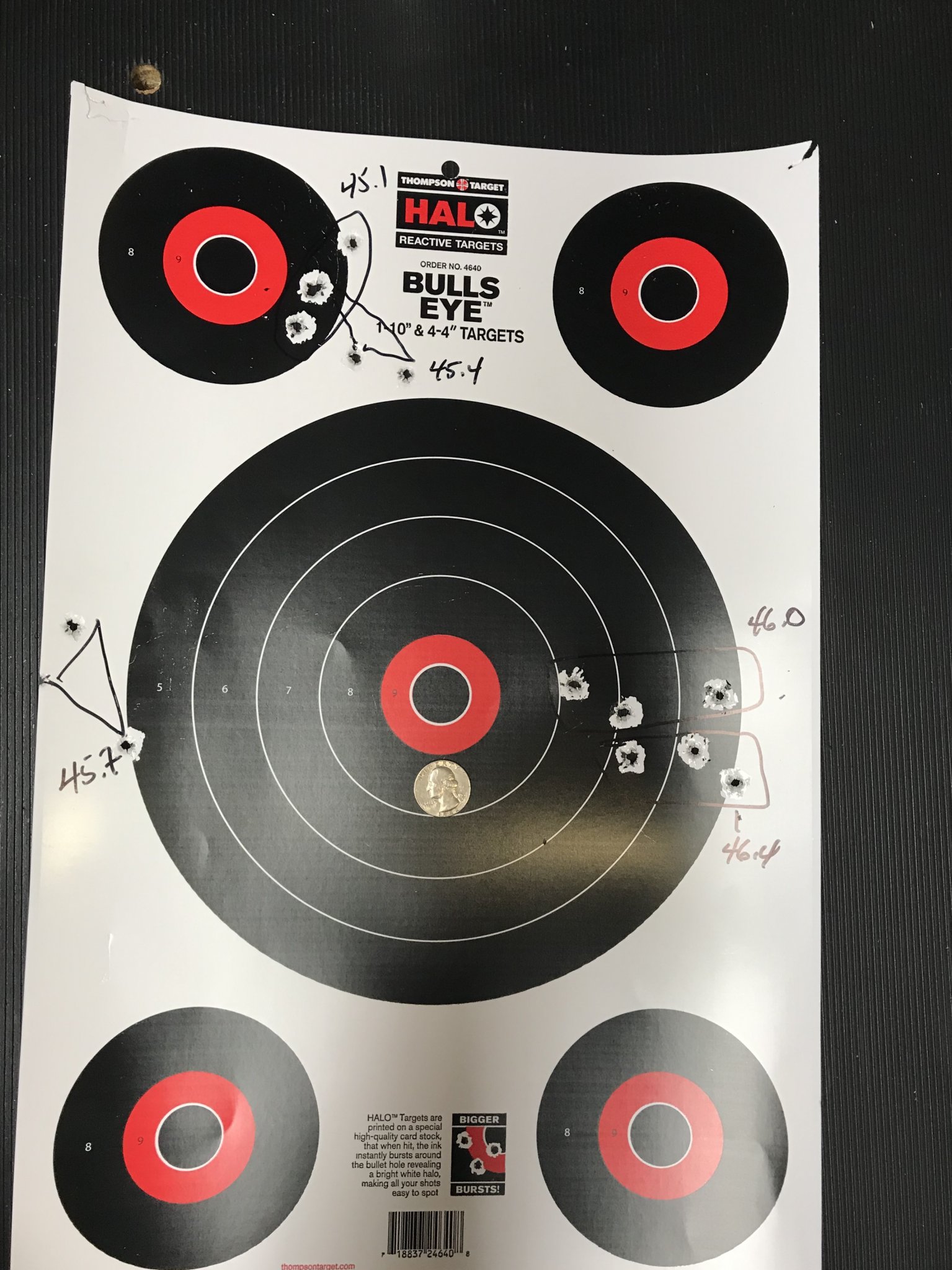

To say I’m pleased with the sights and the results would be an understatement. After a few rounds to zero the sight (OK...like a dozen) I shot a few groups with the GP11. As you see in the pics, it ran about 1 3/4” at 100yds. Not too bad. The results from my handloads were a bit better with one VERY nice group at 44.8gr. None of them are hotrods traveling about 2275fps. The GP11 clocked at about 2600fps. No mind, if it’s accurate, I’m happy. A bit more experimenting around that node is in order.

So there ya go. Not bad for a gun made in 1916. Thanks to zfk55sr for the advice, assistance, and great product. My apologizes for the less than optimum target pics. Some of the loads I used the main large bull. When that space ran out (and I began to loose track of what hits were what) I transitioned to the smaller bullseyes and let the groups fall wherever. In general, the 165s were hitting about 8” above where I had sighted in with the GP11. The rqnge was busy today, and I had to do what I had to do to finish it up.
