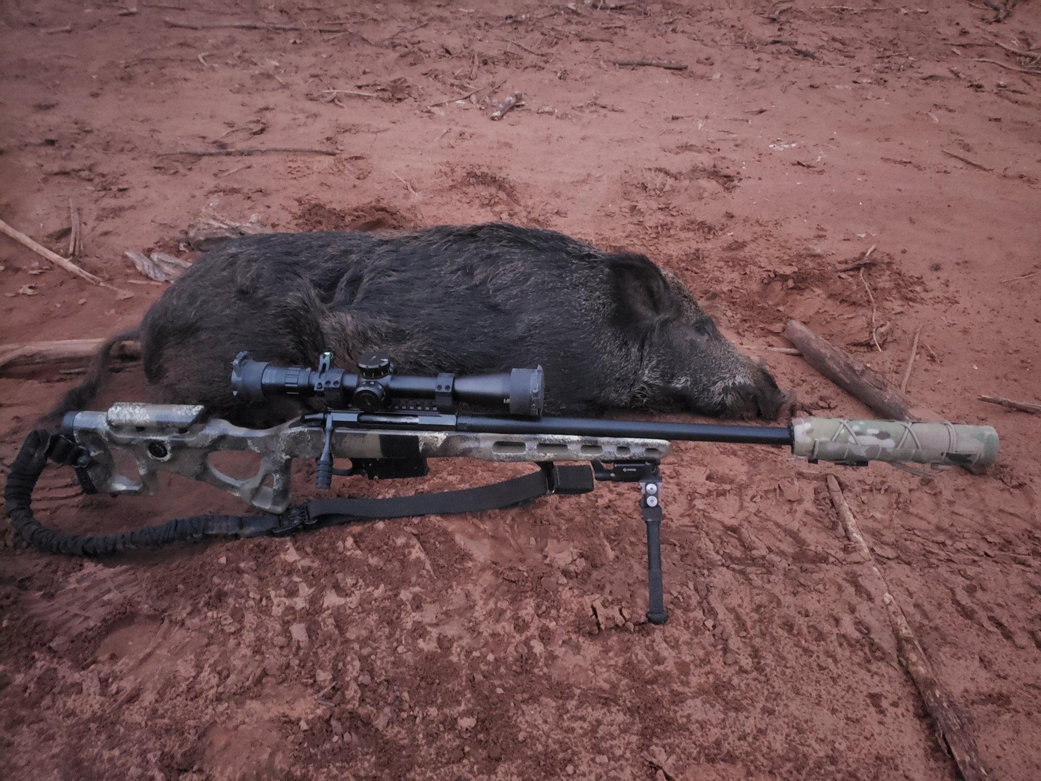

I kind of tripped into this setup below, 16.5in 6.5cm, never really intended on the parts falling the way they did, but it is SUPER fun to shoot at 100 and 1000yds, and everything inbetween:
AmmoManufacturer16in BBL - Avg FPS16in BBL - SD16in BBL ES
140gr BTHPHornaday (American Gunner) (cold barrel)248315.148
130gr HPBTPrime (warm/hot barrel)262619.658
130gr HPBTPrime (warm/hot barrel)260114.648
120gr Lapua ScenarBerger (hot barrel)274722.578
120gr Lapua ScenarBerger (cold/warm barrel)272515.450
120grHornaday ELD (hot barrel)2679918
2643.516.050
Reactions: 79steeler and Gorf

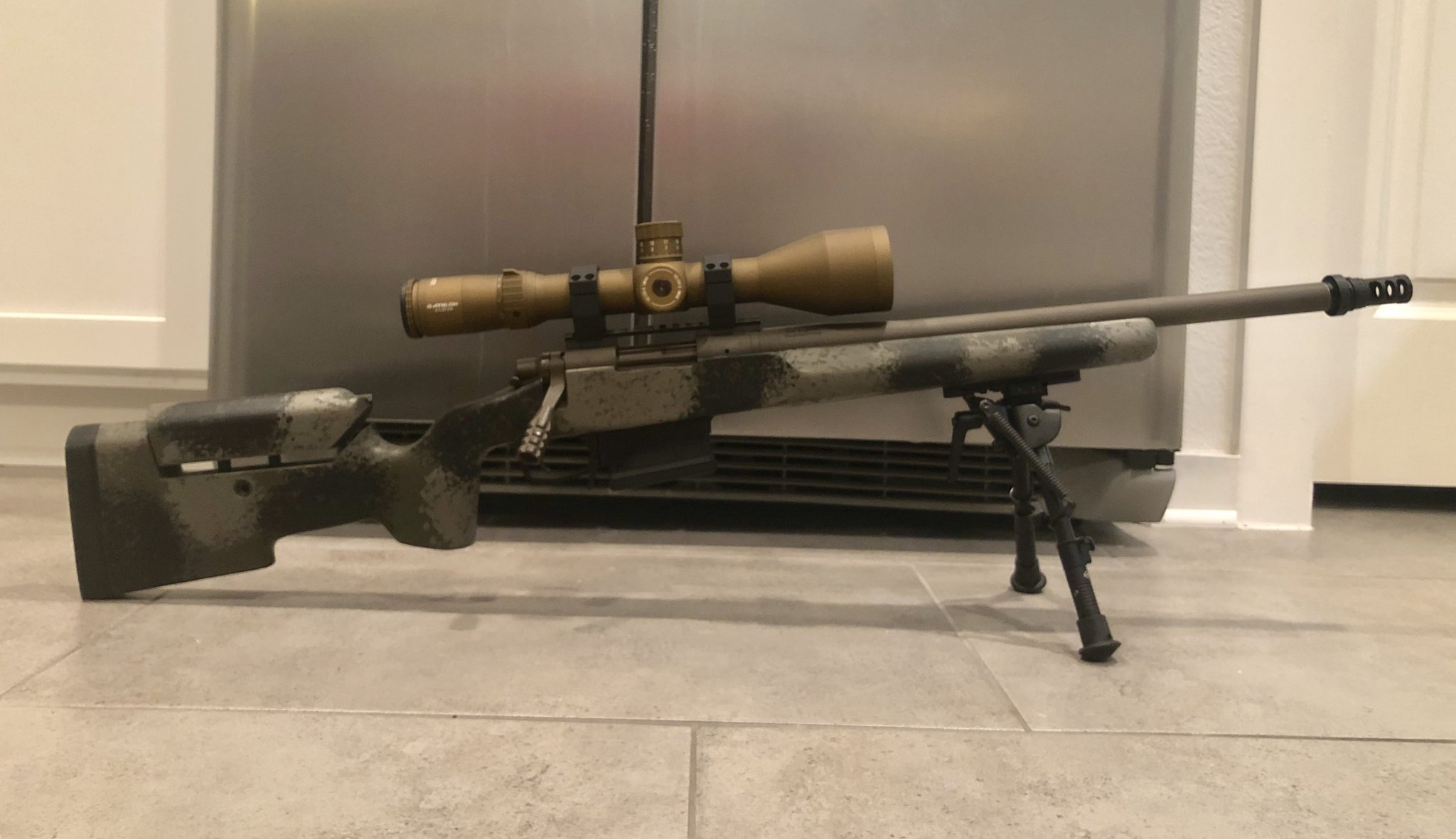

I’ve got an 18” 6.5 Creedmoor I just chopped from 24” it’s a medium Palma Bartlein. I’m going to take her out this weekend my 130 Sierra’s was pushing 2815 out of my 24” behind 42 grains of H4350. I imagine I’ll still be around 2700.

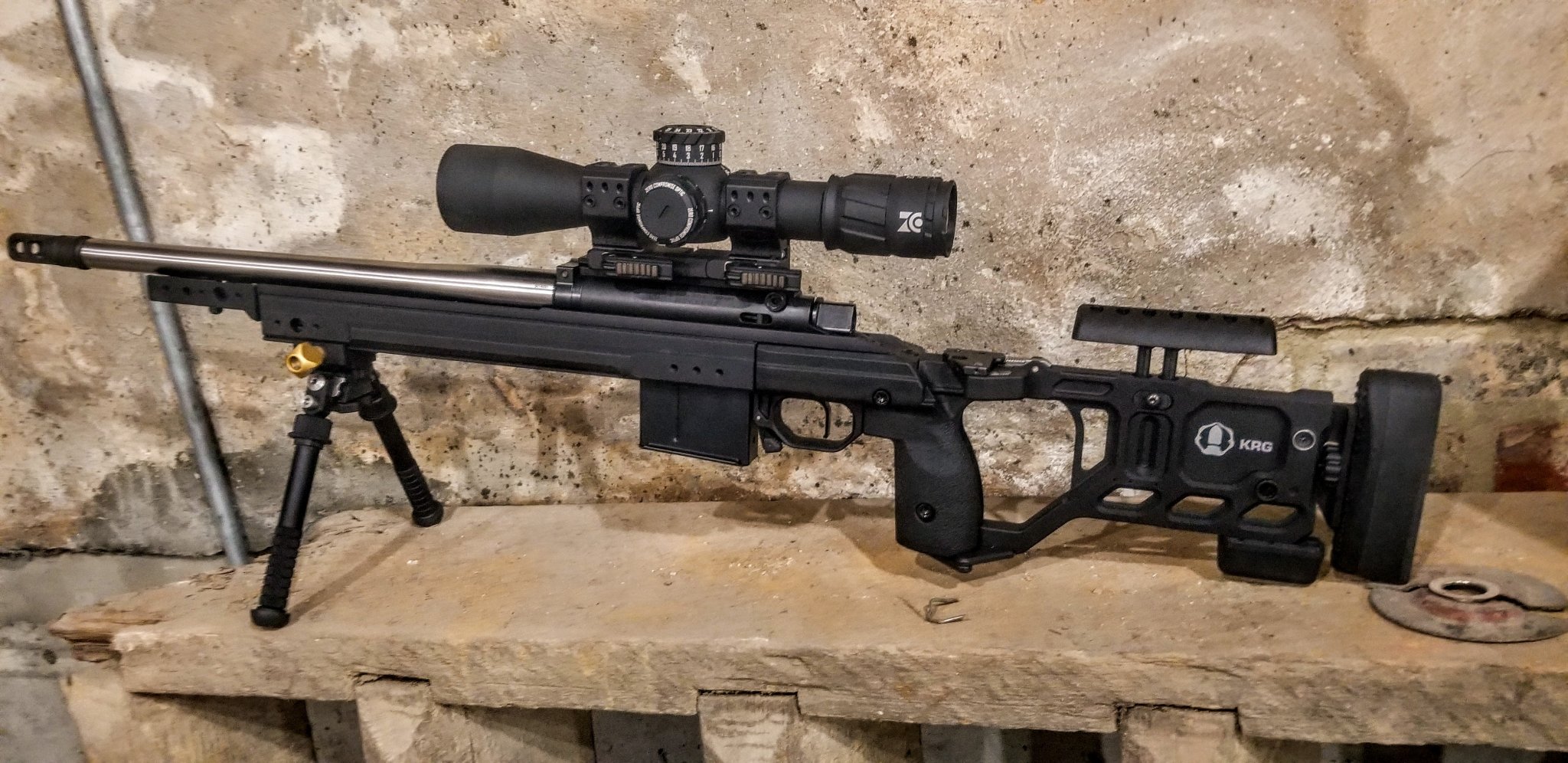

I put this together recently. It is an Ultimatum Deadline SA in 6.5 with a 16 inch IBI barrel. With the LSS XL chassis and carbine stock it weighs 9.4 lbs. I previously had it in an ESS with folding stock and 29x Athlon Ares ETR and took it out to 800m but it was too heavy so dropped it into the LSS to drop weight. I purchased this as a barreled action so no assembly other than trigger and chassis which are easy. You will read there are some fitment issues with the DL action but it is just a shortened mag catch which MDT will provide and possibly a set screw under the rear tang.
