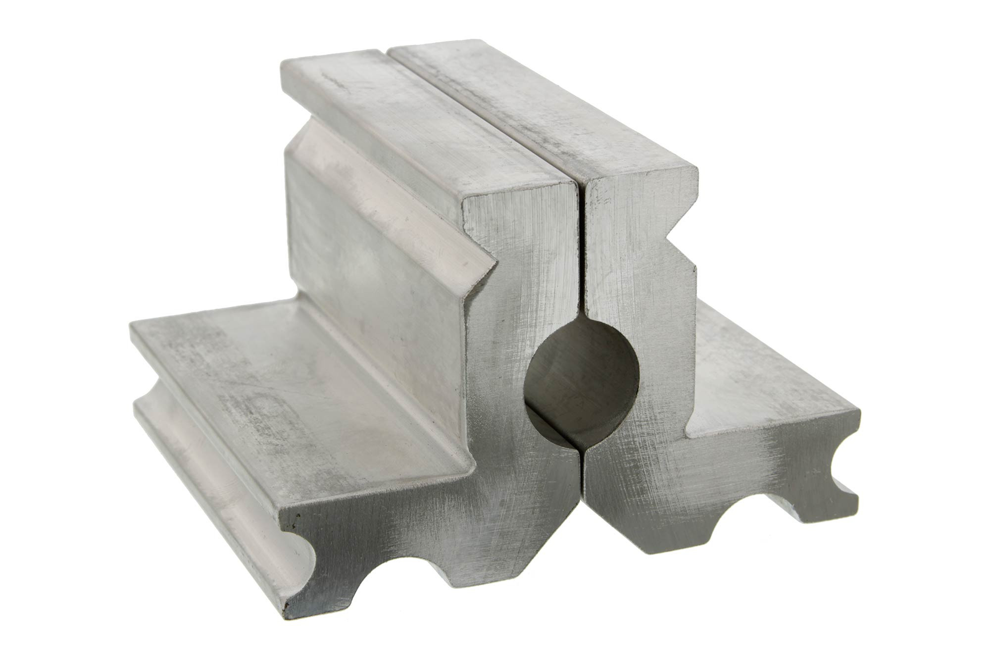

    This type of vise jaw works good easier to clamp just hold the rifle in one hand and tighten the vise with the other . This This puts the stock lower and closer to the vise pad .
