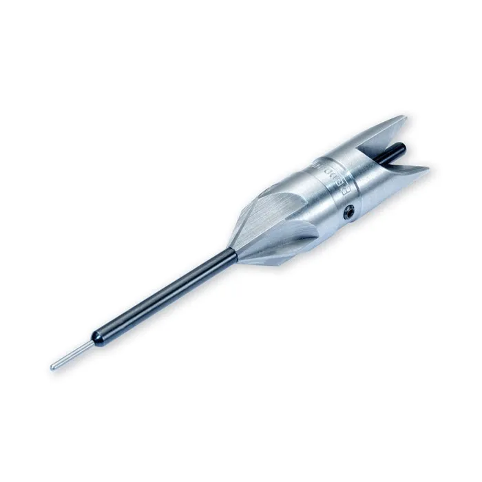

For years I used either a Wilson hand deburr took, or a Lyman VLD tool fitted on an RCBS case prep center. Occasionally I'd use a Sinclair vld tool, with the spiral/helical cutters. The one thing that always bugged me, about all of them, but particularly the VLD versions, was the (potential) lack of consistency as far as how much the mouth actually got chamfered. In theory, they should be 'self centering', but that can vary a little in actual use if you're not paying close attention. Very much a 'feel' thing. I also have a Giraud trimmer, which takes care of that (mostly), but then other things come into play.
More recently, I picked up one of the K&M chamfer tools. I dramatically scaled back the amount of brass I'm trying to prep and keep in play, so figured I'd slow things down a little. The K&M is definitely a very different affair than the solid fluted cutters like the ones I mentioned above; basically it's a fluted reamer with a long pin that centers on the flash hole. The downside is that they are a little fiddly, and you're probably best off dedicating one per caliber (i.e. .22, 6mm, .30, etc.), and they aren't the cheapest tool around. The upside is... once set, they make a very nice cut, and are very consistent - assuming your brass is trimmed consistently, etc. etc. Might be better paired with a case trimmer like the Wilson that indexes off the case head, vs. off the shoulder like some others. Oh, and be careful - the cutters are literally sharp enough to slice your fingertips if you get careless. DAMHIKT ;)

Hands down , K&M tool . It index off of the case mouth , trim /case length isn't really a concern and one can adjust it to put as much or little chamfer as wanted . Just turn it until it quits cutting brass and your chamfer will be consistent case to case . Some of the best money I've spent on handloading tools . Also, if one should want to use a power tool ,its possible with a K&M tool ..... Cut the head off of 1/4 or 5/16 standard bolt ( I forget which ) add a "jam " nut, screw into tool ,run "jam" against tool , chuck up in drill ,make brass fly .😁 Last thought, after much use , you'll be an expert at " gettin it in da hole "👍
