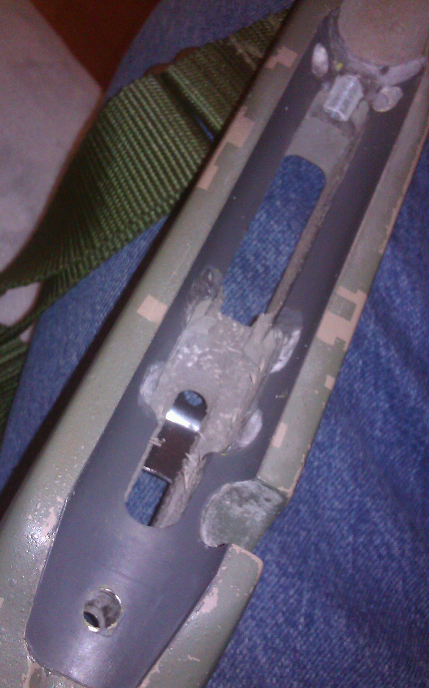

I pillar bedded it with some lamp rod and JB weld, deburred and polished the bolt handle/firing pin,changed the trigger spring and finally threaded the bolt handle for the knob that had been sitting for months.

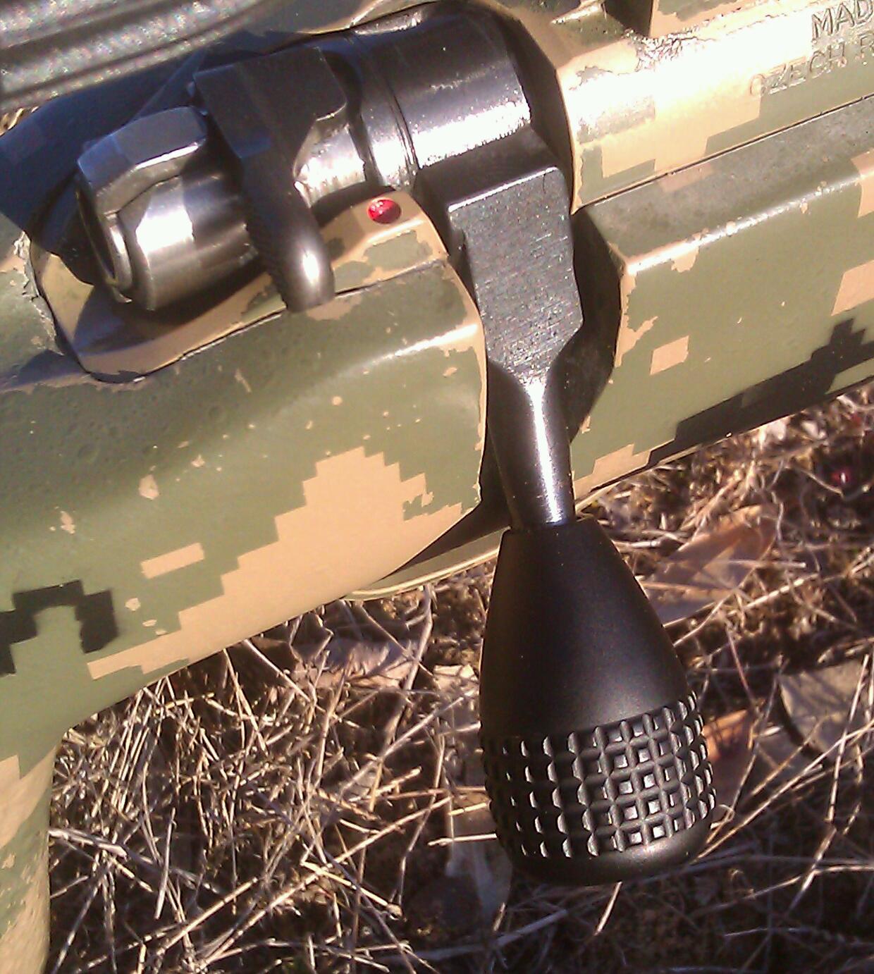

I got antsy waiting for the bedding to cure and got to threading the bolt on the China Lathe(Me+DeWalt benchtop grinder+1/4x*28? tap)
Re read some old threads I had found and got to work. None recommended using a bench grinder for final profile......
If my reading comprehension wasn't total crap and I actually used a measuring device of some sort, it might have come out perfect;)
I got lucky and the hollow spot in the stock knob did not require filling.
Just don't look here:eek:
An when that was done, the bedding was just ready to be popped apart. I ended up using some case sizing wax for release agent, which worked like a champ.
I was pretty nervous that I glued my gun together as this was my first go at bedding.
It could use a little more clean up, but nobody has to see any of it;)

How did you thread for your bolt handle?
Not very carefully.....HA!;)
posted above
Note the buggered up threads mid way were the hollow spot in the stock knoblet. Sometimes this hole will run deep into where the threads will be and I read need to be filled with silver solder before threading.
If I could retain what I read better, I would have profiled a shoulder from the stock knoblet for the new knob to butt on and also had a longer lever. These would be important for those hung up on cosmetics or planning on shooting with gloves on.
