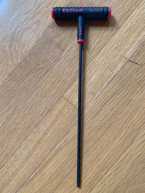

Quick update:
I took the leap and went for it. With the help of a $6 hex ball 5/32 wrench from Amazon, it made the removal of the action screws, especially the one hidden under the mag release, a breeze.
The over-travel was adjusted easily from the bottom of the trigger once the action was removed from the chassis.
For first stage travel adjustment, I didn't even need to remove the trigger/roll-pin - I just unscrewed the forward trigger screw, made my adjustment, and then put it back.
Much easier than anticipated. I now have my AXSR trigger set to exactly how I like it.
All AXSR owners should have this $6 tool stored with their rifle.
