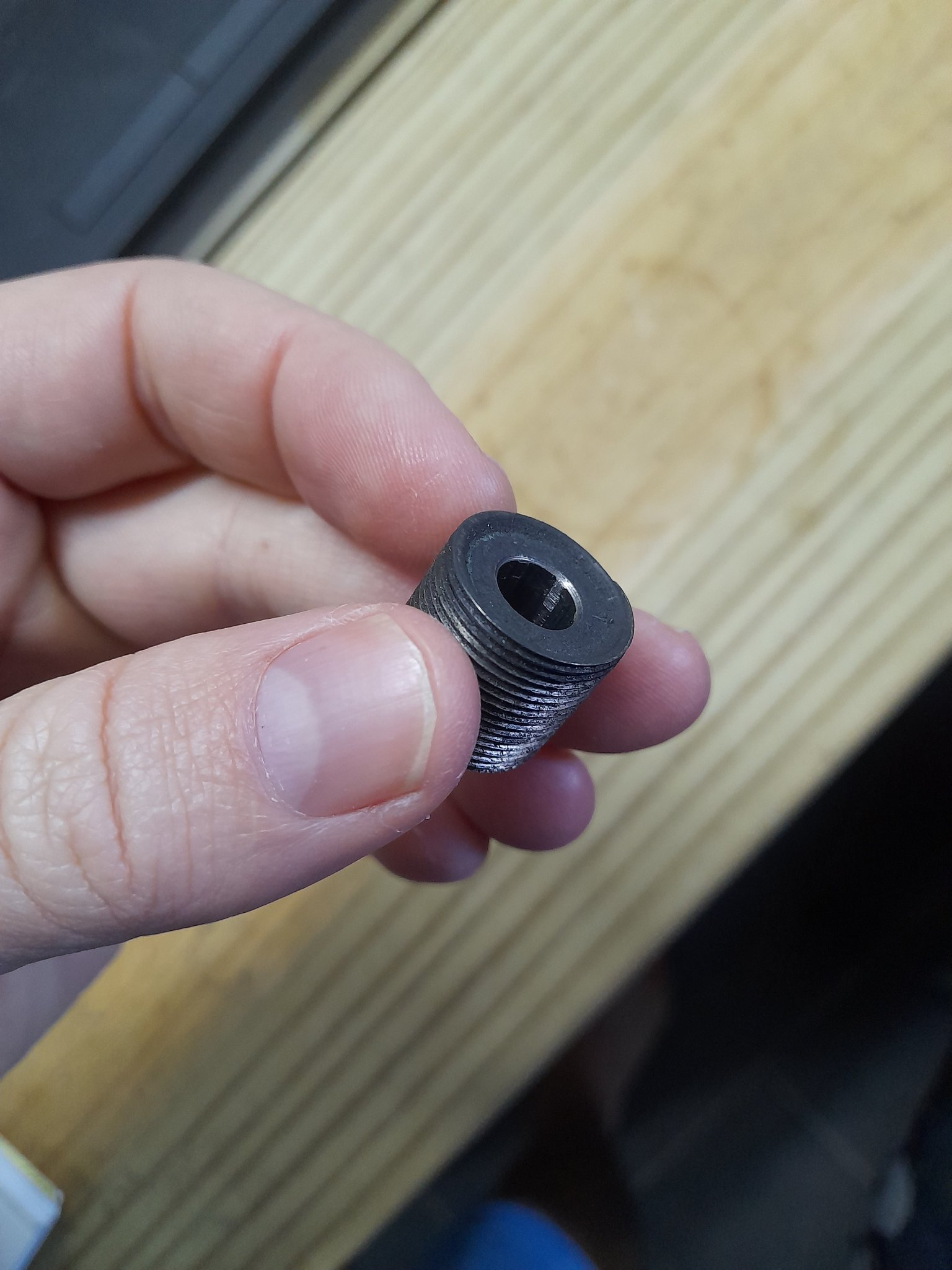

If you look at that picture you can see the bright spot. That is some broken rifling just inside the crown. There is another spot too. The last gunsmith found that, chopped it off and rethreaded the barrel.

So what did the 3 gunsmith do? It says it's threaded and in a stock.
The first threaded it and said it looked fine to him.
The second just bedded it, because I'm lazy. Also said everything else looked fine to him. To be fair, I probably don't need to count this one. At this point I was sure it was going to be fixed.
The third got it as a problem. He found the spots of broken rifling. Apparently spent a lot of time with a borescope. Chopped off the barrel, re crowned and threaded.
The agent is now arranging a courier to collect the gun to take it their gunsmith, write report for Sabatti.
