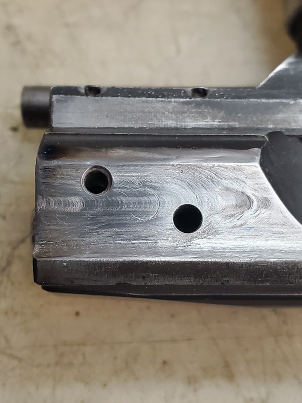

I need to drill and tap a small hole in a bolt carrier. this thing is hard as fuck and even after grinding the black coating off ive smoked a couple drill bits giving it a go. do I need a specific bit? ive tried slow to fast with oil. barely puts a scratch in it. wtf?
A milling machine is your buddy
I wish, unfortunately im stuck with a medium sized drill press.
Wait till you get it drilled. Then you get to break a carbide tap off in there lol.
yeah, Im already dreading that part. its an 8-32. could I drill it a little oversized to reduce the amount of cutting the tap needs to do? this is a test and proof of concept so I dont need perfect threads.
Google "carbide bit for hardened steel". Start with a two-flute bit. It helps to buy two or three bits and start with a small hole and then enlarging it with increasingly larger bits. Also, it helps enormously to continuously irrigate the hole with a cutting fluid. These bits are not cheap.
So Im thinking plan B. opening up up the firing pin retaing pin holes from 3/32" to 1/8" and then whatever the hole is next to it on the right side that is already 1/8" and then tap the two for 6-32.
You shouldn't need Carbide, a new colbat bit should be fine. Just make sure you have feeds and speeds correct. The harder the material the slower you want to go RPM wise. Otherwise you are just work hardening the piece you are trying to drill. Lots of lube will be your friend as well.
Reactions: ken226

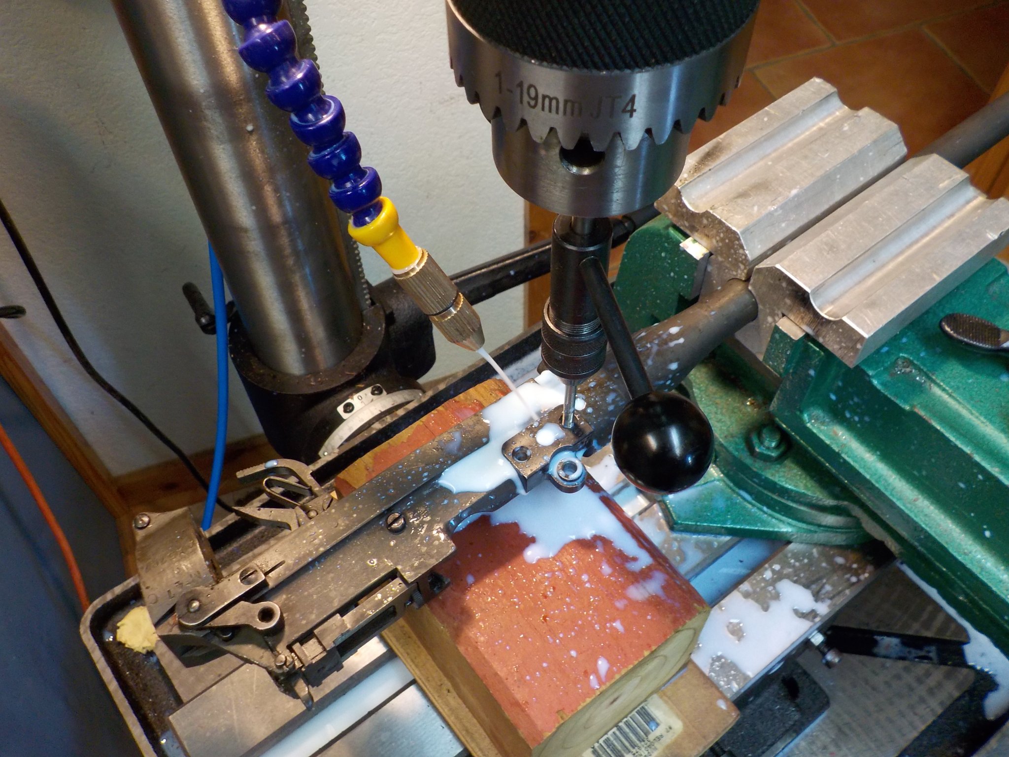

I tried new bits to no avail could not get them to cut. so reluctantly I ended up taking my torch set and a #0 tip, setting the BCG upright in a pan of water and annealing the area around the holes. only then would the bits cut into it. got them drilled and tapped which was a struggle in and of itself. even being annealed to some degree was a pita.
if It’s just for a prototype, put most of the carrier under water and heat the area that you need to tap. This should take the hardening out of that area.
Reactions: 2aBaC̶a̶
Did you use a drill starter?

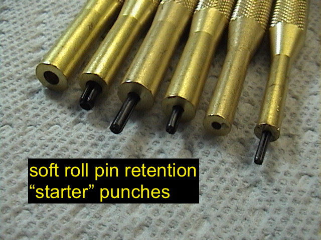

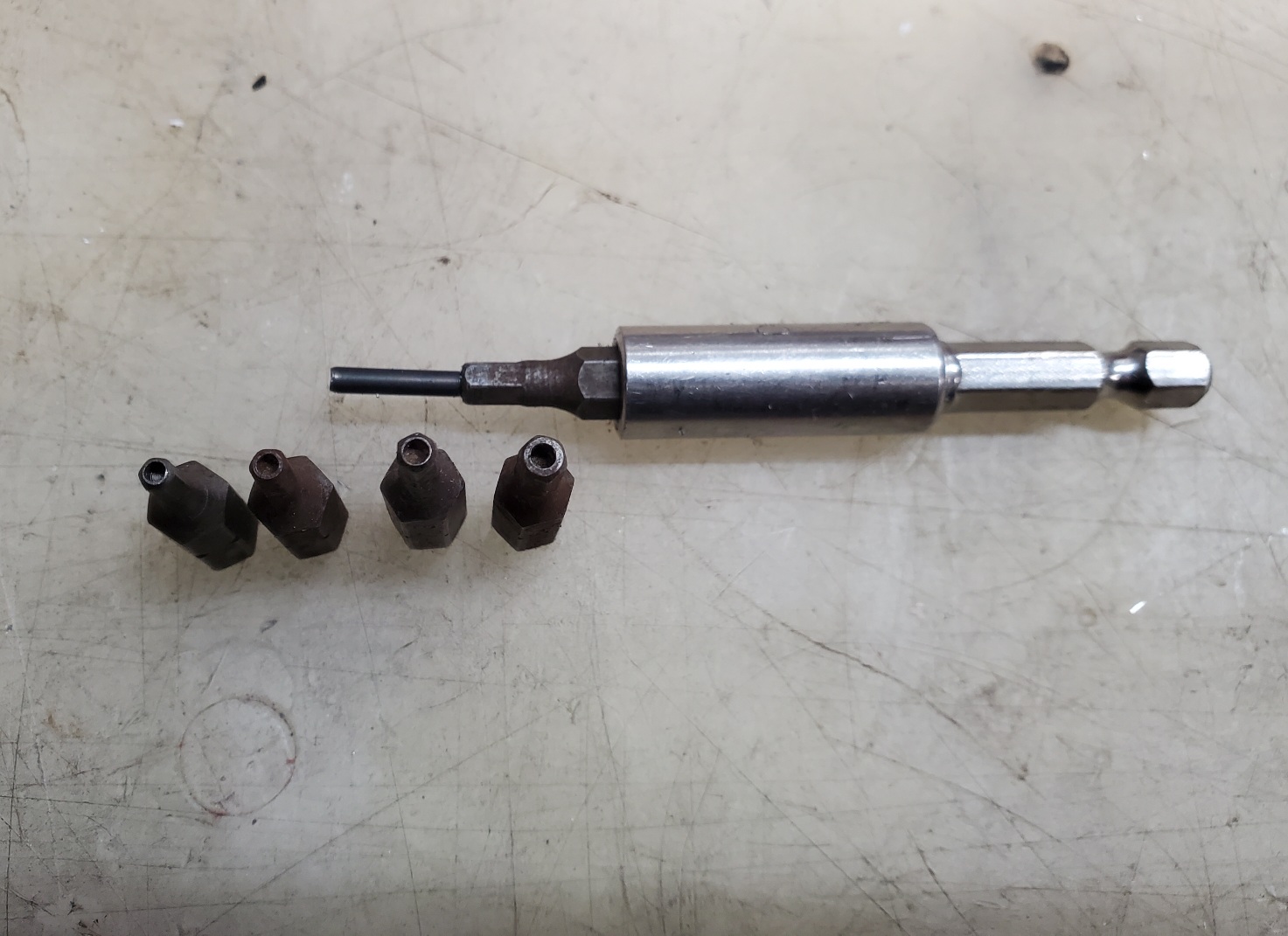

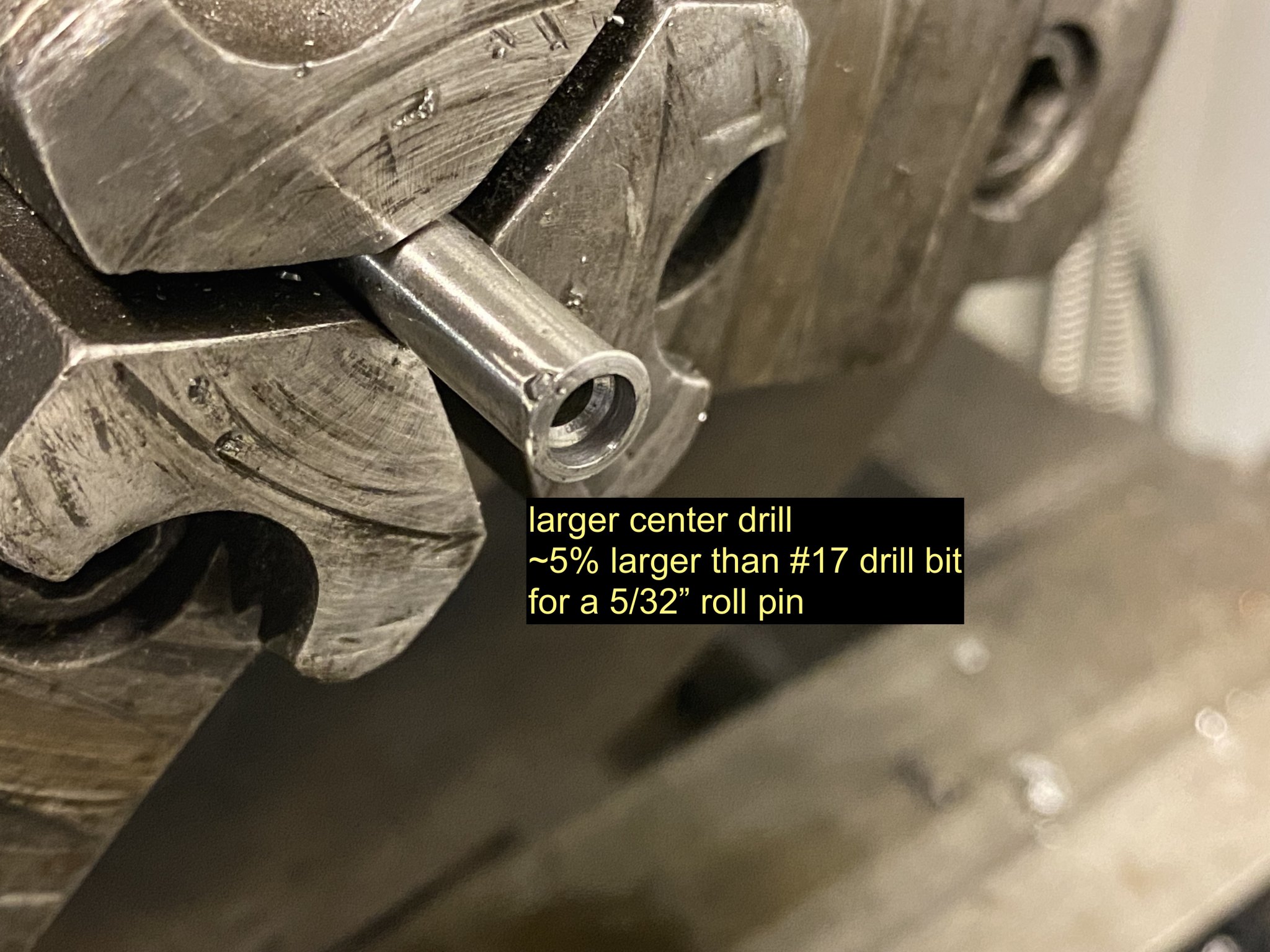

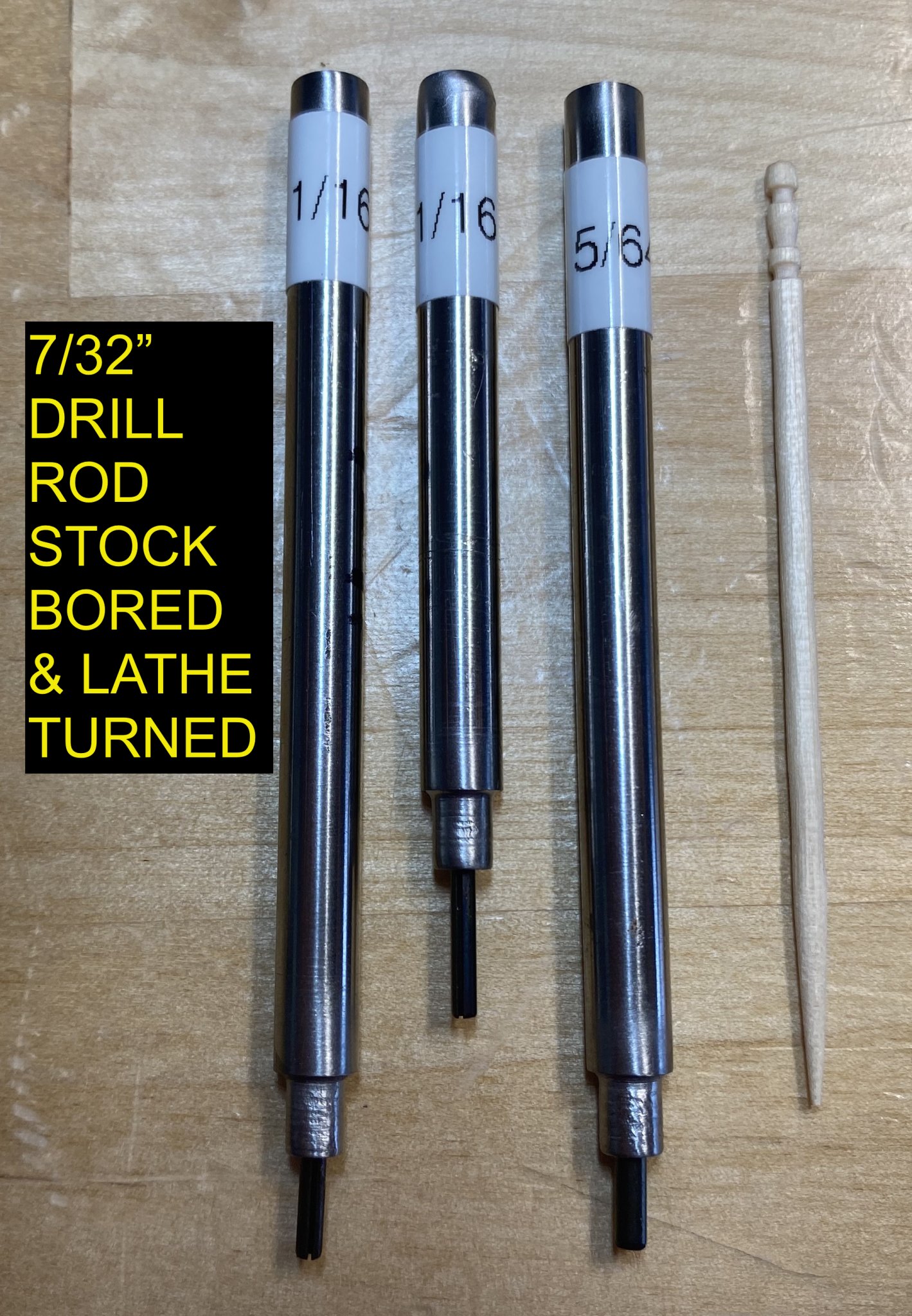

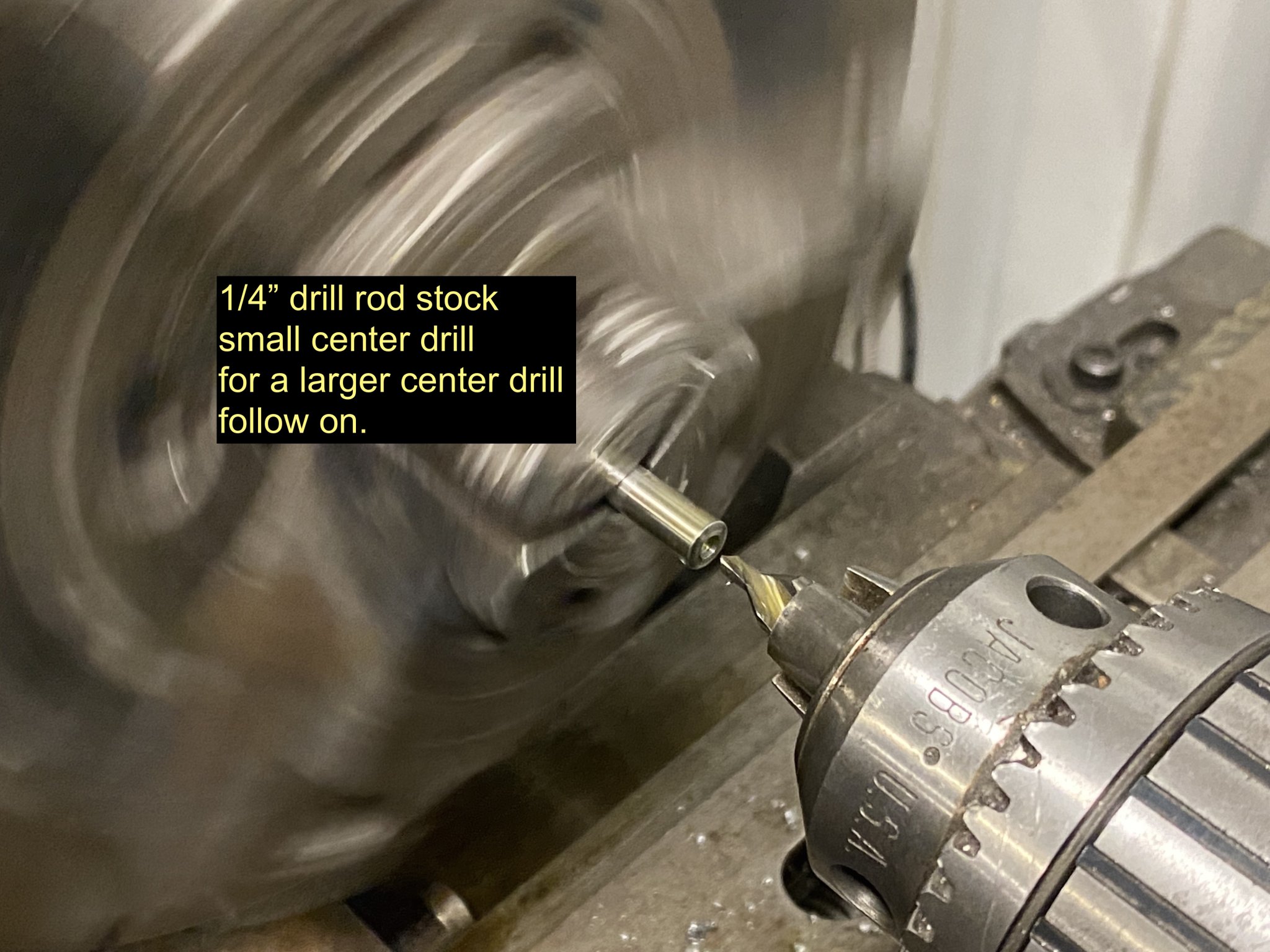

After creating the flat as mentioned, it may be wise to use the smallest center drill as an initial pilot hole to follow-on with yet a larger center drill slightly over-sized in preparation for using the final tap drill bit size for the 8-32 screw. I fabricate roll pin starter punches from hardened drill rod stock. This is a 1/4" rod for a 5/32" roll pin I made last week. Sharp carbide bits, a rigid setup of the work, low speed & pressure, small depth pecks with the drill bits, lubrication are your friends; IF you see smoke stop, cool off parts and begin again.

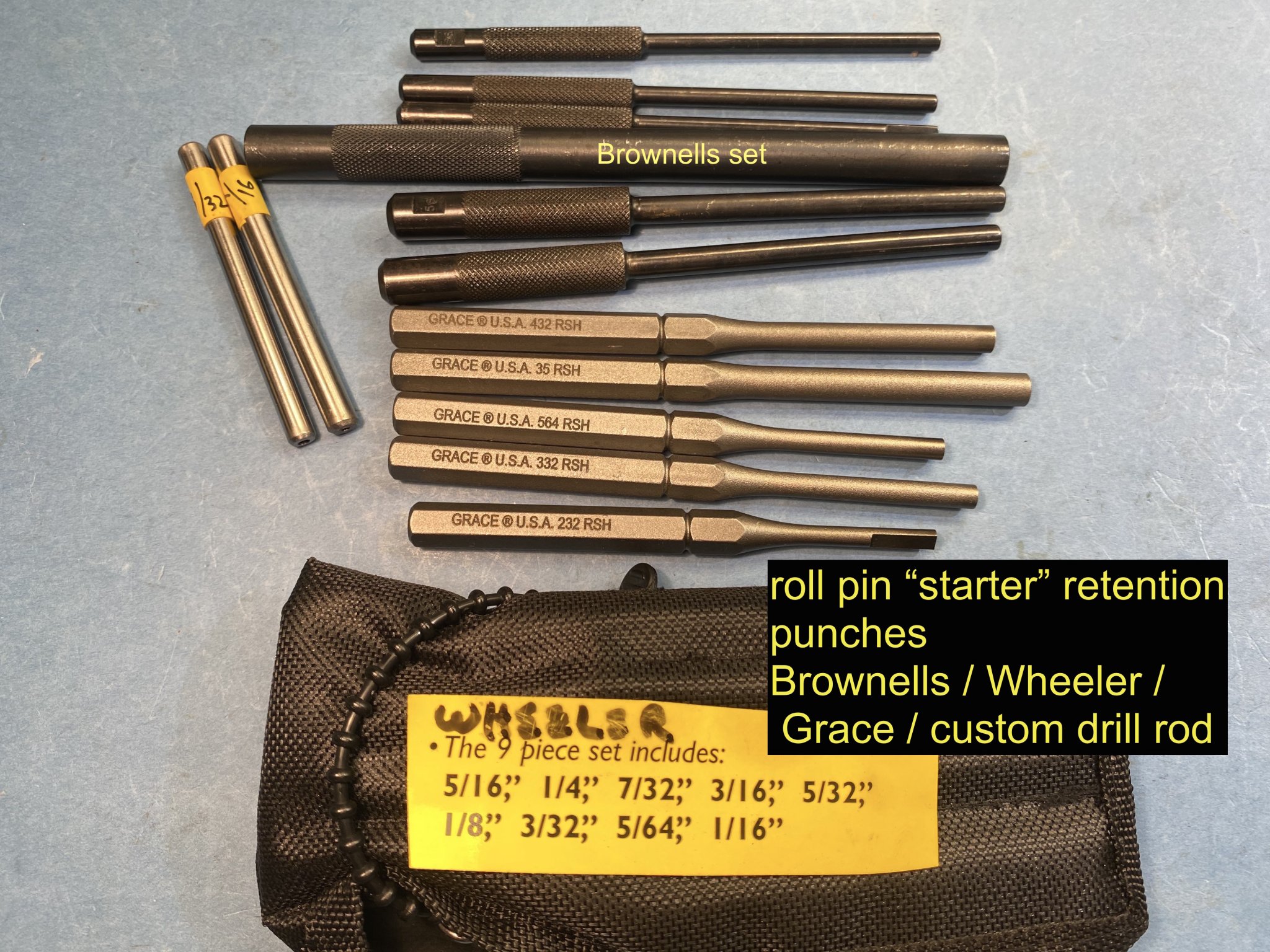

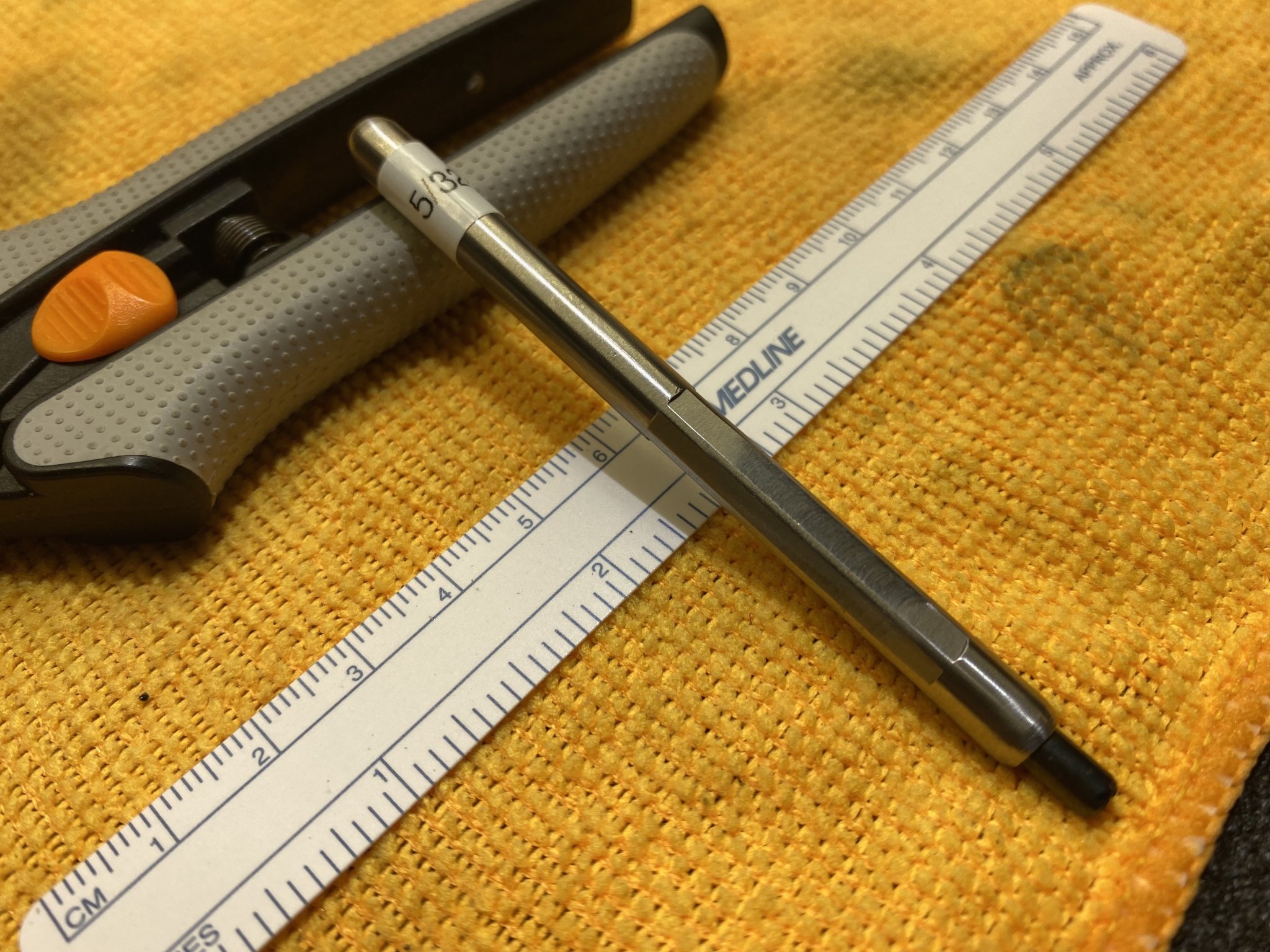

IMG_4433GUNSMITH STARTER ROLL PIN PUNCH 5-32" DRILL ROD FABRICATION MJD 09.24.22 copy.jpg
IMG_4434GUNSMITH STARTER ROLL PIN PUNCH 5-32" DRILL ROD FABRICATION MJD 09.24.22 copy.jpg
IMG_4436GUNSMITH STARTER ROLL PIN PUNCH 5-32" DRILL ROD FABRICATION MJD 09.24.22 copy.jpg
IMG_4450GUNSMITH STARTER ROLL PIN PUNCH 5-32" DRILL ROD FABRICATION MJD 09.24.22 copy.jpg
View attachment 7969318View attachment 7969319View attachment 7969320View attachment 7969321
Those starter pins look great. Do you sell them?
I like the short tools to be close to the work with small pins. The standard roll pin starter punches are too long for my liking. Also made some from brass stock. I just make them for the hobby.
Reactions: E. Bryant
I have the wheeler set and to be honest I find them to be a pain. the pins get stuck in the end of the punch. I kinda wish they were a little oversized and magnetic.

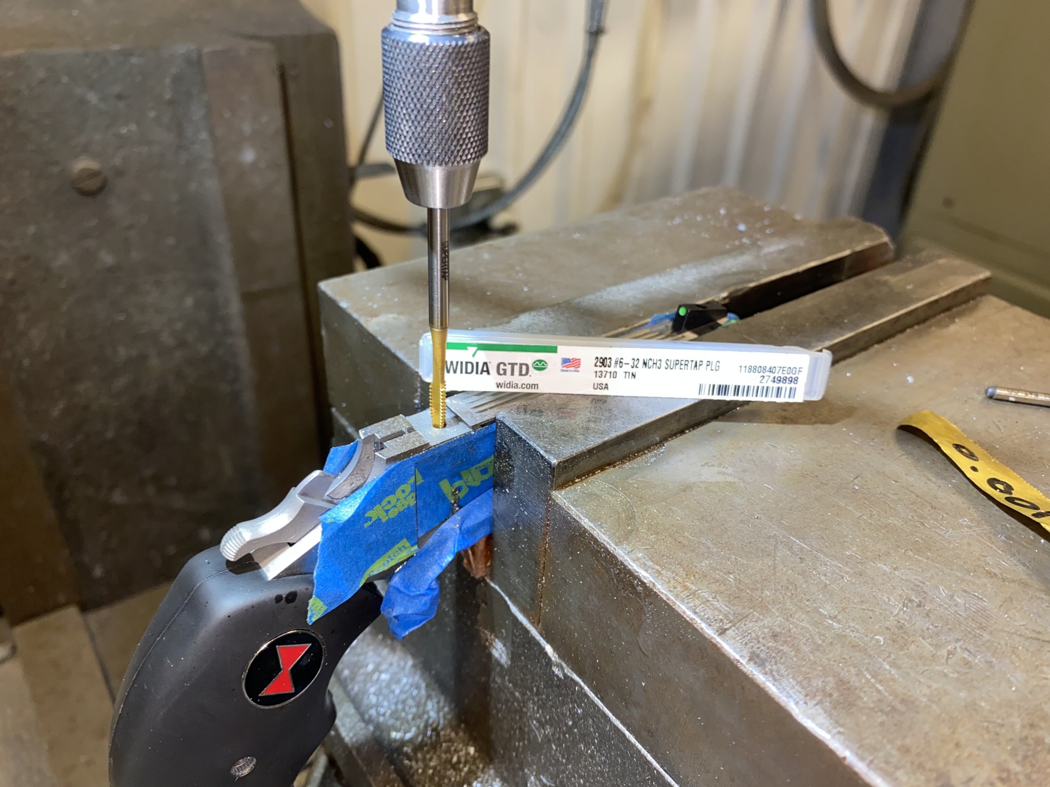

AR15 bolt carriers are case hardened, usually fairly deep; you're not going to tap threads in that without either removing or softening the case hardened layer. I do it by using a carbide end mill to cut through the case hardening on the outside, then reach inside with a diamond burr to clean up the other end of the hole.
Even then, the softer inner material is still tool steel and not the easiest thing to tap, so be careful. And don't use 6-32, that size is the most likely to break out of all your possible choices. Besides for a charge handle, a #10-32 grade 8 is more appropriate for the size and strength demands.
If you use a mill to give yourself a flat for the handle to register against, the whole assembly can be a lot stronger.
