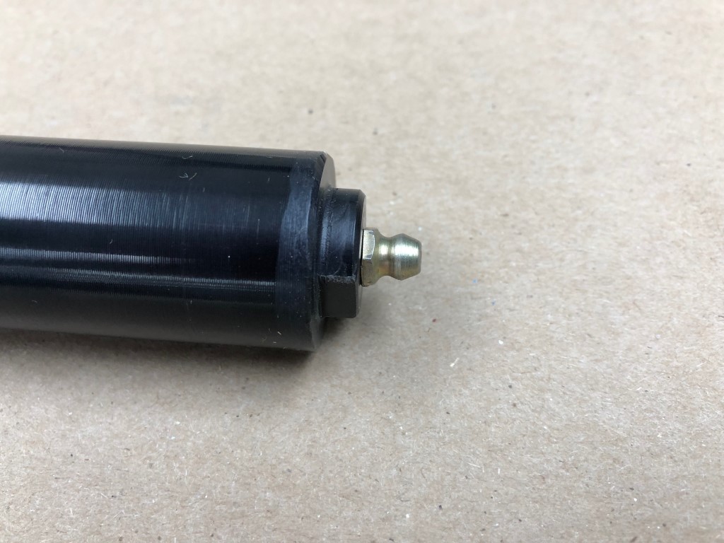

IDK how you guys managed to bastardize a rifle platform in less that half dozen post.
Grease?
Oh Do Tell.
i started using the Aero enhanced carbine buffer tube for my last couple of lowers. inside is really really smooth. a light coat of wheel bearing grease on the spring, i think it's as good as it gets with the milspec buffer spring.
I too am real intrigued as to how wheel bearing grease works out. White lithium I can understand, but wheel bearing grease? That stuff's a dirt magnet and has a way of working into every nook and cranny in whatever system it's put into.
i didn't say to pack it like a wheel bearing, gee whiz. a light coating to lube the metal-on-metal sliding surface.
been doing it for over a decade. the area behind the buffer is an enclosed system. it's not like i'm taking the upper off the lower and using the lower-receiver fire-control-pocket as a shovel to dig a trench, well, maybe you guys are. I also don't disassemble my buffer and spring in the field and roll it around in the sand like you guys do. I'm not AK Operaters Union trying to do a destruction test.
I've used it on all my "sprongy thingies". I had one AR, that has over 6k rnds. thru it. I finally took the buffer spring out (field strip cleaning), and the grease was just as blue(water-proof bearing type) as when it was applied. Kinda surprised me also, but, I don't submerge my guns, or, drag them thru mud pits, either. Mac
