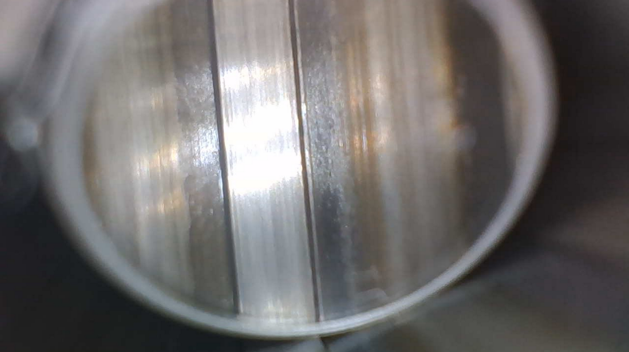

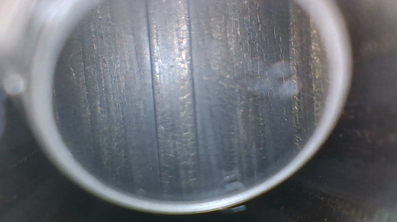

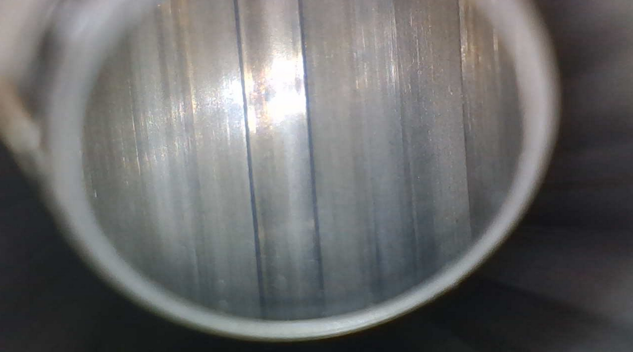

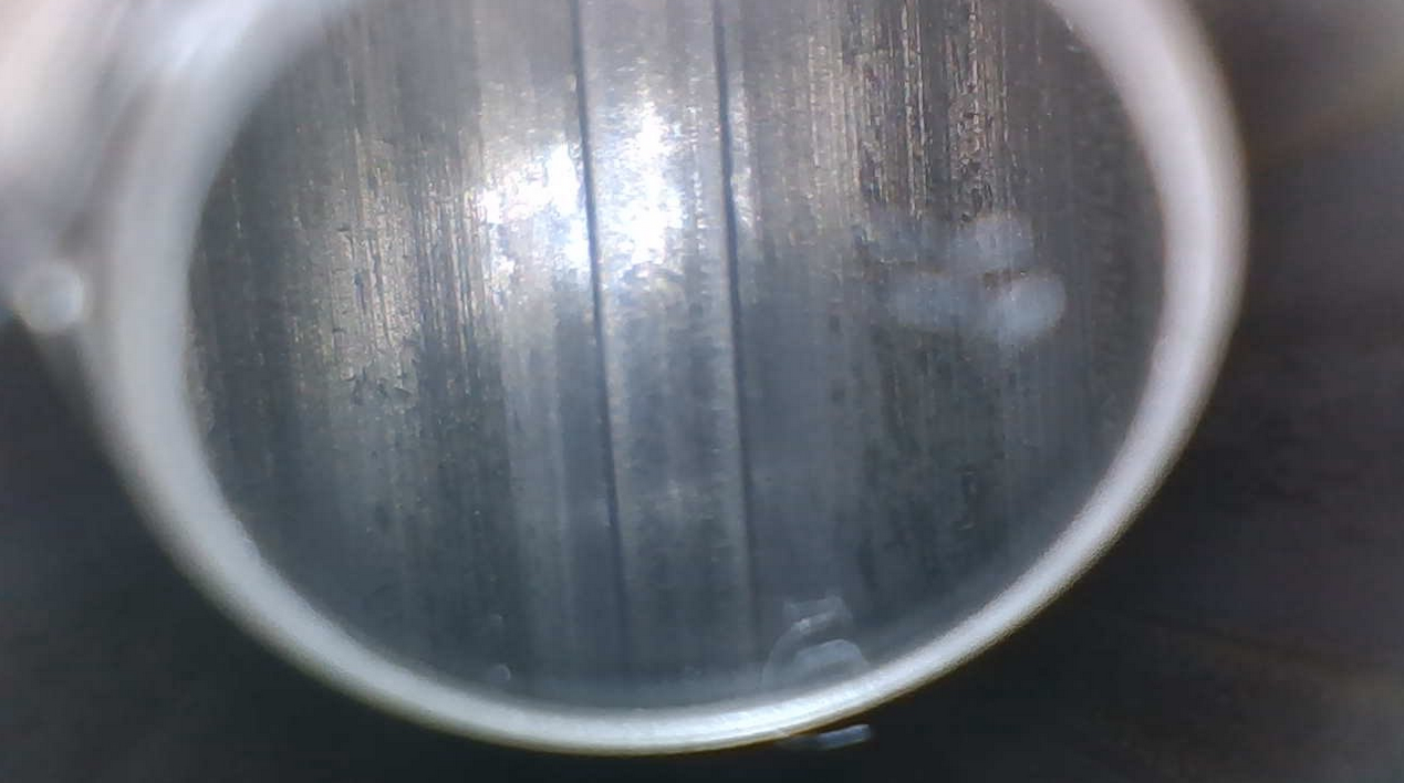

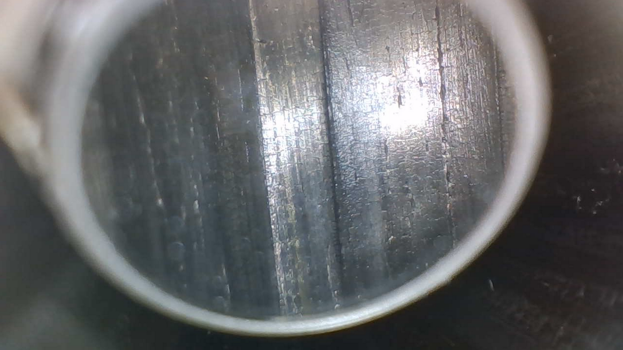

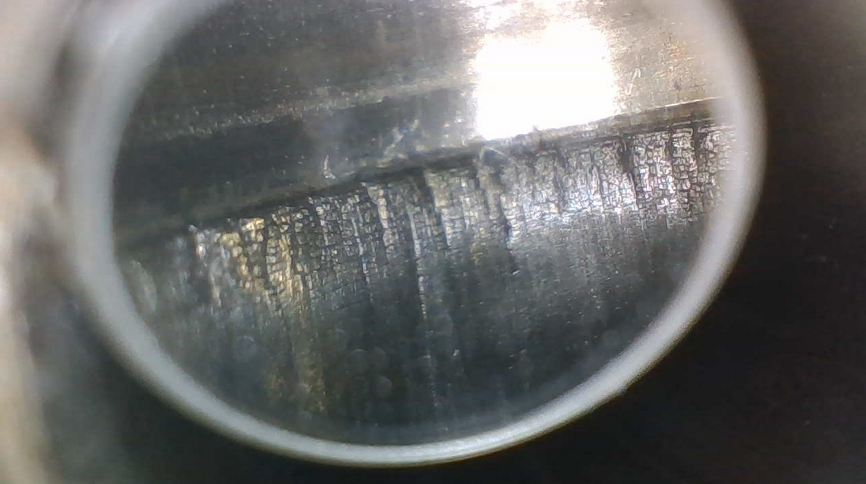

    I was in another thread talking about how I thought I'd shot through the barrel on my MPA 300-WM rifle. It's got about 1,200-1,400 rounds through it (combination of factory and handload), and for the last 200 rounds or so, groups have gone from sub-MOA to 4+ MOA ... getting consistently worse. I just thoroughly cleaned the barrel and bore-scoped it, and here are the results. Any seasoned pro's that know what they're looking at are encouraged to tell me what you see. There are five photos ... working down the barrel from chamber to muzzle.
    Thanks for the help figuring out if it's "me", or the "barrel", or "both".
    Start of the lands ...
    Just beyond the start of the lands ...
    One foot down the barrel ...

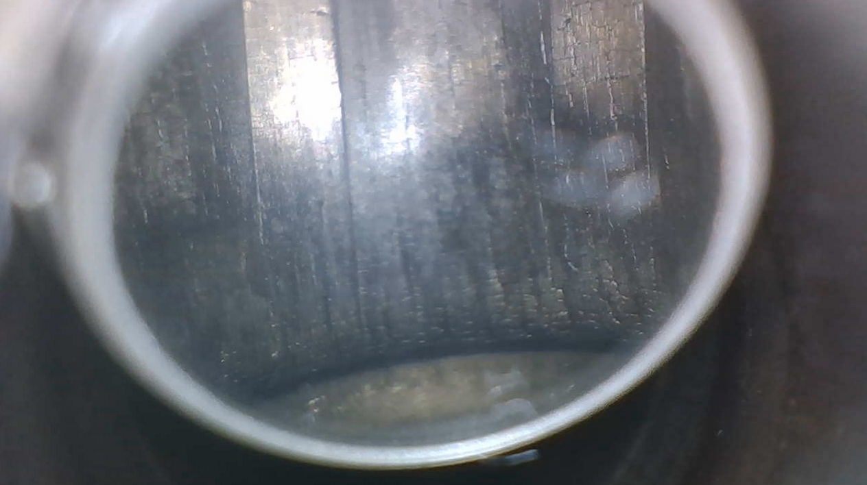

    Two feet down the barrel ...
    Just inside the muzzle ...

    I think that it best. You can play with a tube of Lasso as it won't hurt your toasted barrel at this point. You may learn something. Lasso does have it's place and is used successfully mostly by benchrest shooters who require a super clean barrel and know more about shooting in their pinky finger than you and I will ever know. Guys like us usually do more harm then good on a premium custom barrel.
    Supersubes is right. I have seen much worse. It's your call.
    Doesnt look bad to me at all. The fact that the leade is sharp and defined is unusual for a toasted barrel. Certainly nothing there to explain 4 moa.
    That's what I was thinking as well. Sure doesn't look like tomato stake territory.
    Certainly wouldn't explain 4 minutes, but the lands are definitely eroded a bit at the throat (zero freebore). If OAL hasn't been checked/adjusted to whatever jump was most accurate might help?
    You did check the obvious shit, like action screws?
    Your barrel is still pretty dirty but it isn't a 4 MOA barrel. I would be looking for other issues, loose action screws, loose scope mounts, bad optic, bad ammo. It would be a shame to install a new barrel and have the same issue, although to install a new barrel you will have everything apart. Take it apart now and find the issue, change ammo brands, swap a new scope onto it, check the cheapest stuff first.
    since you ordered a replacement, so i see no reason not to troubleshoot and clean the current one, if only to milk out life as a spare for the coming zombie apocalypse.

    Severe carbon & copper fouling, throat is not that bad.
    1300 rounds, try this wrap a brush with OOOO steel wool, load it up with JB bore paste, Iosso, Flitz, etc and get all that fouling out, shiny barrel steel. Tighten your groups right up. Use a bore guide. The bulk of my 300 WM experience is shooting NRA Long Range. Sighters plus 20 shots for record, very hard on your barrel.
    Judging by my .308 barrels it doesn't take much to get that "fire cracked" look at the throat.
    It's when you start noticing squares of material in those cracks missing things would suck.
    I have a 22-250 barrel that looks much worse than that and still shoots .5 - .7. I agree with others, clean the shit out of it and make sure everything on the rifle is torqued properly.

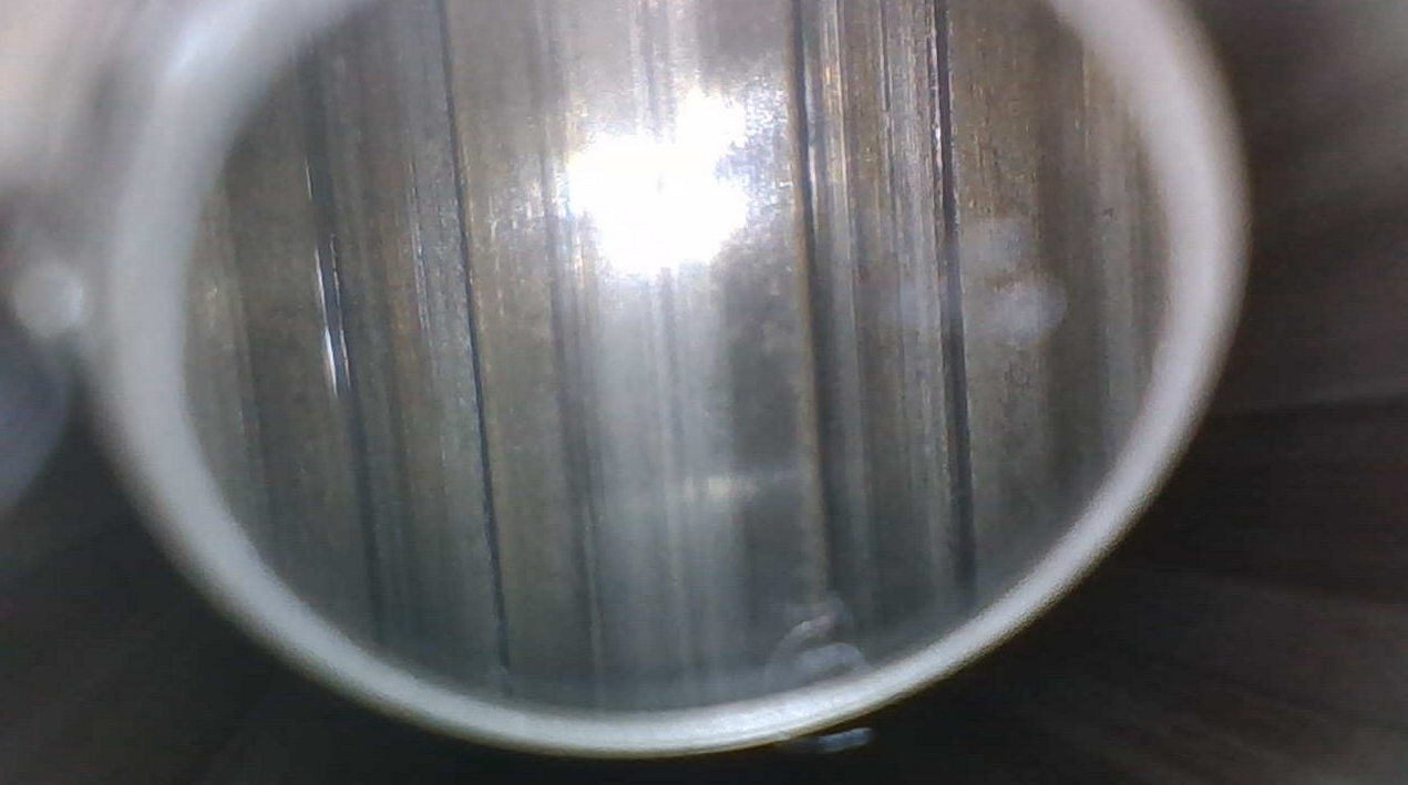

    Update ...

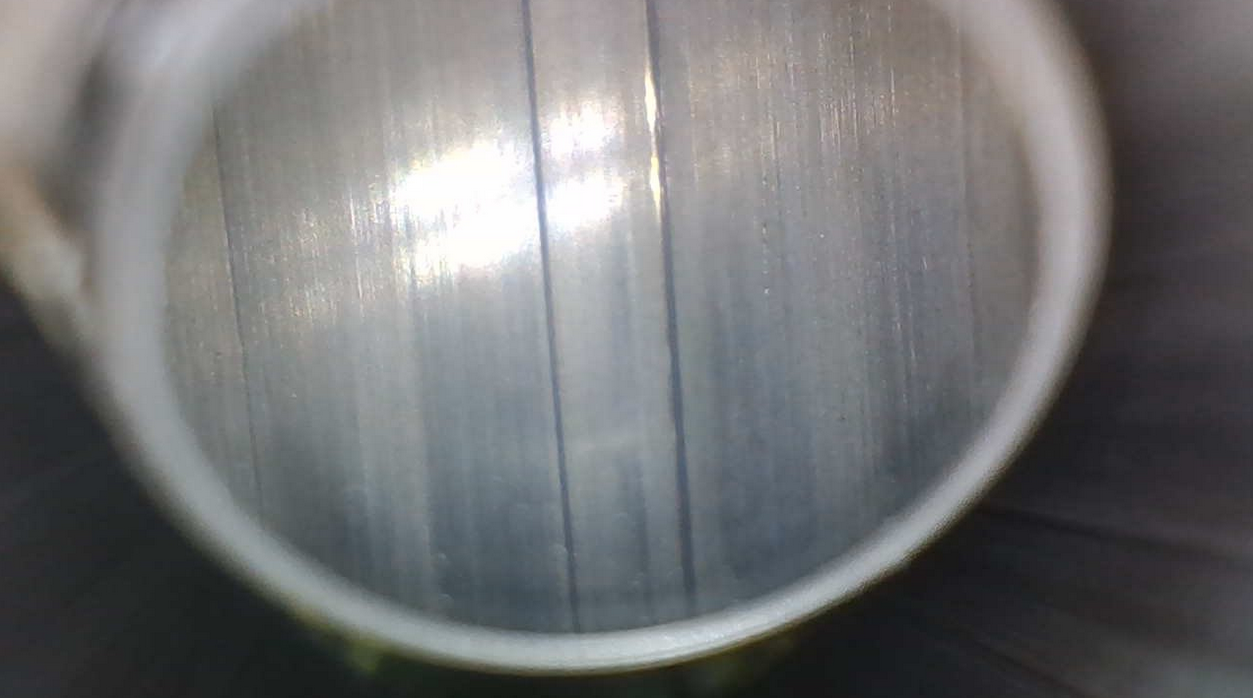

    I disassembled the barrel from the action, plugged the action-end, and filled the barrel with Bore-Tech Carbon Remover. After soaking for 24 hours, I drained, scrubbed, and did a massive cleaning on it. The results were interesting ...
    1. The chamber end at the lands was even better defined with crackling and fire damage. After cleaning, because everything "movable" was scrubbed away, the start of the lands looks even worse than before I soaked and scrubbed it.
    2. A few inches from the start of the lands I got the same result, where the crackling looks worse because all the carbon and copper that filled cracks is gone.
    3. Further down the barrel and into the muzzle, everything looks gorgeous ... clean and shiny.
    I'm going to take it out and shoot for groups at 100-yards, and see if anything improves. With the damage on the chamber end, I'm not so sure how that will work out. My guess is no change, and I'll install the McGowen barrel I have on order, and start shooting accurately again in a few months.
    Here's a few pics ... (post soak/scrub/clean):
    Start of the lands:
    2-inches down the barrel:
    A foot down the barrel:
    Near the muzzle:

    I predict it will suck until you refill all the cracking with copper than the fresh front end will be sending them in the X ring.
    Wouldn't that be nice ... I hope you're right. Another 1,000 rounds out of this barrel would be terrific, with the new one sitting on the shelf waiting its turn. Time will tell ... might try to head to the range tomorrow. That said, it's damn hot and smoky here in Central Oregon right now. Not great range weather.
    Give it enough rounds to "restore" the copper lining that is beneficial and see what it will do.
    The down side is that if it gets better than quickly goes to shit well it may be done.

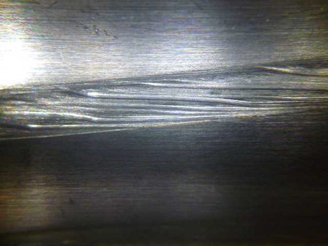

    Hate to say it but it still isn't clean. Run some Bore Tech Eliminator down it and let it soak for 15 minutes and you are going to see a lot of blue copper coming out, then you need to attack the next layer of carbon.

    Still doesn't look bad to me.
    If you think this barrel is toast just from these pics..... You don't want to see my 6.5cm still hammering with no rifling for the first 2 inches and fire checking 2/3 of the way down the barrel like a topography map of the grand canyon....
    Firecracking does not tell the full story.
    I agree though that it ain't "clean".
    Are you able to pull the barrel can't remember if you said this was off an mrad or something?
    Start of the lands:
    Near the muzzle:
    Hope you guys found my "journey" at least semi-interesting.
    Most of that is just hard carbon.
    get some Iosso in there and she’ll come back to life.
    I don't recommend using Iosso. For starters you use a brush with the Iosso/paste type cleaner and I'll guarantee bore damage especially to the lands. Will end up looking like this...
    I've seen barrels start to get damaged/shooting poorly with in 100 rounds.
    Also ever wonder why when you use Iosso and similar abrasive cleaners the patches keep coming out really black in color? Your basically polishing the bore and also can be removing material. The bore too smooth will also lead to copper fouling and a loss in accuracy in as little as less than 20 rounds.
    Yes every shooter cleans they're barrel differently and some shooters are more aggressive then others....there are a lot of variables involved.
    If you have to use anything I would use JB Bore Compound or Rem. 40x cleaner (years ago the 40x cleaner use to be called Gold Medallion).
    Again patches only and never with a brush. Make sure you get it all out with patches and solvent afterwards also. Again with the abrasive cleaners I feel at times shooters don't get them completely out of the bore of the barrel and then fire rounds down the bore....when this happens you might have well had rocks inside the barrel.
    Later, Frank
    Bartlein Barrels
    What your seeing in the pictures starting at the throat area is cracking mostly on the edges of the lands and when you start losing little chunks of metal off the edges accuracy goes sour.
    The black in the barrel is carbon fouling. The reddish tint/color is copper fouling.
    1000-1200 rounds on it...depending on your accuracy requirement... I'll say barrel is toast especially if it went from sub moa to 4moa. The average pressure test barrels in 300WM don't make it past 800-1000 rounds. Why? As the throat wears the pressure and velocity will start to vary which in turn will lead to bigger extreme spreads in your ammo. At short range the gun might shoot good or appear to shoot good but when you start getting out to 500 yards and further you will notice the groups will open up more than what the accuracy is showing at 100 yards. Follow me?
    How the barrel is made also can dictate barrel life.
    How the barrel is maintained/cleaned and how often will dictate barrel life as well as rate of fire and types of bullets shot thru it and not to mention powder type.
    Just looking at the pictures....as has been mentioned it might not be done yet. It does need a really good cleaning. Get it good and cleaned and see how it shoots. If it starts out shooting good but by the time you get say 15-20 rounds on it from being clean and the groups are opening up....that will tell you it's done.
    Also check the muzzle crown for any damage....even the slightest amount of damage from cleaning can cause accuracy issues. If in question get it recrowned and you might see the accuracy come right back. Also make sure you get the crown edged chamfered after refacing the crown of the barrel. The chamfer on the bore edge helps with the gas cutting effect which will prematurely lead to crown wear. I never run a sharp crown edge. Also the chamfer will help with premature cleaning damage as well.
    Later, Frank
    Bartlein Barrels
