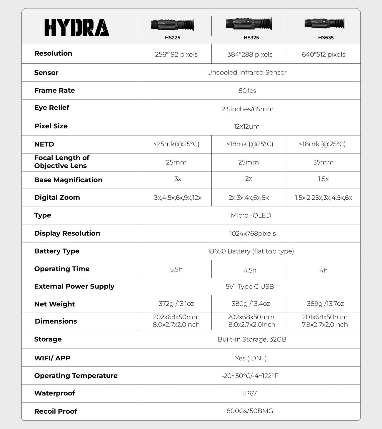

Take a look at the new DNT HS635 - Hydra 640x512 35mm Multi-Function Thermal Scope - Standalone Scope - Clip-On - Handheld Monocular
Standalone Scope + Clip On + Handheld, Hydra redefines the standard for the thermal industry. This is one of the most capable and best valued thermal one can imagine. CNC machined from an entire block of aircraft grade aluminum; Hydra is extremely sturdy for all environments.
High-End Thermal Sensor and AI Enhanced
Super Resolution Image
Our Hydra thermal scope is equipped with a 12μm ≤18mk thermal sensor for ultra clear thermal images and DNT's proprietary Super Resolution image algorithm just made the impossible, possible. This amazing technology now enhances your thermal image to the next level and resolves the biggest issue of thermal losing definition after digitally zooming in.

@gr8fuldoug or anyone else who understands this stuff - can you explain how the HS635 works as a clip-on with their base magnification of 1.5? Presumably the image on screen is reduced in that mode (versus the sight and scanner modes) to bring the image back to unity for the daytime optic? Would this also not mean that the HS225 reduces the image size substantially more to account for the 3x base magnification? Assuming I have that right, it would also seem to indicate that the HS635 would offer higher magnification before things become fuzzy on the daytime optic?
The image does get shrunk down a bit to fit into the daytime optic.
I will have to dig a little deeper on the base magnification of the HS225 and how entering clip on mode affects it.
More to follow
When in clip-on the image is shrunk down to fit into the eye box of the glass optic.
The reticle and magnification on the Hydra series are disabled when in clip-on mode.
The base magnification will be that of your glass optic.
