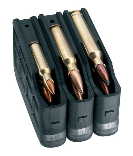

Thanks for the information. With the actions all being the same size, are the LA & SA mags the same (maybe using a spacer block on the SA)? I think I have found barreled action with the option to purchase the entire rifle. Are the CTR mags and bottom metal a better choice over a AICS mag set up? Is there any advantage in choosing a blued carbon steel over stainless steel action? Thanks.
The different tikka mags
7043272
