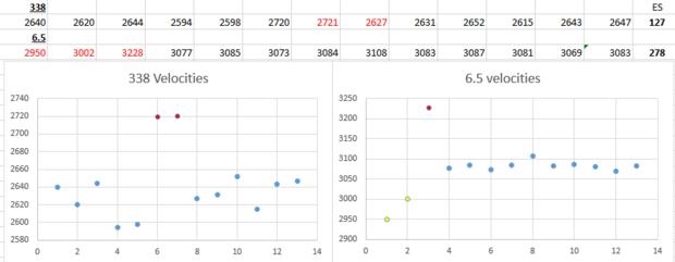

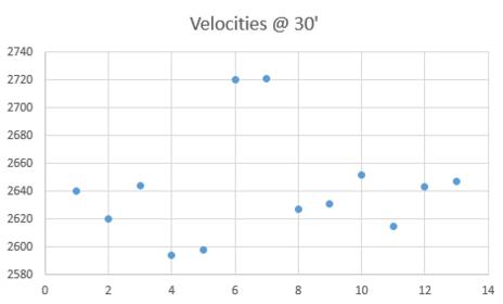

Thanks nso, I am seeing rather significant velocity swings in various calibers (old beta chrony), but I typically just exclude the major outliers from my spread and chalk it up due to reading errors (see attached image). On my 6.5, I am seeing exact matches at both distances with the actual velocity readings I'm getting, so I think its right most of the time and just throws out occasional erroneous readings. It does tend to do this more early morning or late evening, so I try to shoot with good, but not too bright lighting when possible. vel. comp.jpg
