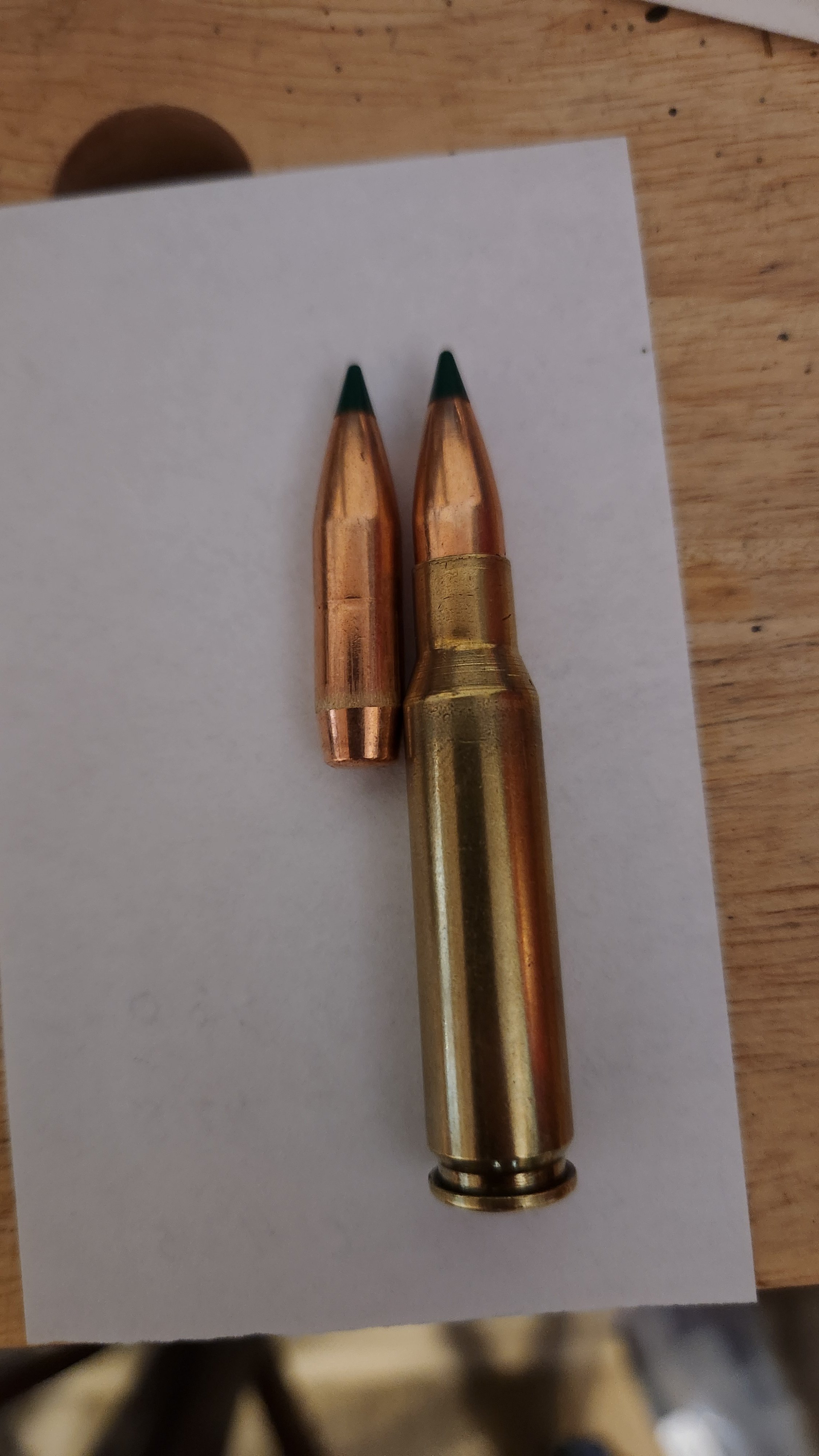

I have never encountered this issue before, in 30+ years of reloading.
I recently purchased 1000 of the .308, 180 grain tipped gamekings.
I went to load some ladders today and discovered that no matter what length I seat them at, they will not chamber in any of my 308s. They also will not chamber in my gauge. Yet, when I pulled the projectile, the brass will chamber cleanly!
I measured the diameter of the projectiles and they are .308 so thats not an issue.
I am using Alpha brass, I tried Fed brass as well.
I tried different levels of crimp as well, that did not help. I also tried partially seating the projectile and then chambering the round to finish seating. No luck. I am completely perplexed.
Thoughts?
My only possible thought is that its the shape of the projectile (see pic)
180 tgk next to 195 tmk (which chambers easily)
Ran into the same problem with Berger 185 Classic Hunter w/ SP10. I kept seating deeper and deeper than when I’ve loaded them once before. Bolt would jam them into the lands. The weirdest thing ever. All other Berger 185’s are fine.
Doubly odd I’ve shot these before but assume I was just cramming into the lands and didn’t check the chambering. I did record “mild + pressure signs” with only 41.3 of Varget so that’s possibly the deal.
Ok so after a lot tinkering I have to make the OAL 2.778" for them to feed in the rifle I was loading for (TL3). That is WAY too short in my opinion. The bullet is interfering with the amount of powder. Really disappointed.
Yeah, my understanding is that the particular bullet you are using is made for the 300 win mag, so you can get close to the lands and the round will still fit in the mag. I was considering trying them in my short action 300 WSM where I have to seat almost every bullet at least .07 off for the round to fit the mag, but I was concerned they would not hold up on elk well. Still messing with 200 Accubonds and 210 ABLR’s trying to get them to shoot when seated .08 to .1 off. If only it was bonded, it would be the perfect set up for my gun.
