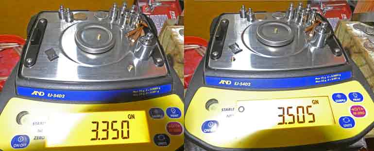

    What effect does primer weight have on performance?

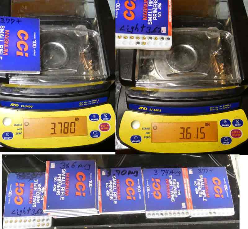

    Here are some weights of CCI450 primers.
    Granted there were only 2 really heavy ones out of 1000, a few more light ones, but MOST had very consistent weights.
    Averages (per 100) were done by taring a plastic carrier, and flipping 100 sorted primers into the tared carrier.
    I know sorting 1000 primers is anal/OCD but if it does matter how would you find the outliers otherwise?

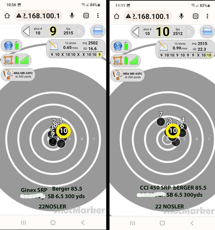

    Before I sorted the CCI450 (just assumed they were better) I did a quick test of the Ginex against the CCI450 @ 300 yards.
