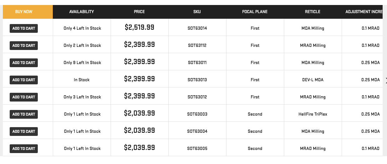

Leupold and Sig Optics are two of the worst offenders. Utterly useless websites. Sig can't even seem to figure out what specs go with what scope. See below.

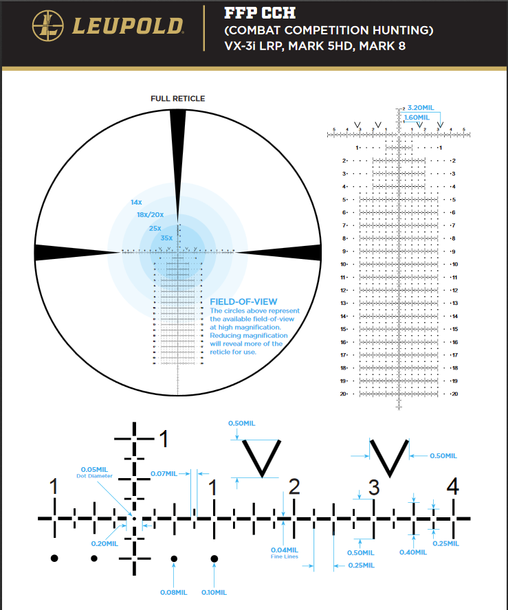

Forgive me for raising a dead thread, but in case anyone else googles CCH reticle and comes across this thread, I wanted to add that they may not have had it up in 2018, but is certainly on their site now. But, I don't disagree that their site leaves much to be desired....e.g. look for a torque spec on Mark IV rings....the ring screws, not the pic attachment. Yeah...its in the doc with the rings but nowhere on their site to this day.

It's funny that you guys are bagging on Leupy, because I think the king of "great scopes, terrible website" is Sig. Like half their information up there is from their gen 1 scopes, and I don't even remember seeing a subtension document for the gen2 or 6T scopes.
