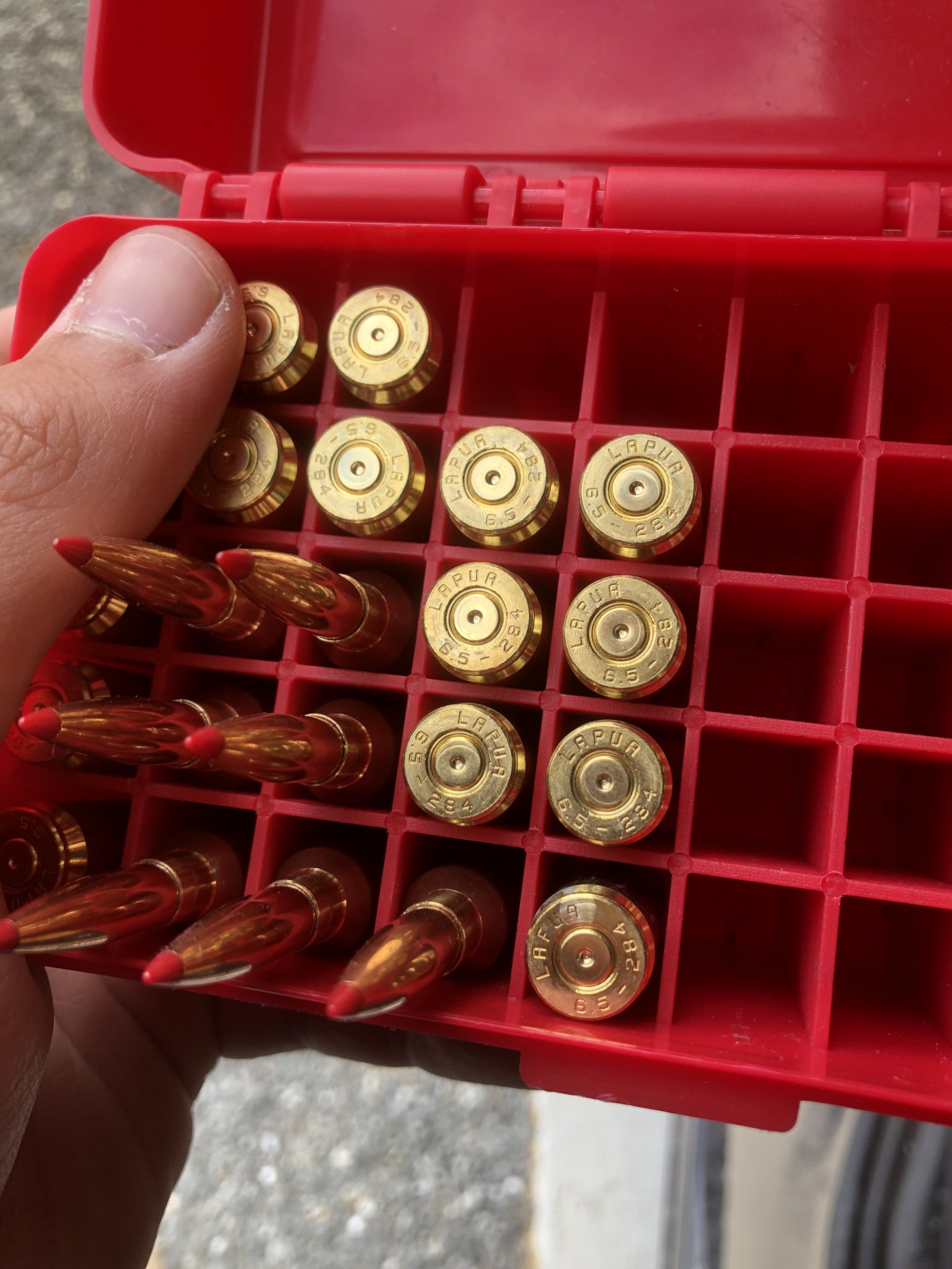

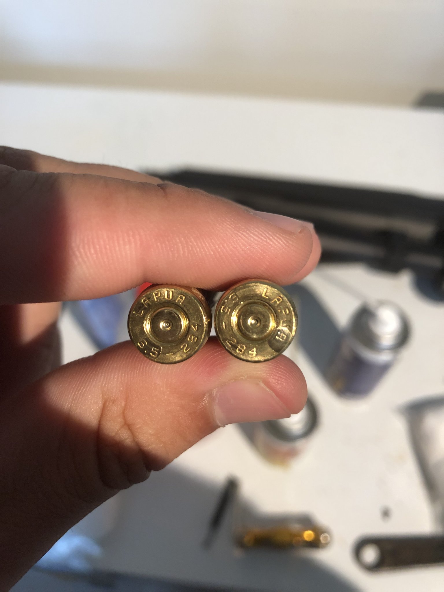

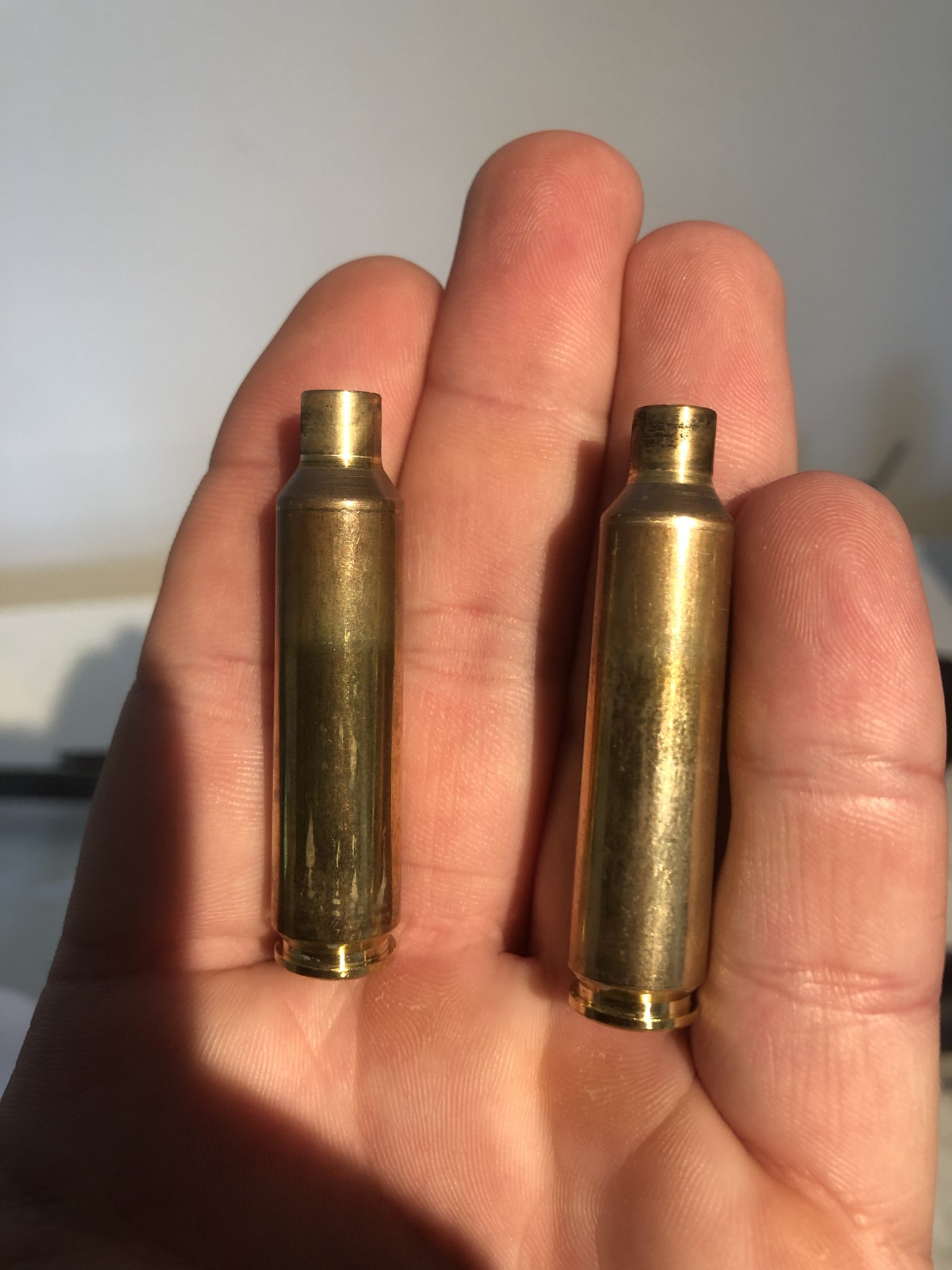

About 500 rounds, but the issue has been there since about 30-40 rounds i think, but not as bad as now.
Today i went out again, the brass is new, only neck turned and controlled length. Load is 47gr N160 and 0,5mm from the lands.
I shot 9 or maybe 10 shots before without any signs of pressure, everything seemed nice. I waited for about 3-4 minutes for the barrel and silencer to cool down. The first shot after cool down gave massive over pressure. This is the same issue as always, the first shot after a small "cool down" gives massive over pressure. Before these ten shots i have given it a massive scrub with all kinds of chemicals and nylon/bronze brush.
WHAT THE F... is going on..
At the picture its todays shots. Down on the right is overpressure round.
If the right pic above is fired brass, you do not have any carbon anywhere on the necks. That tells me, either your brass needs trimmed, or you have a serious carbon ring at the end of the neck in your chamber. Case mouths are getting choked off.
If your brass is not too long, get a 7mm or 30 cal brush, either chuck a rod up in a drill or work that area of your chamber over by hand with a good carbon cutting solvent.
From the Retumbo rounds i get serious carbon layer on the necks.
Can it be the carbon ring gets harder when the barrel gets a few minutes to cool down? And this actually is a carbon ring issue.?
This rifle is a few days from beeing throwed in the ocean, or maybe melted into nails..
Ok, could be your retumbo loads not generating the pressure the other powder does, so carbon on the necks, but also, incomplete burns a big factor in carbon ring formation, more powder, cleaner burn.
But still, the cases in the pic do not look like any carbon present, need as much as faint line at least. I'd clean where I said to, maybe trim .008" of the brass, do one at a time and let's figure this out.

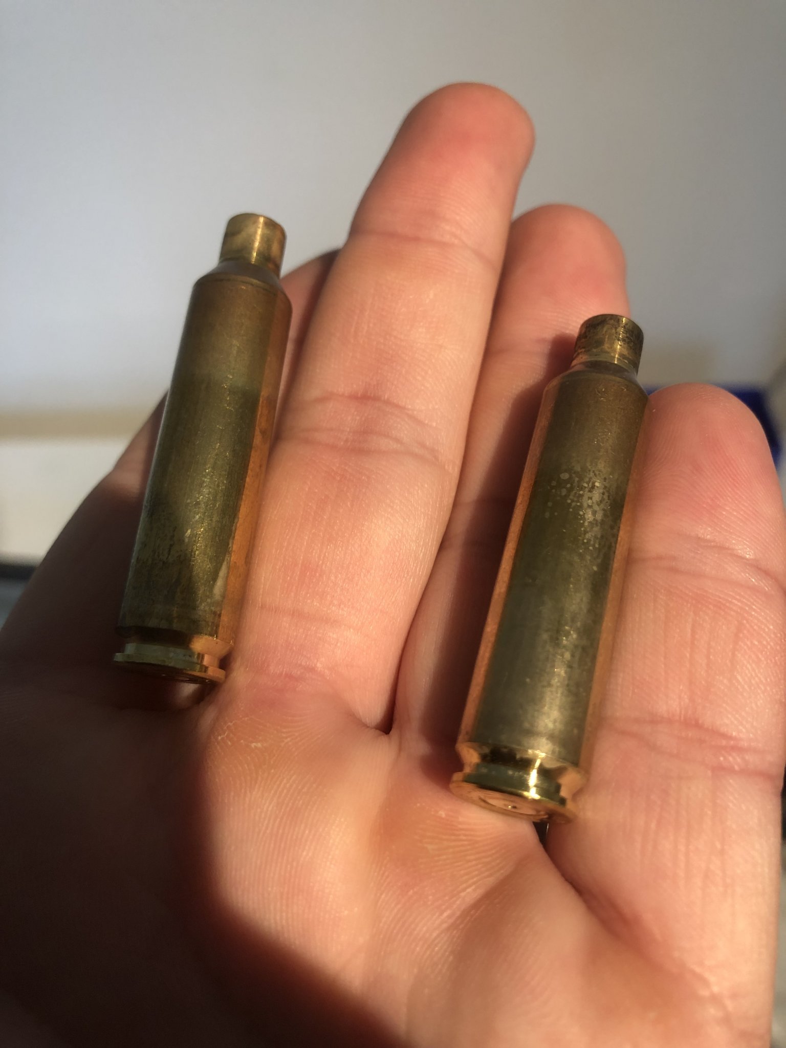

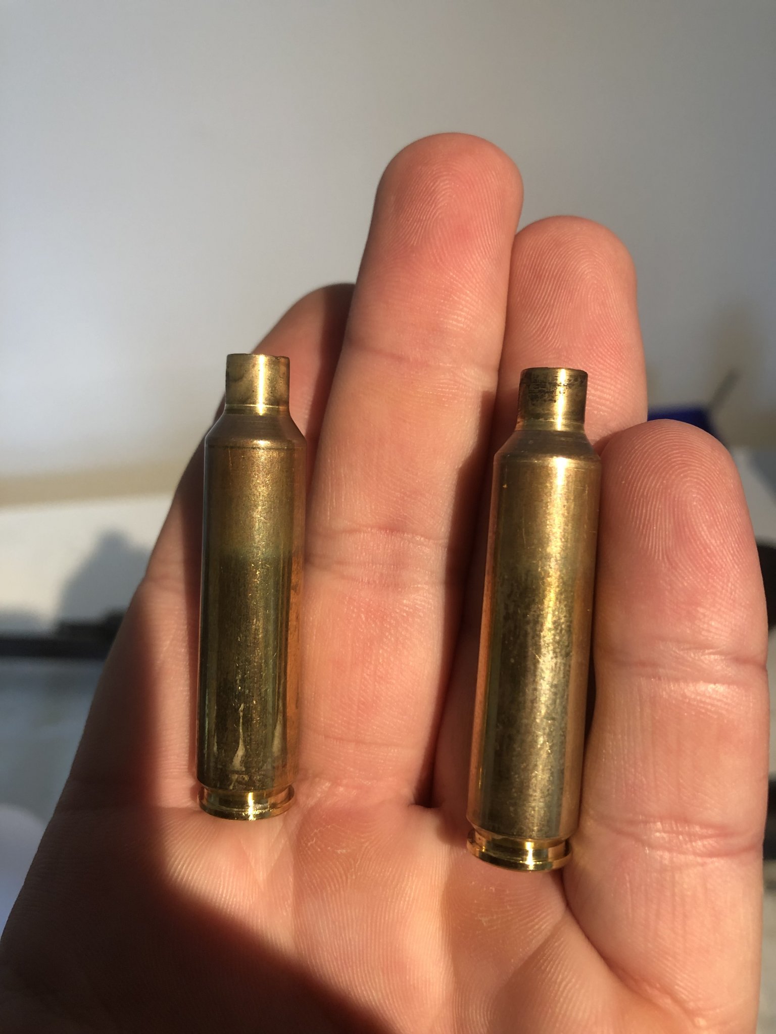

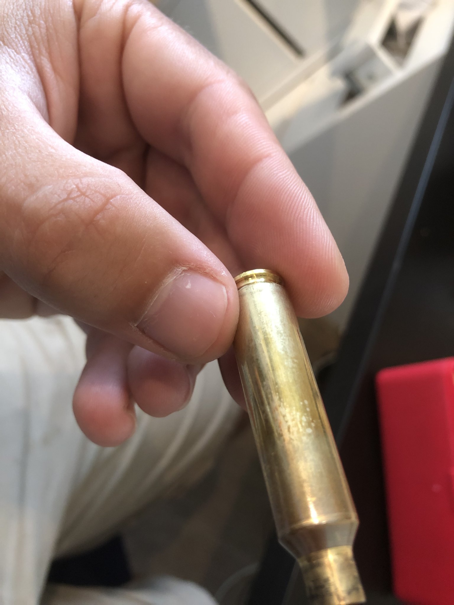

Attached some more pictures of the overpressured cases. not carbon back blow, but there is something on the cases. I always use red etanol to clean the chamber after scrubbing the barrel. But it can be some oil left in the lug area..
The same also happens with 54gr. At 54,5gr the speed is 826 m/s. At 57.5gr the speed is 886m/s. The barrel is 23 ". I see the Retumbo is burning i bit dirty.
Those primers are not showing dangerous pressure . It could be the Krieger barrel . Scrub hell out of the chamber and the bore . Velocity does not seem to indicate dangerous pressure either . Polish up the chamber . The marks on the case look like a possible rough chamber that is causing hard bolt lift and extraction . Then run it with 54 grains for a while .

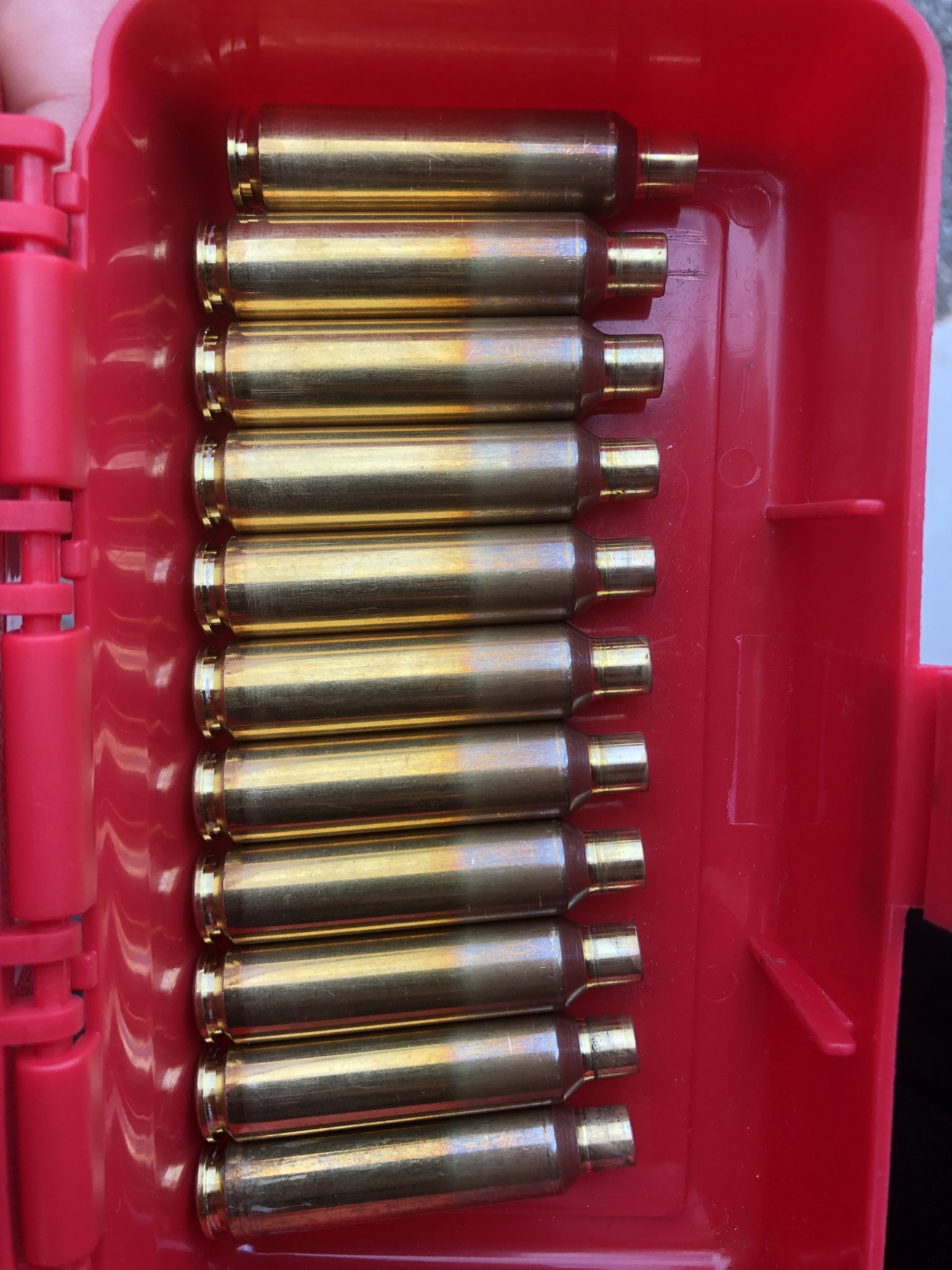

Well now i have got some new expirience.
I used to clean this rifle like all my others, including my comp rifles in 6,5 swede, which i shoot 4-5000 shots with a year.
Well it seems it hasn`t been good enough. It has now gotten what i call a judgementdaycleaning. About 5 days soaked with different chemicals, brushed like f... each day and polished 4 times with gold medallion.
Today i shot 35 shots with no problems. Same brass, same load, same bullet, with silencer.
5x5 shots at 430 meters - 480 yards.
Todays best group, and the worst.. Looks like that Krieger barrel is ready for hunting
