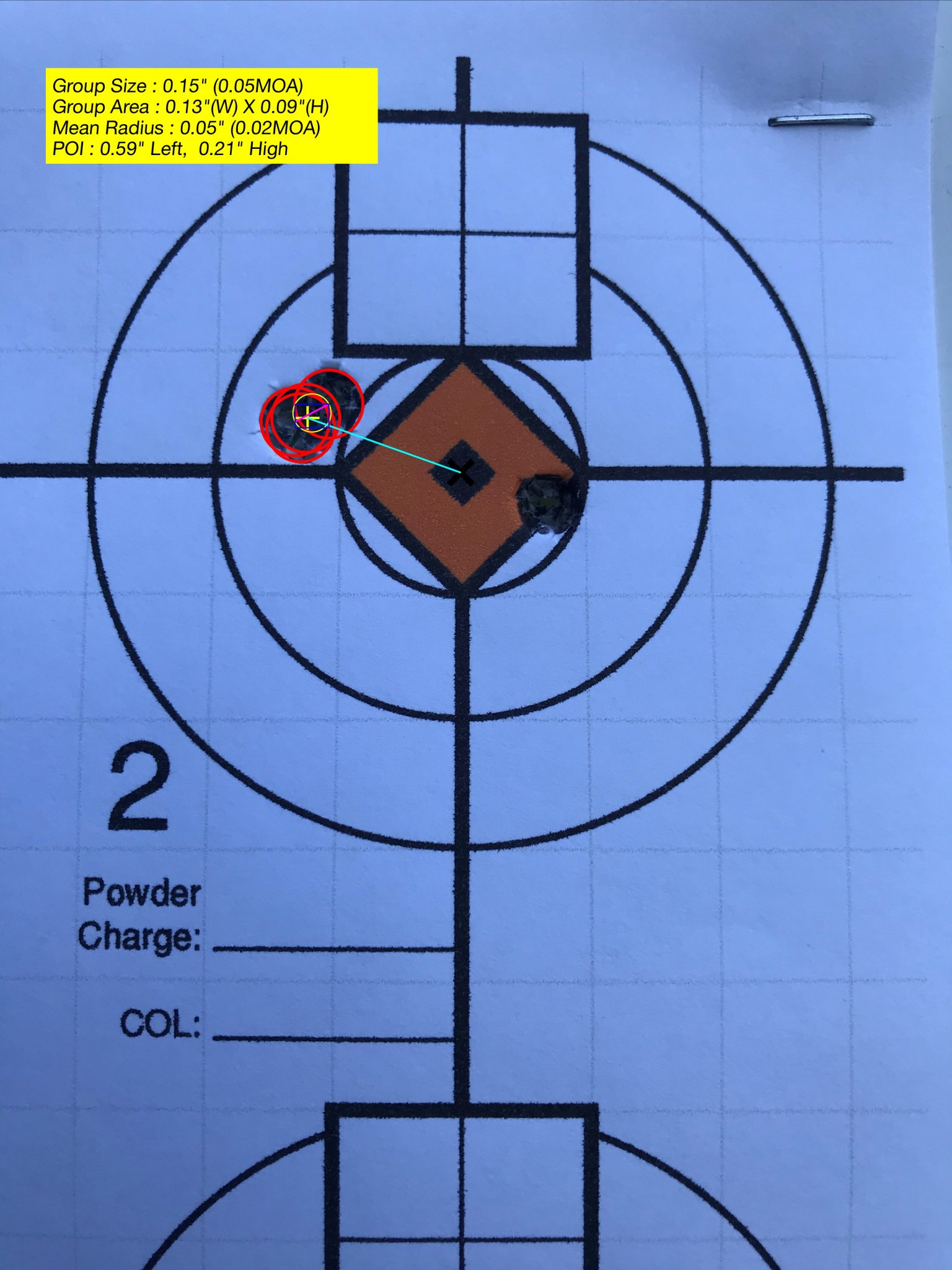

I know, I know, it's dangerous to trust a bore scope. I get it. I bought a Teslong recently, and decided to see if I could get some insight on a problem I've had with a barrel since it was new. I'm not sure what to make of the resulting video, so posting here to see if y'all have any (useful) thoughts.
These are both 6.5 barrels from a well known, well respected maker. The first (in "part 1") was my first 6.5 CM barrel. It's old (2400 rounds), but still shoots sub-1/2 MOA with basically bullet I feed it after load development. Aside from being a little slow, I'm still very happy with this barrel. There are some more notes in the YouTube video summary. To me, this one looks clean, with just the firecracking you'd expect from a barrel of that age.

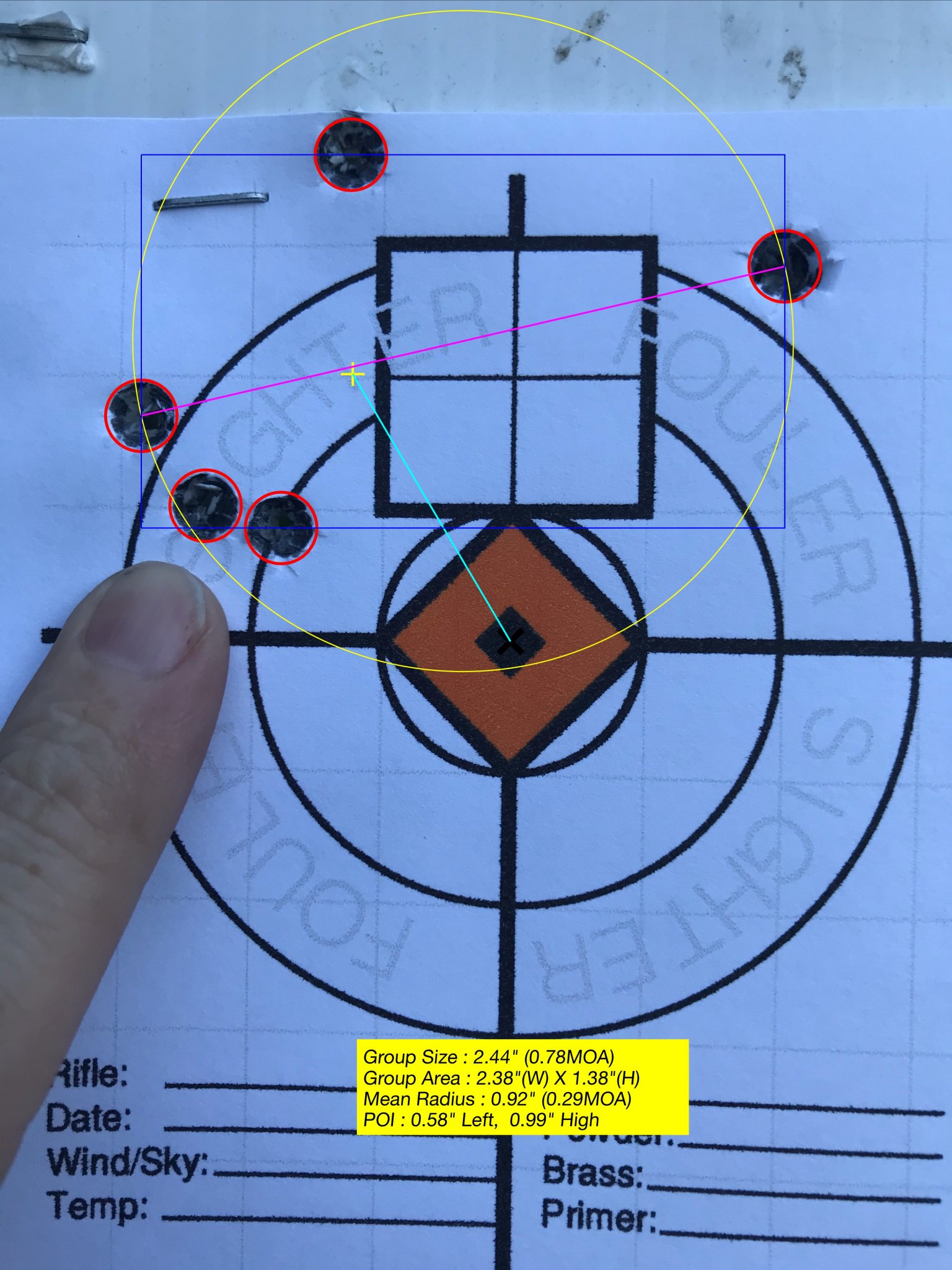

The second (in "part 2") is my problem child. My second 6.5 CM barrel. Same barrel maker. It has about 700 rounds on it, and most of that was spent trying to find something that would shoot in it. The absolute best I could get with 140gr ELD-M or Hybrids was 3/4 MOA, and that wasn't super consistent (I'd occasionally have flyers). With 140 RDF (which served me very well in the first barrel), this barrel won't even shoot sub-MOA. I finally tried 147gr ELD-Ms in it, and found something that would shoot better than 1/2 MOA. Again, more notes in the YT video.
The second barrel looks wild, to me. It's hard to follow a groove with the scope, and the grooves look really odd vs. the first barrel. Odd, like groove walls appear to look wavy, at times, and show other weird tooling marks (like longitudinal marks that look like scratches down the center of the groove). Like I mentioned in the vid, I've looked down this barrel several times, and always see something else weird. I had trouble finding the spot today, but one of the grooves has what looks like a big fissure in the middle of it, about 1/3 of the way down the barrel (IIRC).
Like I said above, I'm not sure what to make of this. I'm open to ideas. I'm doubting I'll buy another barrel from this maker in the future, after this, unless I'm just way off base and this is normal? I'm just glad I got it to shoot with something so I can get some lifetime out of it.

Question I have is, what makes you "zero in" on the barrel itself- rather than all of the other variables that could contribute to relative "inaccuracy"?
Who did the chambering (you, or a smith)? Have you ruled out any issues of concentricity with the chamber?
Stock/chassis: confirmed stress-free (bedded or not) fitment of action?
Just sayin' that for me, the borescope might be among the last tools to break out and only after I'd ruled out what to me, would be more obvious suspects.

Barreled was chambered by the same smith that did the first, with the same reamer. The smith is top shelf - they’re not the problem.
I triple checked all the variables, including, but not limited to torque on action, scope rail, scope rings, barrel, etc. I put the first barrel back on, and double checked that it still shot (it did). I tried Hornady factory 140 ELD-M. I pulled the brake off. I had someone else shoot it with no knowledge about what ammo was being shot.
I tried putting the action into an MPA chassis. The original stock (T-4A) was bedded when the rifle was first built. It would be a super rare case where the stock would cause a problem with one barrel and not the other.
So, in that 700 rounds, I eliminated a lot of variables before deciding it was likely the tube. I probably went too far - the only thing that changed was the barrel, but I checked the rest anyway, just to be sure.
Send those videos to the shop that supplied them, see what they say. I'm sure they'd want to know if one of their tools wasn't cutting it... No pun intended.
Agree #2 looks funky compared to #1. No expert here though.
Reactions: davere
I give every barrel a quick scope before I install it. Number 2 does not look right. I'd pull the barrel, call the manufacturer send it back to have them look at it. Give them a chance to fix it if its wrong.

I’m very happy with this rifle that I’ve build for myself, and the load I put together for it.
I couldn’t have done it without the wealth of knowledge on here, and in general. I learn very well from reading, and have a very mechanical mind in general where I can think critically of an idea that doesn’t make sense at all, and the ones that do, but shooting that group, I can’t help but feel the stars were aligned there. I don’t know that it’s going to be repeatable. I’m still learning how to shoot.
Second image, where my finger is are the first 3 shots down the barrel that night. Then, WTH?! I’m okay with saying they were me, but am I 100% sure they were? No. I guess that’s all part of the fun and learning process.
